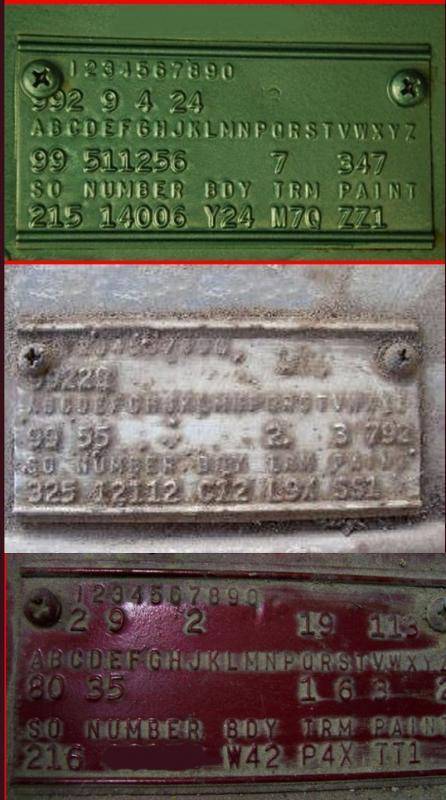

The tag reads "99" under AB, then "351" under DEF, "882" under NPQ, "3" under V & "791" under XYZ. why would it be a 99, not 80 for 426? 99= standard cid engine 8 cyl.
Body is D42, trim is P4X and paint is BB1 (black).

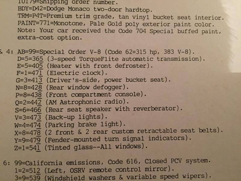

When I sent my info out years ago for my 383 car I received a breakdown of the data plate. AB was 99 and the way it was listed was AB=99=Special Order V8 (Code 62=315 hp, 383 V8). Now I do not claim to be an expert but to me that means a 383 car. Unless the window sticker says otherwise. Curious as to why the VIN is missing. The motor that you are describing sounds very much like it is a 426. You will need to check the ID pad on the block. But the question is......was it born with that motor or did an engine swap happen somewhere along the line? I will try to post a pic of my data plate breakdown.
Special order cars were a 91 code. Wonder why a 383 car would have a 99, not 62. Did the 383's have chrome valve covers? My 65 fury didn't, just turquoise. I can't wait to get under this thing to see the castings- not to mention if he pulls out the window sticker. Then it's game on. Regardless, I think it's a cool car with plenty of potential.
Why would a 383-4 be an AB99 Special Order?
Not 100% sure but as you can see that is what mine was and you can see where that translates to Code 62 which is a 383. My 383 car is originally from California and has the emissions package so that may be the reason? I have seen several Code 99's and they have all been 383's.
The 99 only refers to the engine not the car. Read the breakdown on mine ....he states that Code 99 = Code 62. There well may be a 426 residing between the wheel wells right now, but unless the window sticker says otherwise it may just be a 383 car (engine transplant at some time). And if the window sticker has a VIN who knows if it is for that car if the VIN tag is missing?

99 simply means 'Standard engine' or whatever was standard for that particular model. (unless, of course, a '65 Imperial or Chrysler came standard with a 426 SW)
The engine code for a 426 SW is 80
So more than likely this is a 383 car (with 4 barrel) as this was standard engine for a '65 Monaco, if I am to assume?
