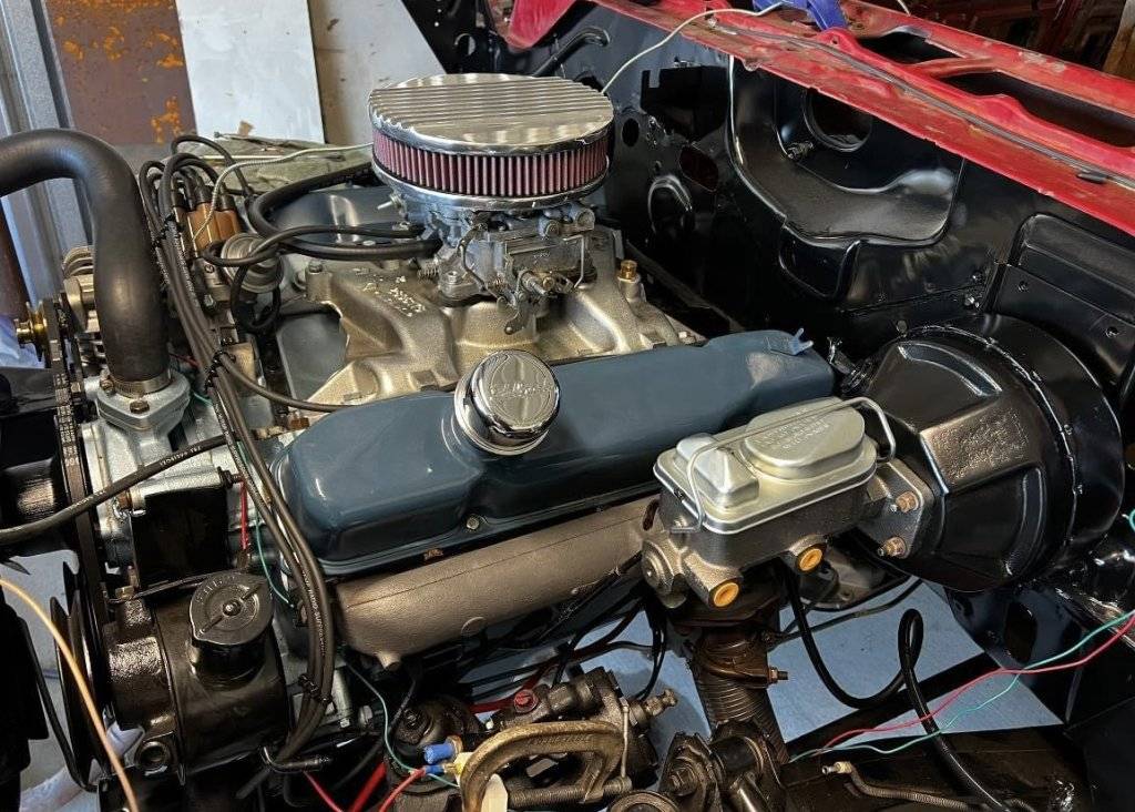

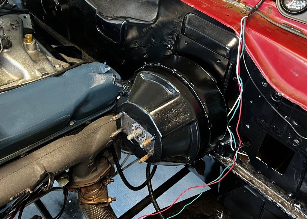

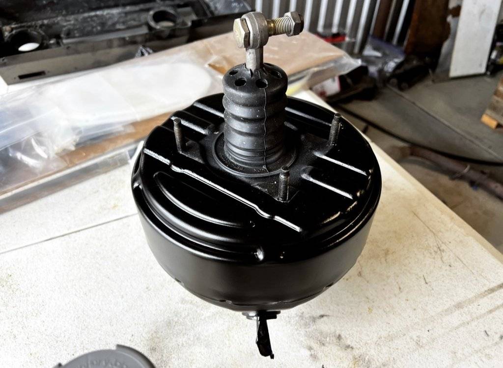

New to me brake booster rebuilt by Booster Dewey! I repainted it to match the look of the rest of my engine compartment components. The car has C Body discs from a 72 Fury and now I need to get them all plumbed up.
Yes I know the dip stick needs to be moved (I moved it after I took this pic.) Got a new MC and I clear coated it to prevent rust from happening. What I’m unsure of, is - how do I know how long the push rod should be? I am really unsure of this and figured I’d ask the pros on what I should look for and how to properly measure this so the brakes work at their best potential! I appreciate the help and advice as always.
Here is a link to proper measurement process.
A general rule of thumb for Mopar brakes (if one doesn't have the gauge suggested by @Big_John), is to adjust the push rod so it holds the master cylinder away from its mounting surface and that of the booster 1/16th of an inch when placing the master on the 4 booster studs by hand. Bolt it down after that.
Apparently what this does is preload the hydraulic system of the brakes properly.
This method has worked perfectly for me on all Mopar boosters I've used.
