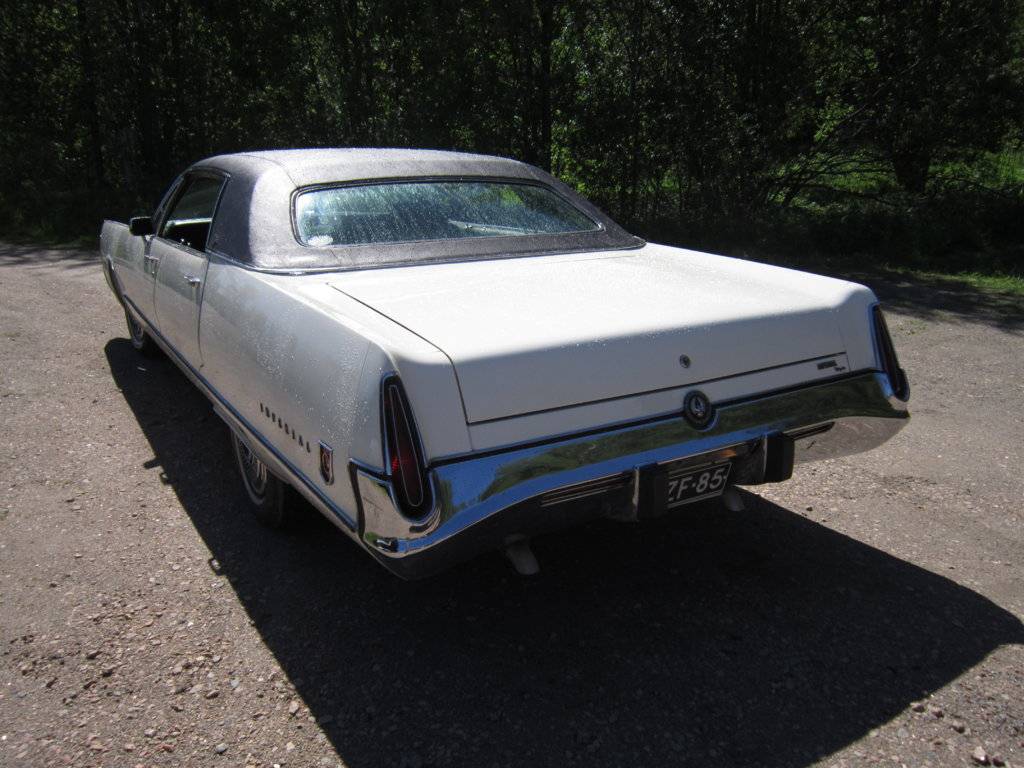

Impster - the big&white

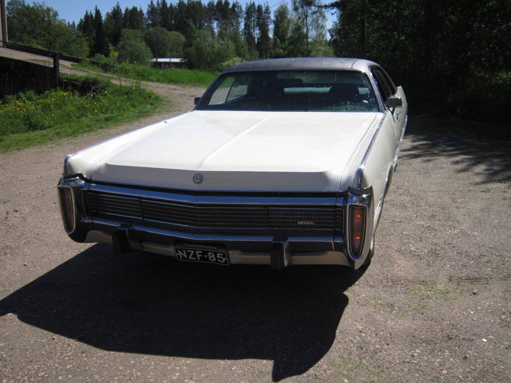

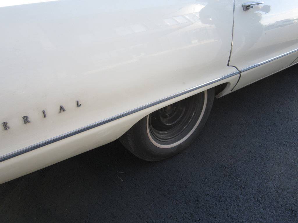

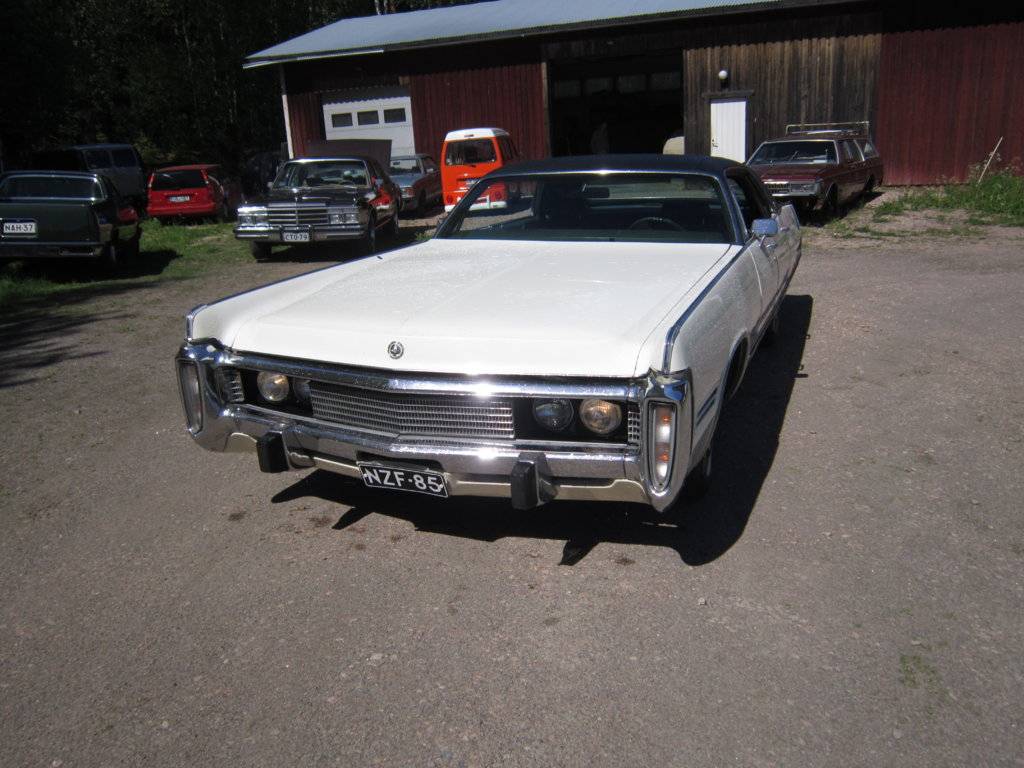

those reflection pics are the money shot for me...I love seeing panels that have avoided shopping carts for so many years.

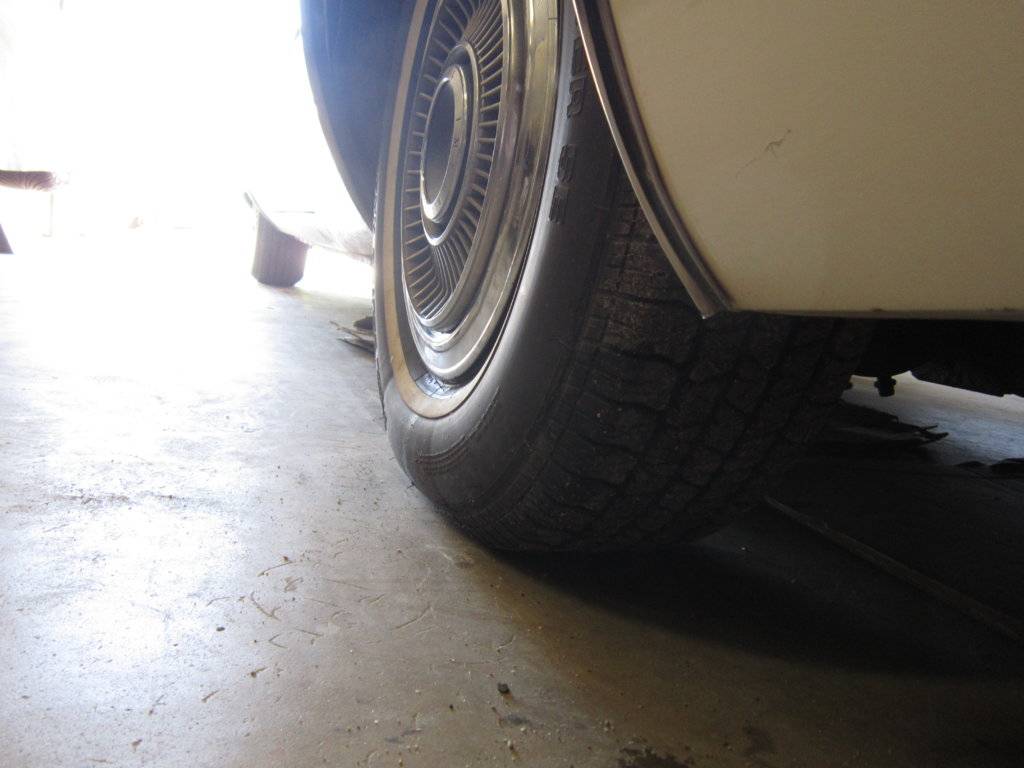

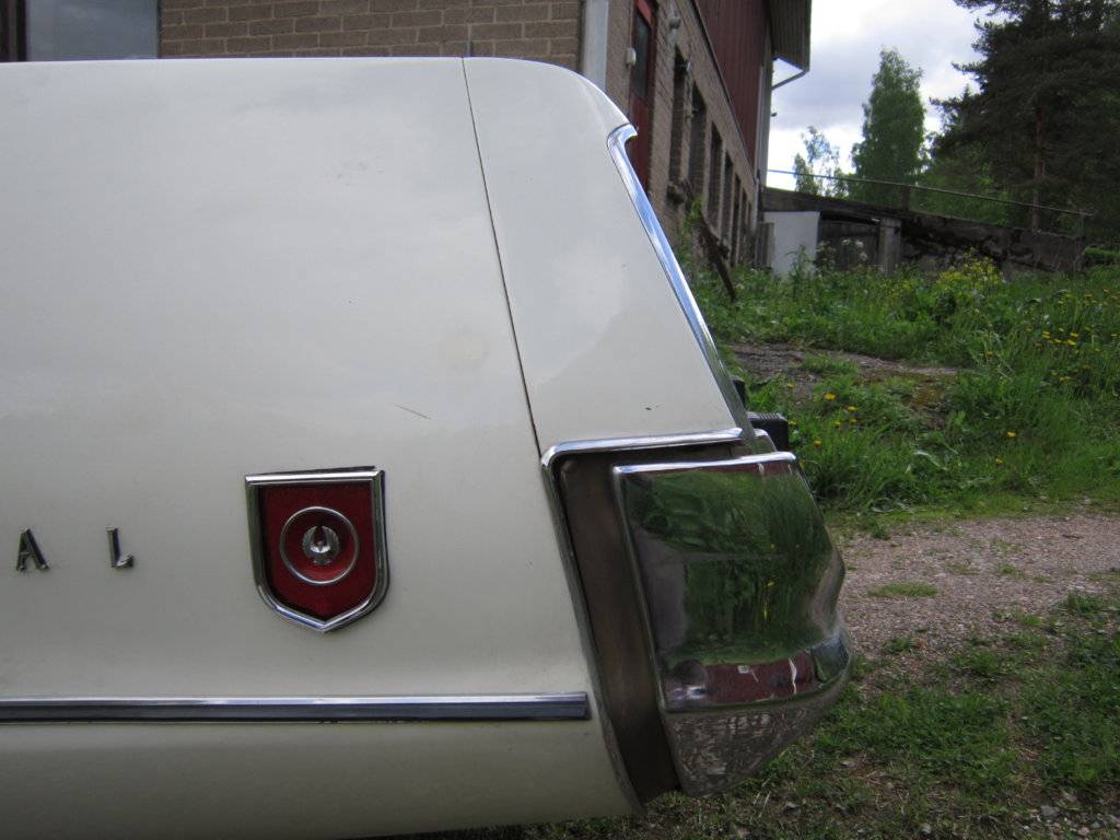

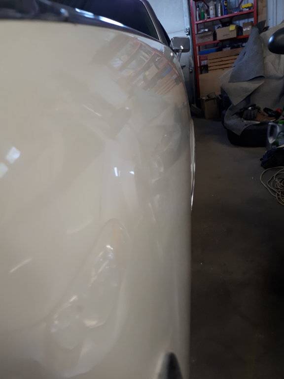

There actually is one dent on the passenger´s side rear door, right under the handle.
Gents, please ignore the moisture. That pic is taken at the first stop of 13th Big West Newland cruise.

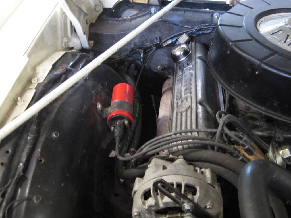

Before getting Impster out, I did try to start her quite many times. Then our friend came up with a timing light to check spark. The distributor was not distributing anything because the coil lead was off due to that I had to make extra space to tighten the rearmost exhaust manifold bolt on the passenger´s side last Sunday. :BangHead:
After reinstalling that, the 440 did fire right up.:D

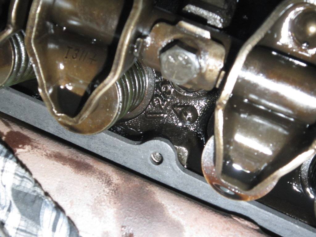

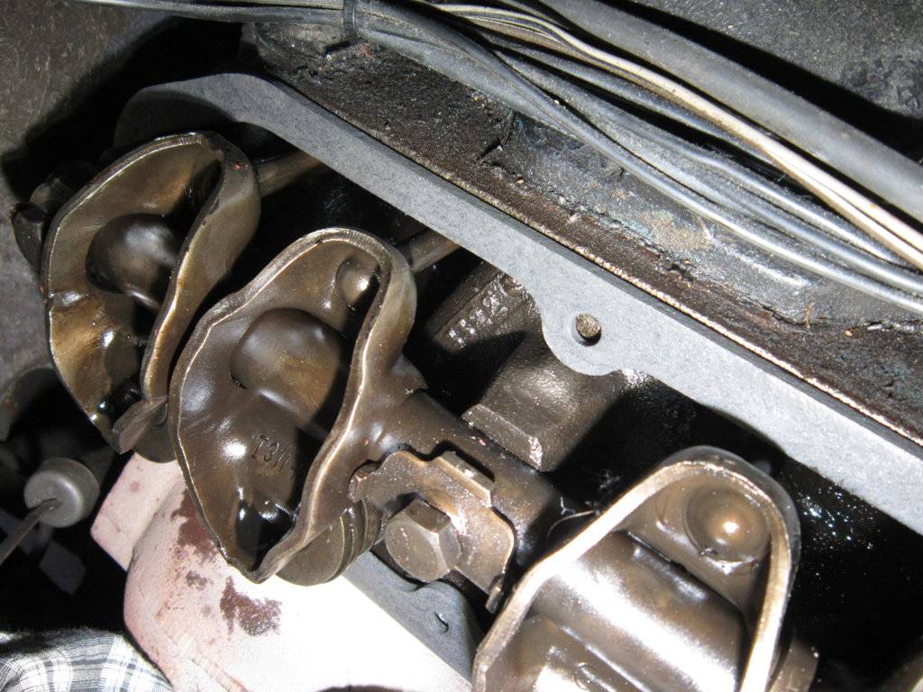

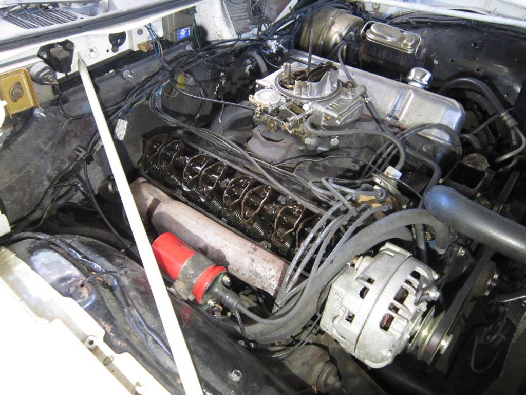

I also took the right valve cover off to check the valve train because every now and then it makes a ticking noise. The reason for that is the rockers are able to move a bit on the longitudinal axis of the rocker shaft when the valve springs are not much compressed. I´m on the way to get the FSM in my hands...

I´ll hand this case over to the local shop (American Service) since they have more know-how than I or my dad. Today I tightened the rocker shaft properly, which did cure the rocker arm slack, but there´s some other noise and the device to measure the oil pressure is yet on my bucket list.

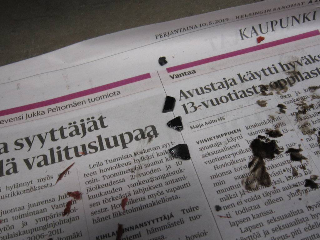

Those pieces of plastic pictured above were removed from under the valve cover.

@MarPar There´s this much of space between the coil and log.

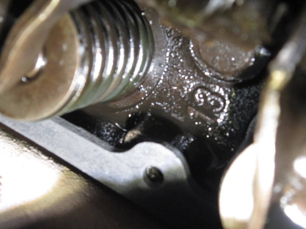

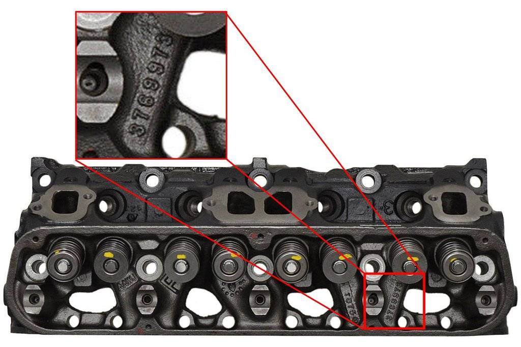

Who´s got knowledge about head numbers?
13
23
3322
I bet that the ``3322`` is the end of a casting number, but I can´t find a full code on the Internet and therefore the original engine/vehicle combination.
You are looking at the wrong numbers.

Plastic is pieces of the valve seals. Typical old Mopar. They harden and break apart. You might see a little smoke from the exhaust when it first starts, but not a big deal. Most of the old ones are running around like that.
From the description on your other thread, it sounds like lifter noise... It happens, especially if the car doesn't get driven a lot. It may quiet down when you get some miles and an oil change under its belt.
The Chevy 454 uses an orange silicone valve seal, as the OEM Chrysler B/RB seal is black. The Chevy seal is taller, so a little trimming to the same height as the OEM Chrysler seals is all that's needed.
It could be that the umbrella valve stem seals act similarly to the TF rear seal. As long as the inner bushing has little wear, the rear seal does not leak. But when the bushing wears, the rear seal will start to leak, as the bushing allows for more circular (a bigger "circle") as the drive shaft rotates. Similarly, as the valve guide wears, the valve seals will get a bigger hole and eventually crack with time, age, and heat cycles.
Also, one service manual I have mentions that worn valve guides can make a sound similar to "lifter noise". The FSM mentions a "wobble method" to check such clearance with a dial indicator. The best way to do it is to measure the guide ID and the worn valve stem OD for each valve/guide interface. Which means removing the head and disassembling it. I don't know that you're ready for that just yet?
The valve stem seals can be changed by pressurizing the cylinder with "shop air", to hold the valve closed as the spring is removed. Then new seals can be installed, the spring/'retainer/lock items can be reinstalled at that time. Without taking the cyl heads off of the block.
So, I'd say to get them to check the oil pressure, get an estimate on the valve stem seal replacements, and go from there. IF a compression check shows one cyl (usually #7 from my 383 experiences) has lower compression, then an exhaust valve might be starting to "burn", needing replacement in the future.

If that’s a ‘67 engine with its original heads they will a casting number that ends in either 516 or 915.
At least that model year is evident on a couple of old for sale ads and the intake manifold (2806178) has the same paint (the black on top and the turquoise under it) as the heads and the block, so I believe to that it is from the late 60s, though someone may have installed older parts to a newer block years ago. The performance speaks for that.
Any way, the lifters did stop making the noise after changing oil and making sure that there now is enough of oil. :BangHead::BangHead:

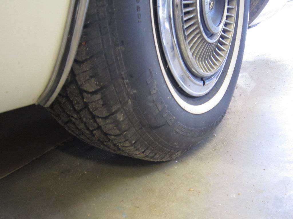

I added air into the front tires and cleaned the car a bit.

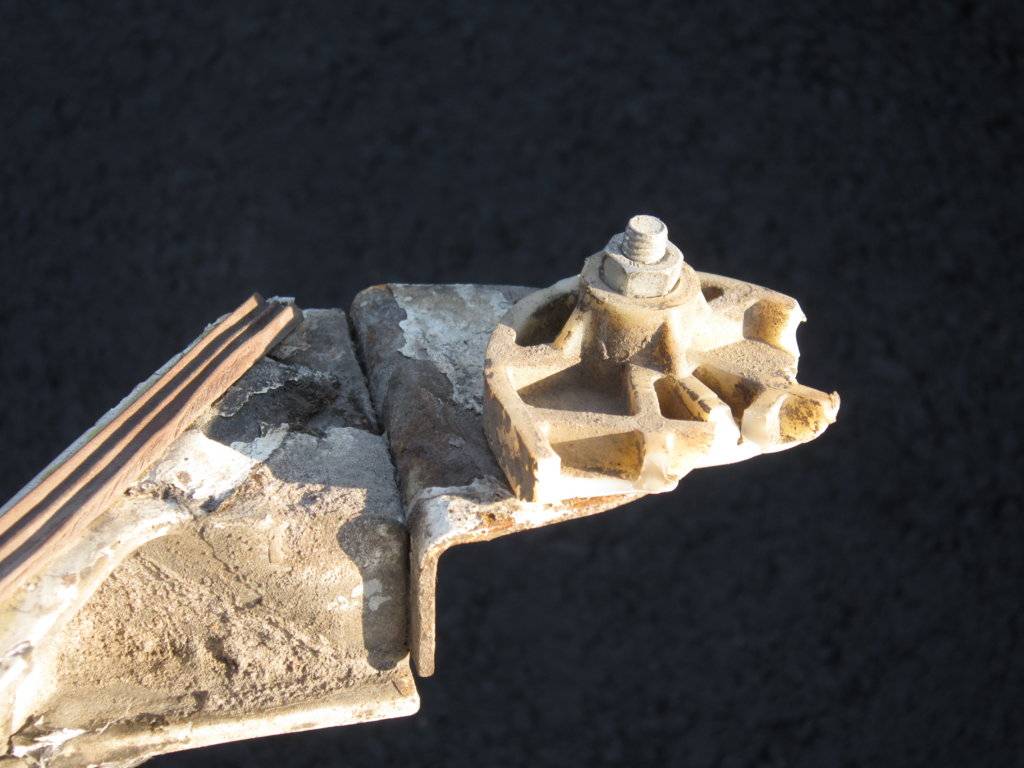

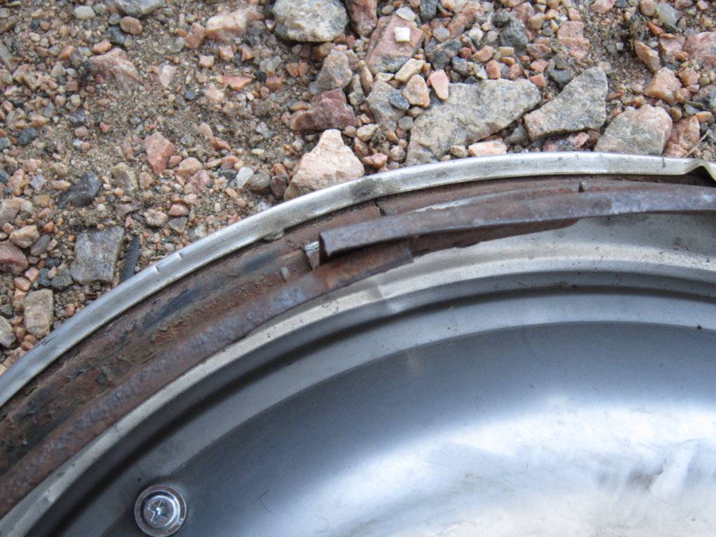

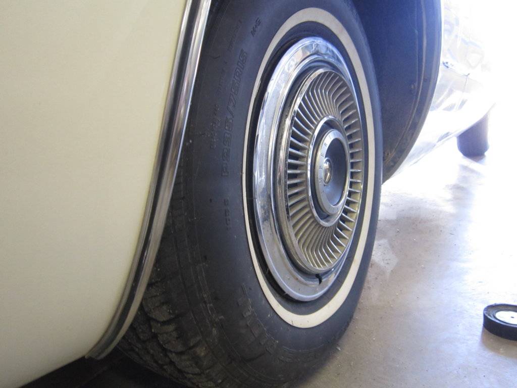

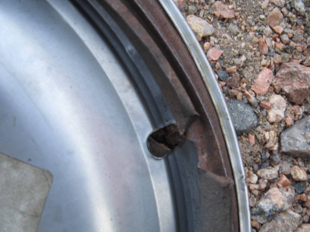

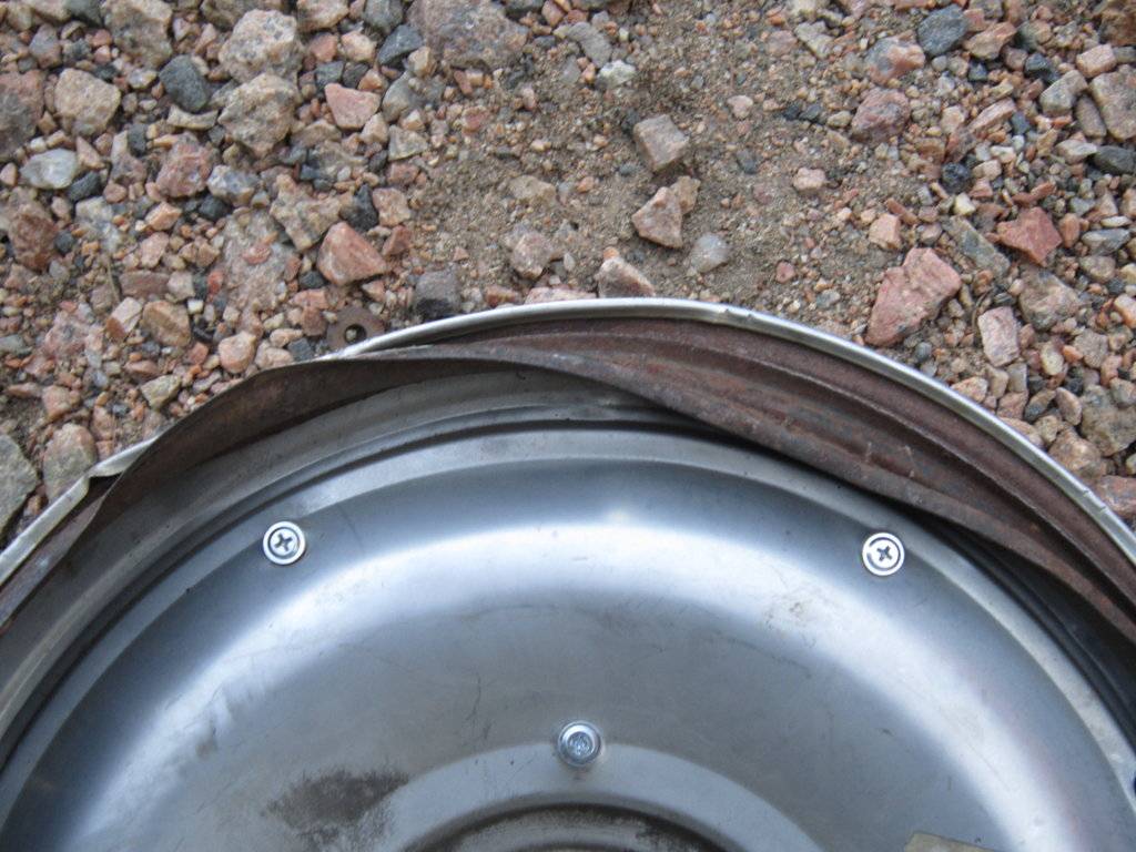

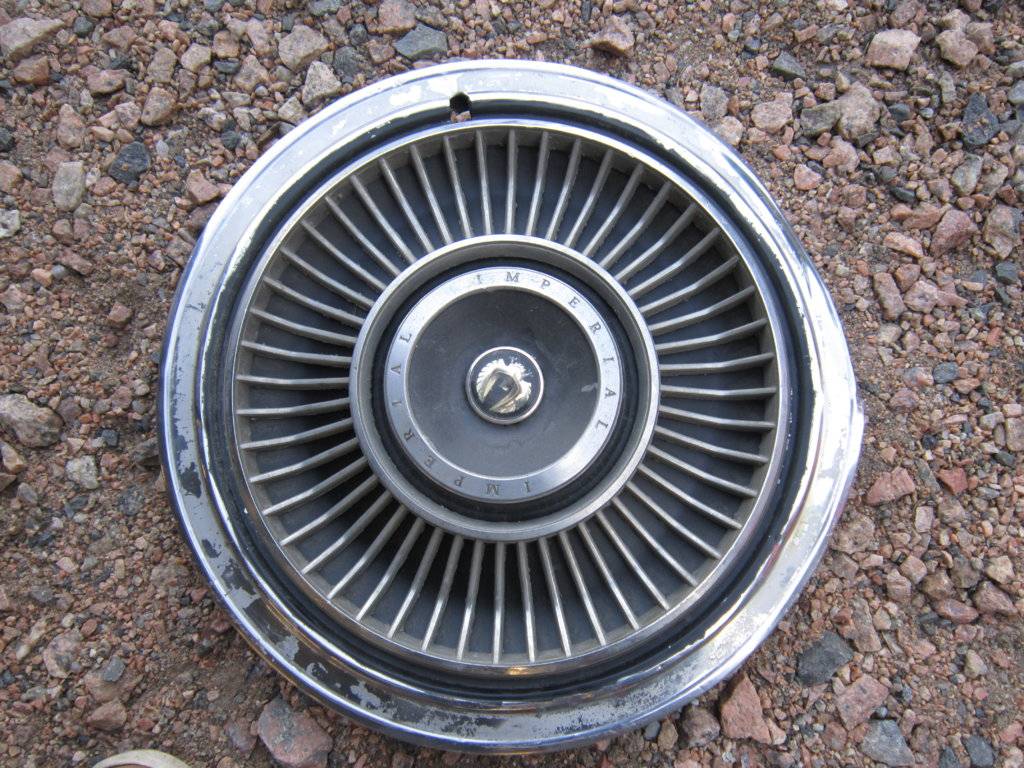

The RH side rear wheel cover did go free wheeling and it wiped the fender skirt to go with it. No other harm was caused other than that the car behind me hit the wheel cover after that did rebound from the curb and the fender skirt bracket did come off of the wheel well. Plus now a charging issue is evident.
