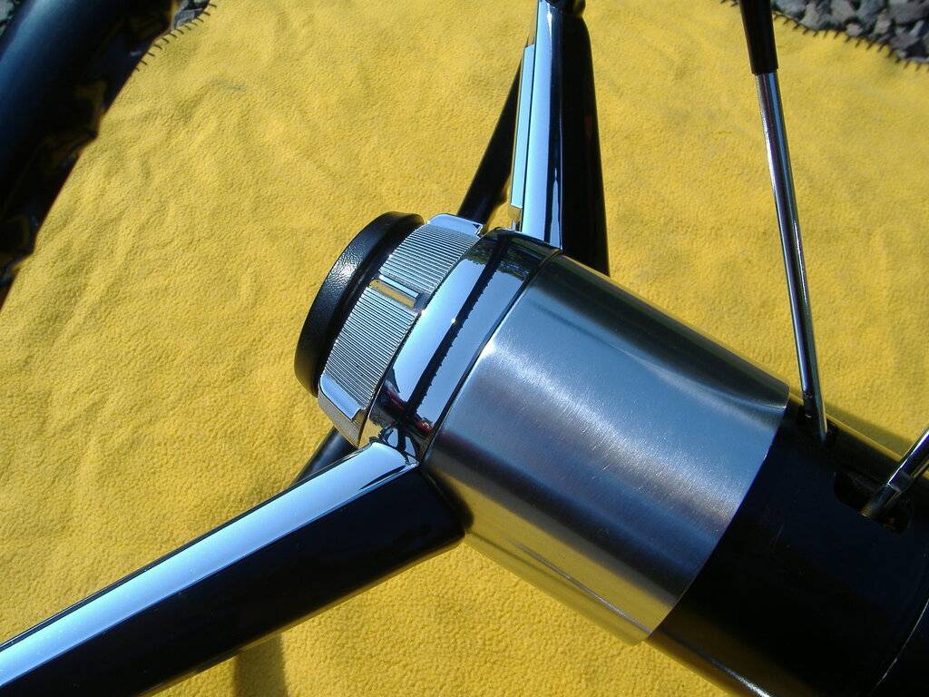

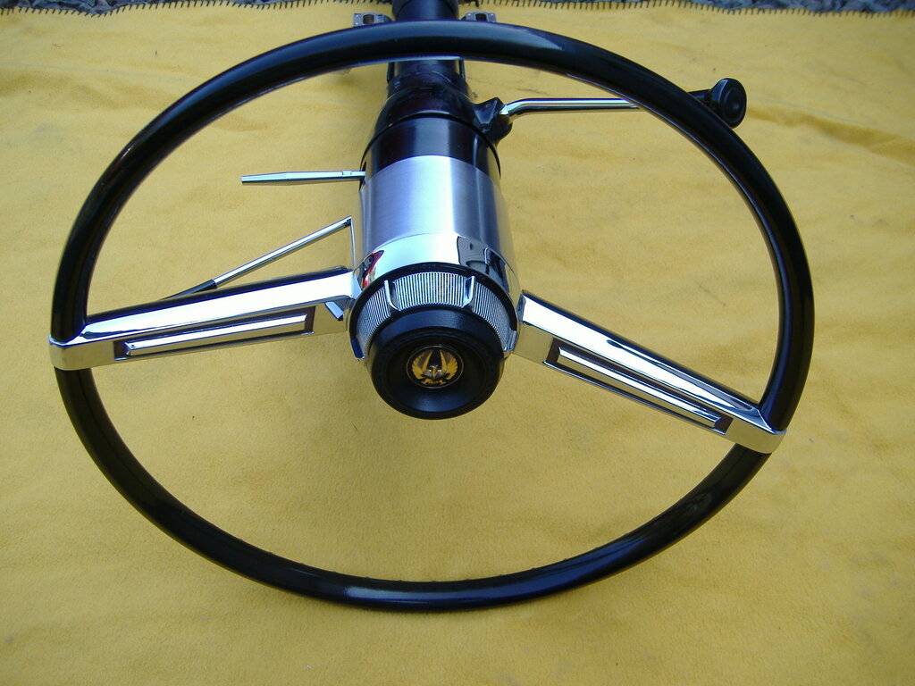

I probably sold the most beautiful tilt/telescopic wheel and column to ever be offered up in the history of ebay. It was a great transaction because I got a fistful of cash for something I didn't need, and I made a person who wanted a tilt/telescopic extremely happy. Got some great feedback on that deal.
The original car in question here is a '65, and I harbor no ill will towards 1965 tilt columns because they are tilt only and use the standard wheel. The problem with this one is that it's a one year only column, cable shift, one car only and has to come from a Chrysler. The gain would be so little for the time and expense required to make the swap. The only way I could justify it would be if the driver absolutely needed the tilt feature to operate the car comfortably, and not just as an added gimmick.
