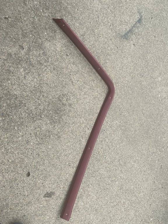

Hoping to ID this color. 66 Chrysler, tag code is L7R “red” but I think this might be “Aztec Red” or something. It’s the same as what’s on the dash. Not terrible, but has some rust and PO “stuff.” Anyone know the name and a source? Thank you!
PS This is the rear window trim.

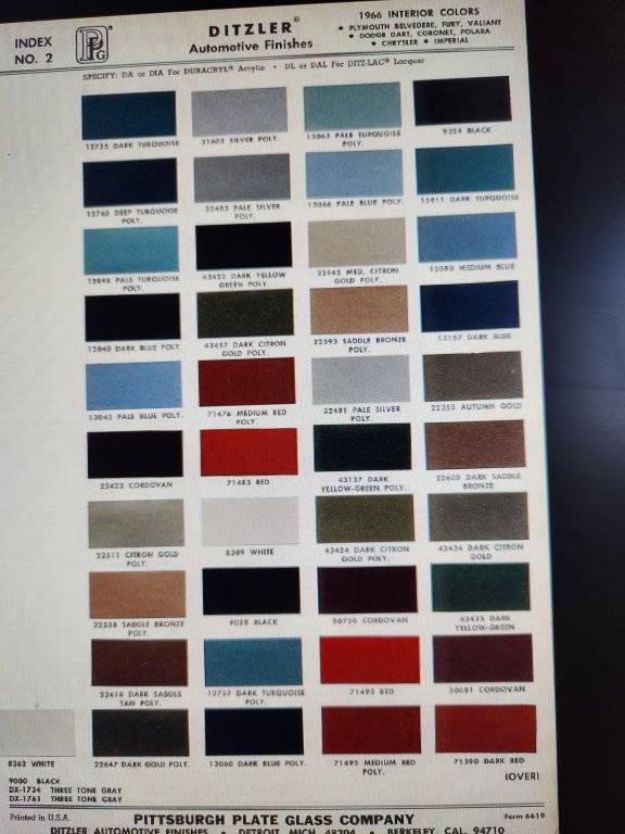

If you look in the body section of your FSM, there's a listing of interior and exterior paints with a Ditzler code.
One issue is the downloadable FSM from MyMopar is missing this section (many FSMs are missing complete sections on that site). There is a '66 Dodge FSM that isn't missing the section, and should be close.

Thanks to the tip from @Big_John i found the paint color in the 66 Dodge Coronet FSM. It’s Bolero Red Metallic in gloss and satin. Ditzler calls it Medium Red. Gonna check out Herbs Parts to see if they have it. Thanks all!

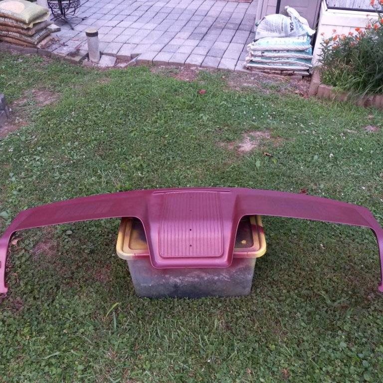

For what it is worth. I recently painted my rear package tray for my 65 Monaco with #1183. This appears to be close to what you currently have on the rear window trim.
Thank you. I emailed Herbs two weeks ago, but no reply. I wish I could figure it out. My interior is definitely more “wine” than “red.”
