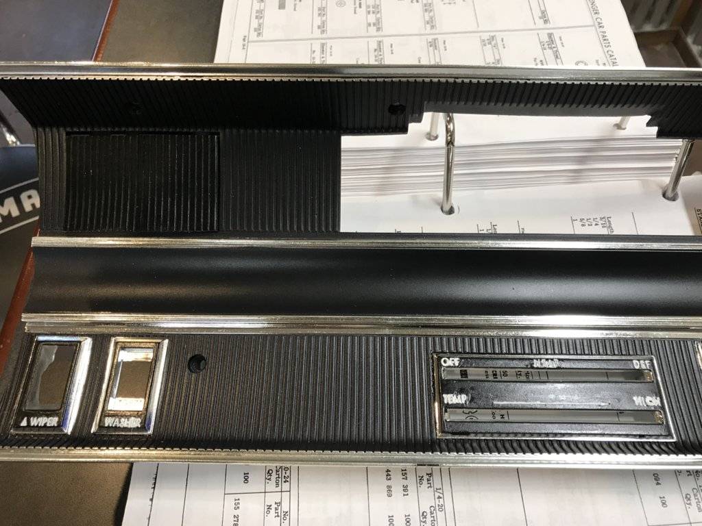

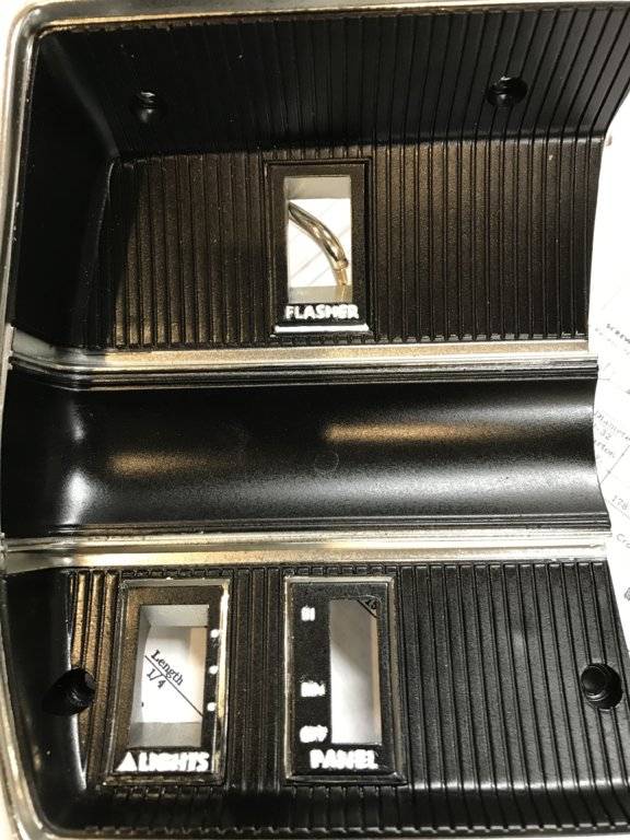

I had him re-chrome my plastic dash panels about 7 or 8 years ago. Decent job on the re-chrome but had to send them back as they chromed the whole middle section like a 67 and so they could finish the detailing for the control labels. The detailing for the control labels came back sloppy. I figured I could re do the detailing better myself.
They also lost the cover that goes over the radio fader hole. He attempted to make a new one out of old dash panel. I wasn’t real happy with the results. So I bought a NOS fader control an will put in rear speakers.

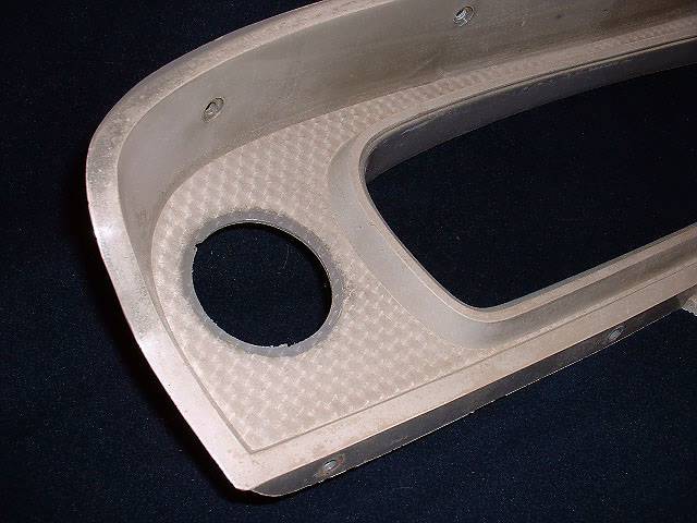

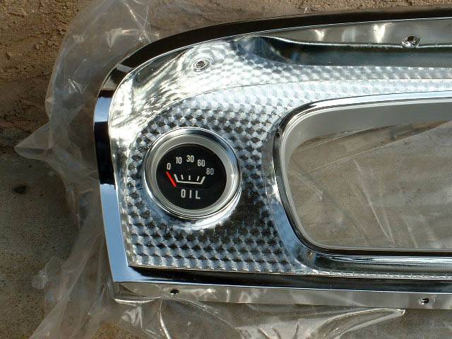

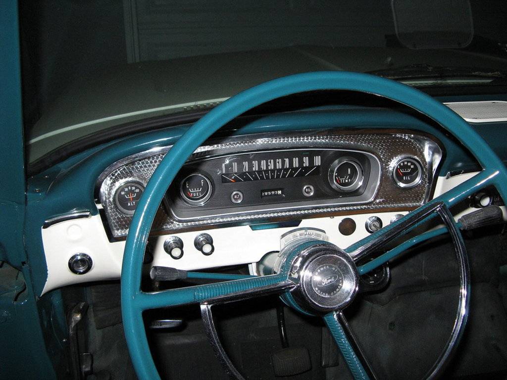

It's my understanding that the 60's factory pieces used a vacuum metalizing process. The other method (and I suspect that was used in the Ford dash pics) is actual electroplating.
Vacuum metalizing involves heating aluminum in a vacuum chamber until it boils and the aluminum condenses on the plastic. Electroplating plastic is done by coating the plastic so that it becomes conductive and then you can plate by the same process as you would a metal part. Those are real simplified descriptions and there's much more to the processes than I want to type out. Google is your friend if you want to know more.
The two methods both make the part "shiny", but I like the slightly satin look that the factory pieces had.
