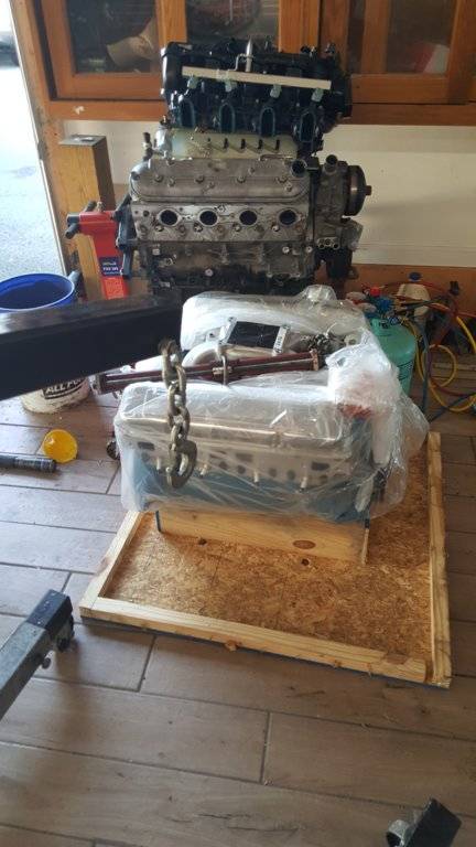

Damn that engine is beautiful. Video soon please!
Probably Saturday if I don't run in to any others problems. I still have a bunch of electrical work to finish and the Sanden A/C system to work on. Hose fabrication too.
