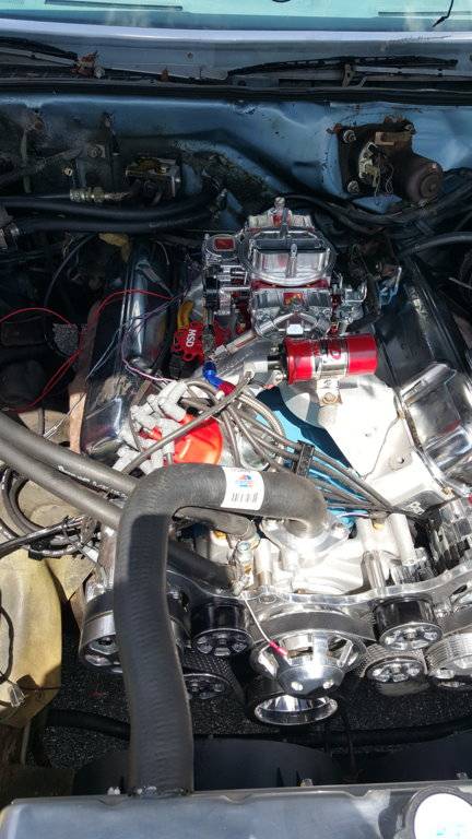

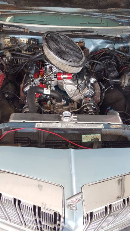

My old 440 was probably high 400 horse, I drove that thing all over, as I do with the stroker, closer to 600 hp.
So far so good, no problems at all.
