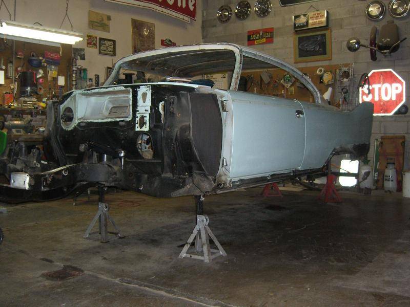

Just got mine back from S&G. It'll be a while before I get to drive it. Getting ready to flip the body to clean the underside.
I would like to do one complete resto rebuild before I get too old.
