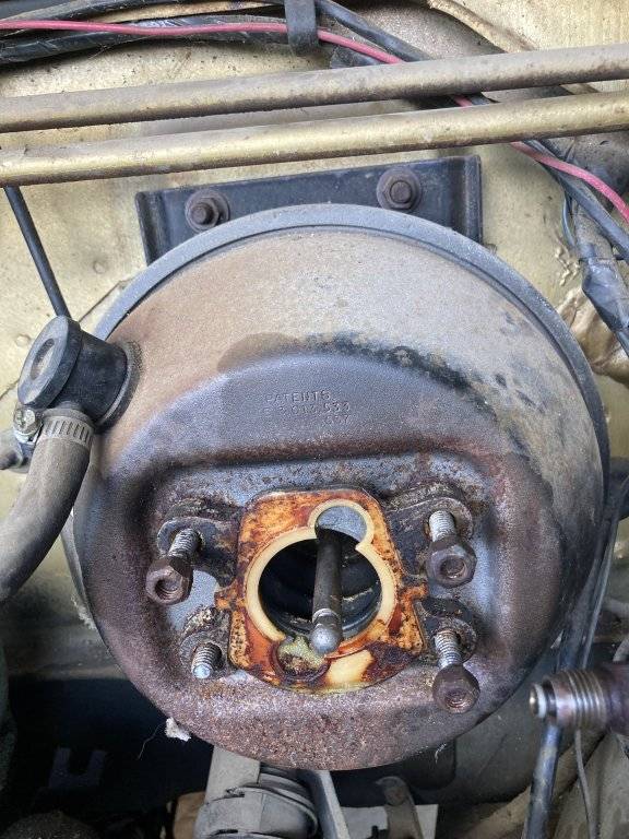

I need some advise on whether or not to change my timing chain and gear on my 300. I have my water pump housing off and timing cover is wide open for removal. Ive never done a mopar change out. Would I be smart to go ahead and change out? Ive already got crank set on on dead center and dist rotor set at #1. Is it pretty simple to do and whats a good replacement manufacturer. A good motor gasket set. I want to change out my distributor and keep point ign. Who makes a good replacement for this? Also broke off a stud on my brake booster, any ideas on where to get another good booster. One more thing!, timing cover, water pump housing and distributor seam to have black silicone around them, is this factory or has motor been in before? Ideas and advise as always. Thanks.
Either Cloyes or Mel Gear make a good replacement timing set. Fel-Pro for the gaskets and cover seal. Be sure to add some silicone sealer on the lower corners of the timing cover. Factory covers did not come with black silicone sealer, so it was probably done before. Halifax shops, a vendor on this site can do a factory rebuild on you distributor. Avoid at all costs buying a replacement at Car-Crap or Auto-Bone. A good rebuild shop such as Power Brake Booster Exchange can usually replace broken studs on the booster.

Post a pic of the broken stud and we may be able to figure how to change/repair it.

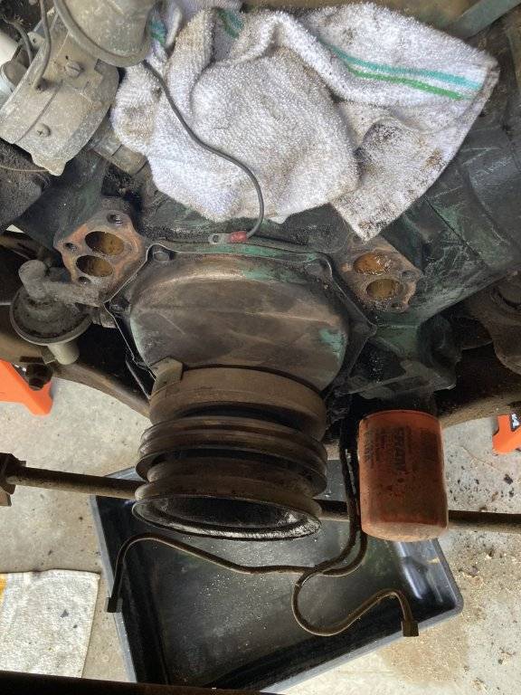

Yes thats what Im thinking, is there anything tricks I need to know when removing and reinstalling the timing cover? Someone has used an abundance of black silicone on parts, everything came apart suprisingly easy.
If your upper timing gear has plastic teeth, it is the original. Get rid of it. Technically these are non-interferennce engines, but the clearances may be getting loose. My 383 Magnum bent a few valves when my chain jumped a few teeth. Then there is the tow truck.....

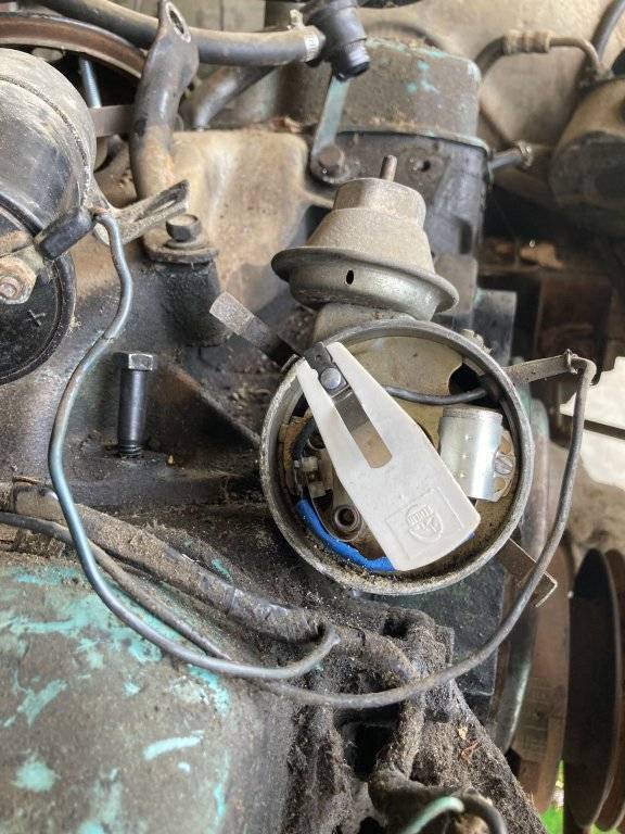

Looks like the condenser has been changed. That might be an issue by itself, from what I've seen in other forums of late. Old, NOS items usually fix the issues the newer ones might be causing.

Yeah I saw that wire strip on condenser. After I ck timing chain/ gear Ill go from there. Didnt make my summer dead line to get her runnin so I can slow down, be a little more thorough!
Those straps are OEM no issues with them actually better than a wire.
Yes, bands are better than wires. I know that some brands put the vinyl sleeve on the bands, too. I was just keying off of the blue sleeve as being "new", which is why I commented.

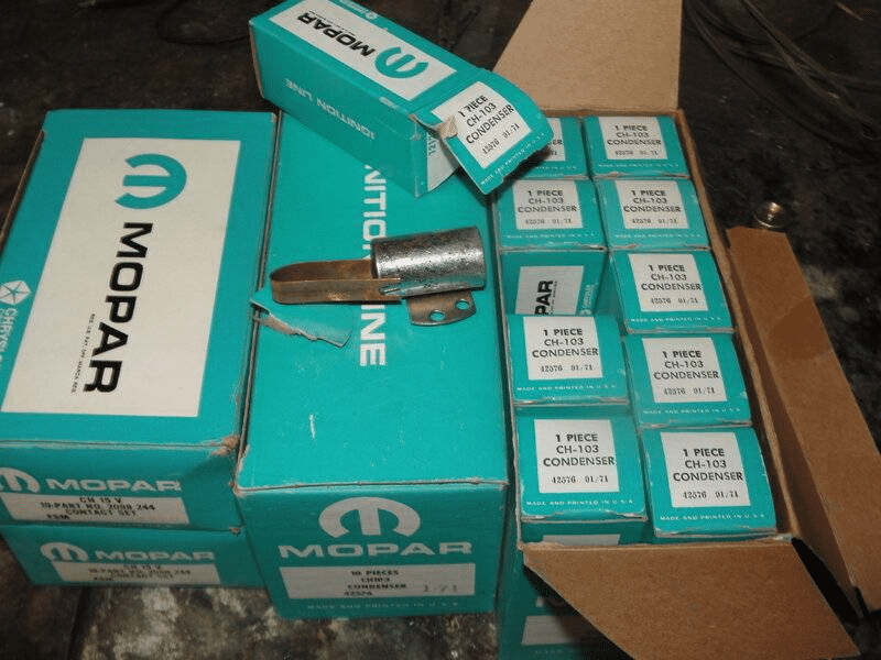

Thanks for that great picture of NOS Mopar parts!!
