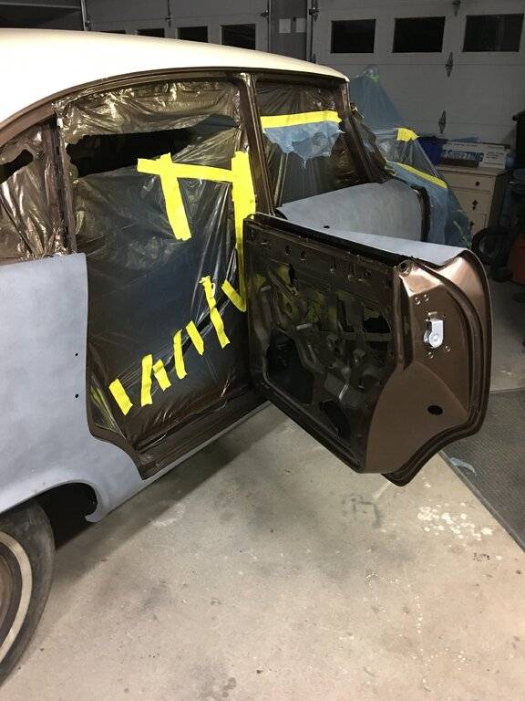

Door jams are painted and whole car should be painted in a couple of weeks... been a 25 year project

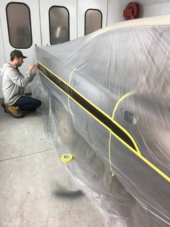

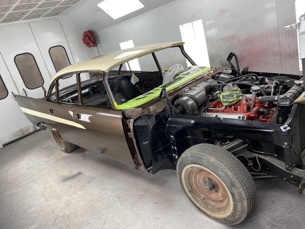

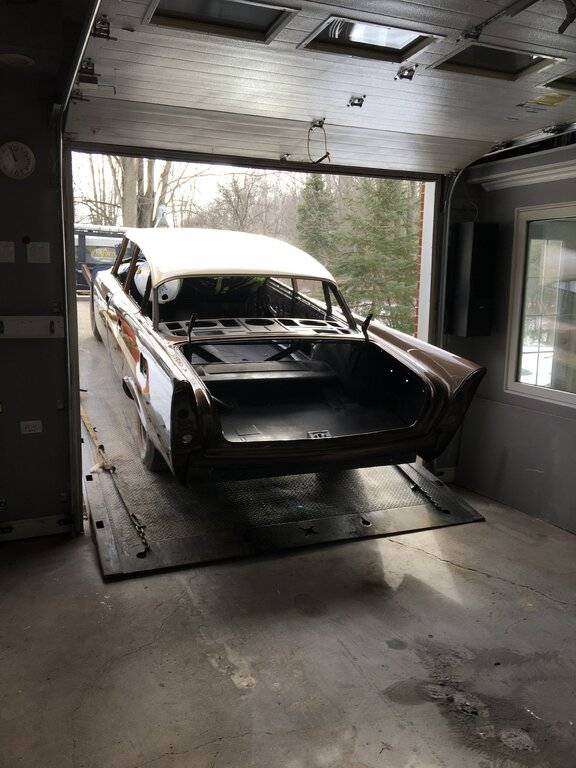

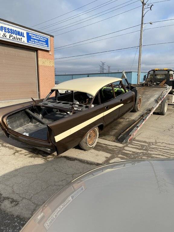

just an update.. car was painted on the weekend by my son Dan at his shop and returned home this morning to my garage for assembly. Will start with installation of headliner and welting... going to be busy for few months because I am not on a reality show that can have it finished by next weeks episode:canada:
Will be moving to the Members Projects and Restorations to chronical the assembly of my 1958 Chrysler...

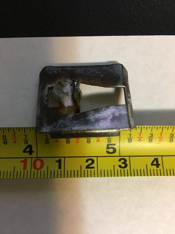

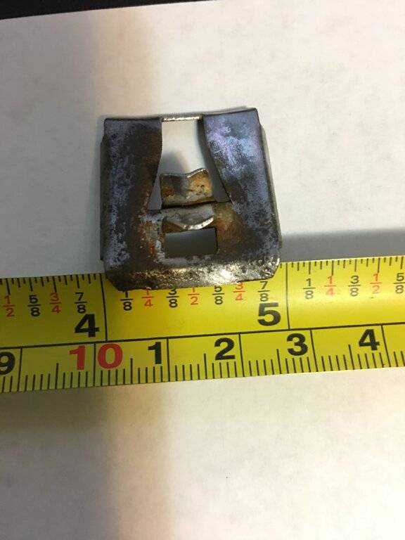

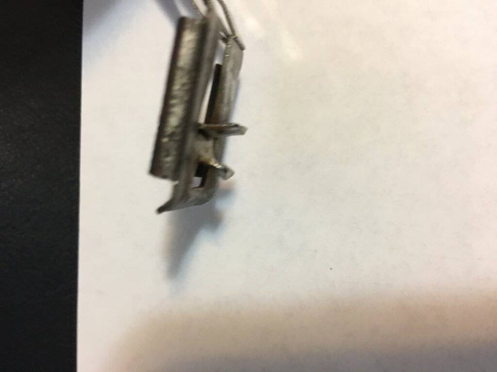

am in the hunt for some trim fasteners for the lower wide body side chrome.. the trim is for the 4 door sedan American Saratoga model or Canadian Windsor model.
here are pictures of what I hope to find..
would also like to know if any suppliers are still out for these items.
