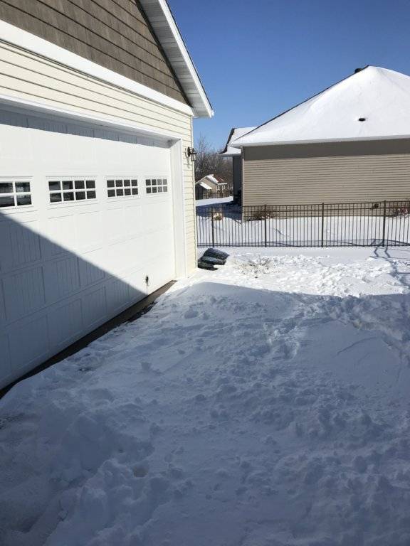

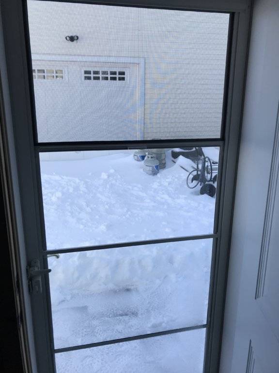

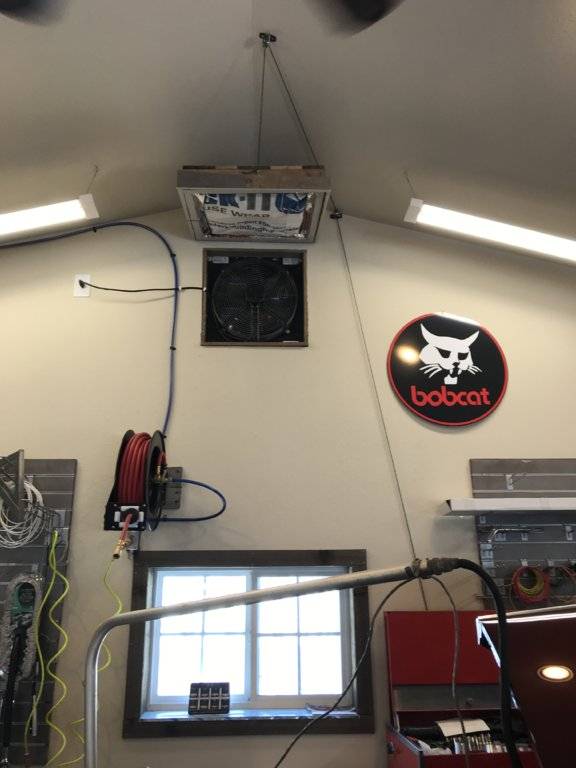

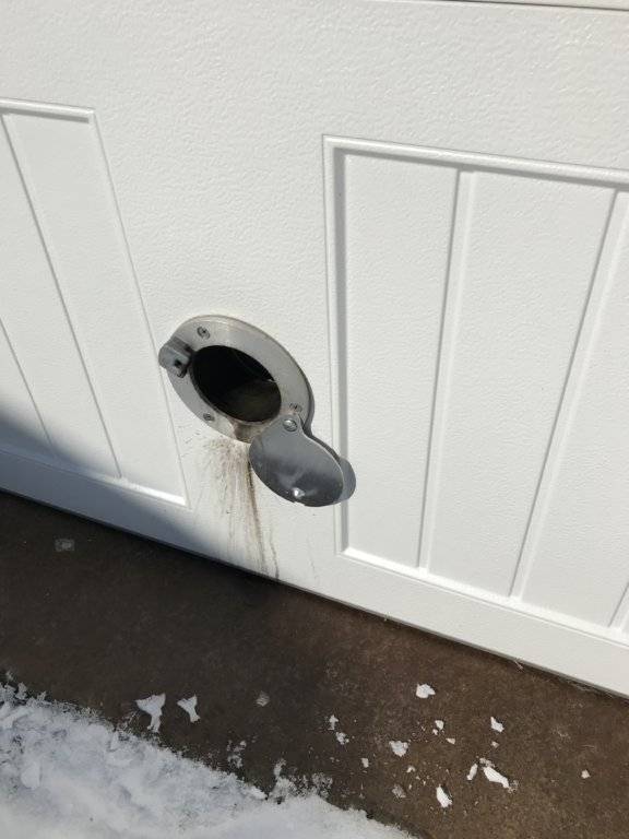

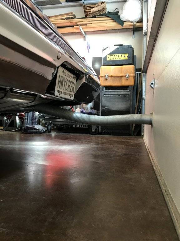

First a couple of safety tips so I don’t see the bright blue light from carbon monoxide.
I will not be opening my garage door.
but I do have an exhaust outlet
screen door opening and exhaust fan if needed.

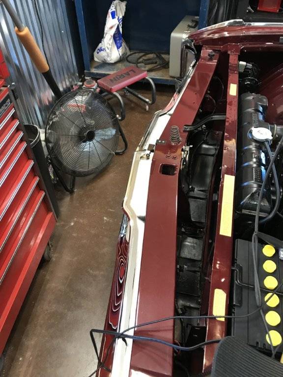

I can bring the garage temp up 20 degrees pretty quickly. I also have a fan on my radiator.

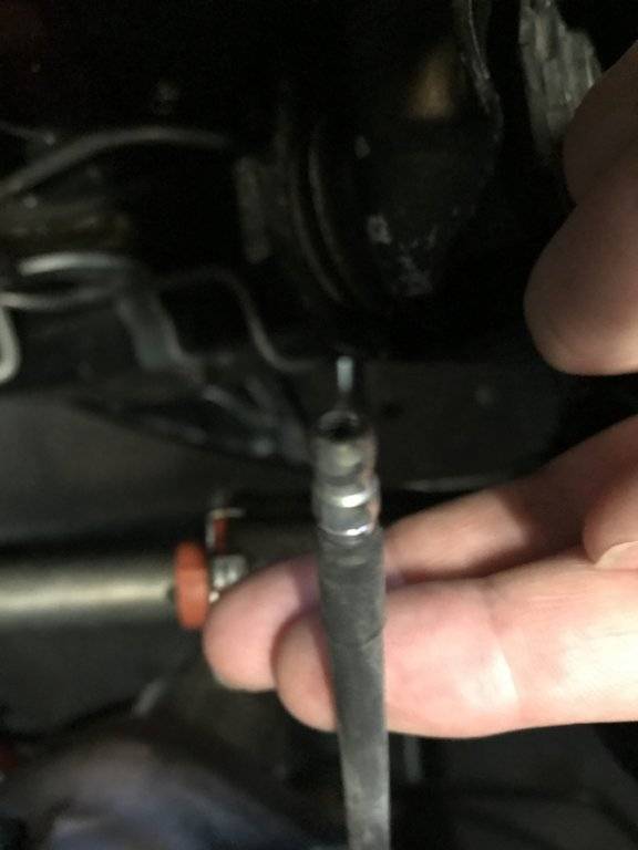

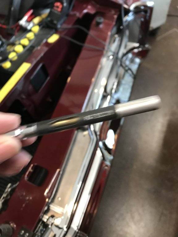

As I was hooking it up I realized I needed an adapter for my spark plug wire. The little tiny threads were not going to cut it. I knew I had a small engine somewhere that uses the little screw on nub. I found one on my 5th engine. It was on a little mantis tiller, so I borrowed it. Nice tight fit.
The little mirror adapter is handy, but you need a nice straight shot. A little shorter would be helpful. But with my video camera on my phone I could get most of it.

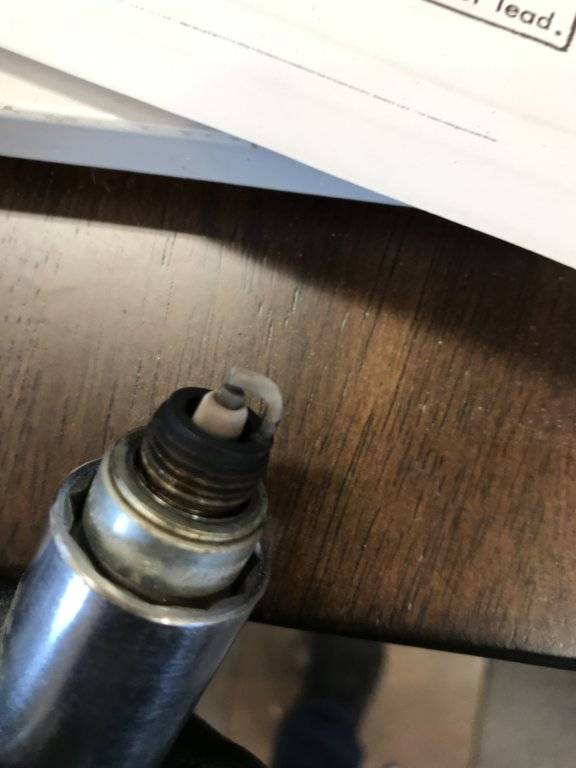

I am still going to stick the blue light in a couple more plug holes just to observe. I think I have a pretty good tune for now. Here are the two plugs I pulled. They look fine.

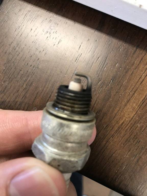

i agree your plugs look good and you do have room for improvements via fine fine tuning.
