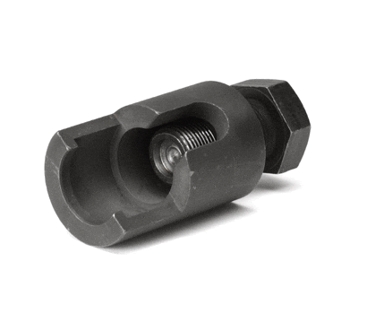

I used this;
Mancini Racing Lower Ball Joint Stud Remover
I had borrowed the whole kit, and this was one of the few tools that worked on a C body.
