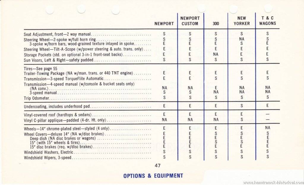

4 speed trans was a factory option in '67 on the Chrysler 300, which is basically the same as a Newport.
Wow, I had to go find that one... I never knew it and would have said no way... Learn something new every day....
