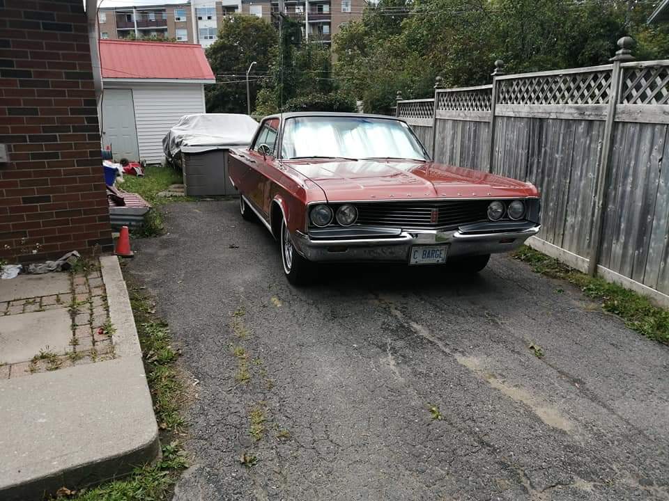

Meet Maggie May!
This is Maggie's car after all and I love her enthusiasm and wanting to work on her own car.

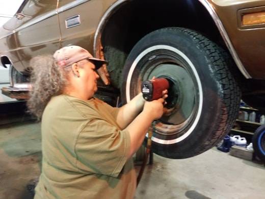

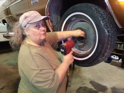

She swapped out her own tires last night...
It reminded her of her high school days hanging out at a Fina gas station busting tires way back when....

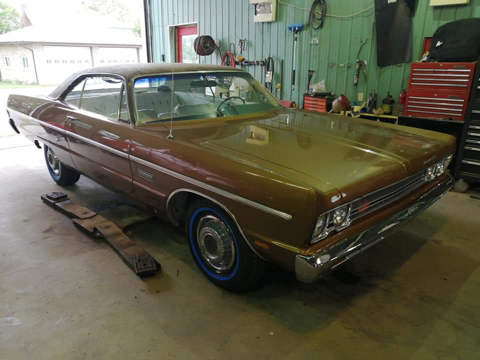

The car is in such great shape Maggie has set some ground rules and warned me not to overstep her boundaries..it is her car!!

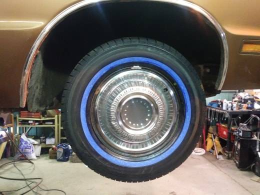

First couple rules were keep the original hubcaps and she wanted whitewall tires.
DONE! ...But with a twist!

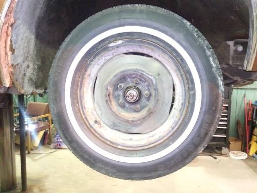

Frankie got 22570R15 Toyo tires but I put them on 15X7 Diplomat/5Th Ave plain Jane steel wheels.
Much better compared to the old and puny 21570R15 on the original skinny 15x5.5 rims.
Visually,the new combo had a nice squared off look that also fills out the wheelwells.
Ride and handling is improved with a bigger footprint and also the speedo will read correctly.
At 27.4" diameter,the new tires are bang on to the factory bias ply 27.36 OD 775-15 tires.

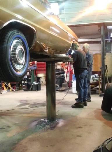

Crazy Don and I replaced the old wheel bearing up front.
They were worn,scored and the grease was dried up something awful.
Dunno why but the Fury left the factory without a front sway bar.
To improve handling I scored this sway bar at a yard today from a 69 New Yorker.
Being a 440 car this is the big 7/8 bar.
That should help firm up the cornering of Maggie's car...

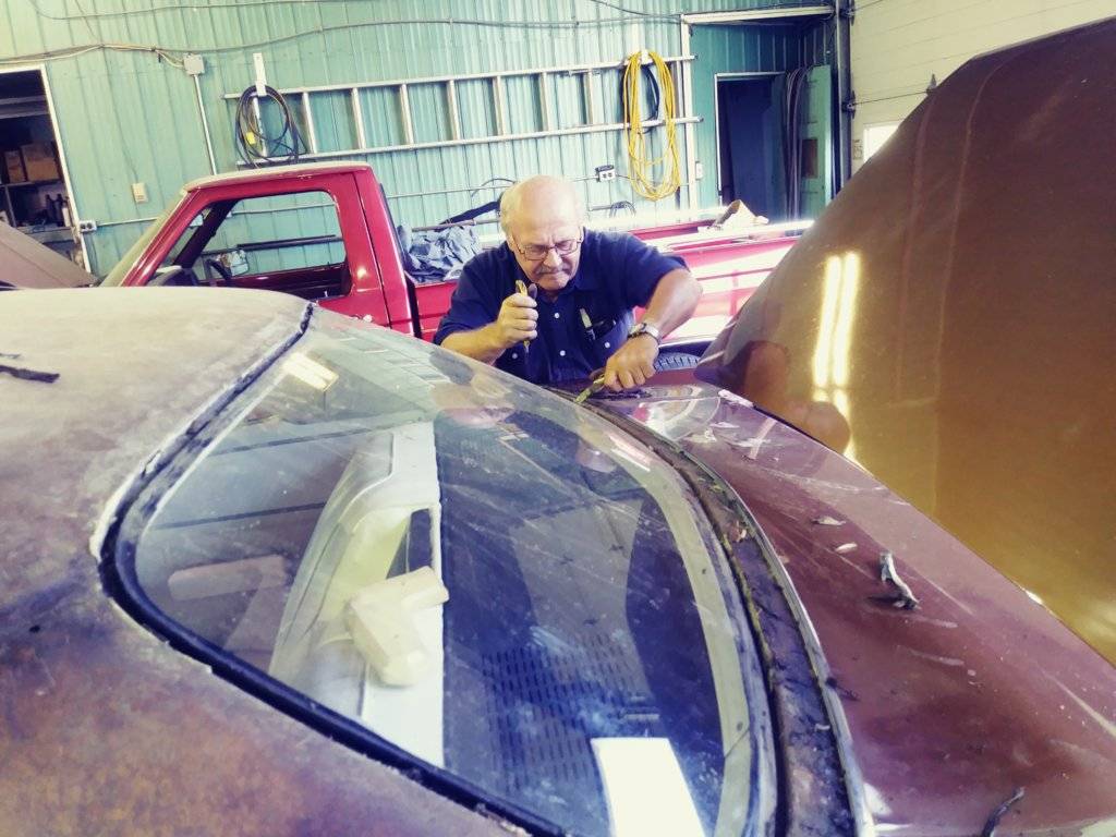

The yard we went today had a lot of old vehicles.
I also scored the very hard to find 1 year only washer jug.
Also found a nice electronic ignition distributor ( I am getting rid of the points system). Plus a gas cap which was missing on Maggie's car.
Nick came down and Crazy Don tagged along to scour the yard.
Nick scored some really nice goodies.

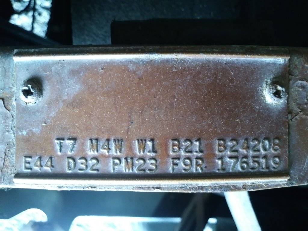

Is this how the Windsor built fender tags look? There's no bend near the left side screw in the fender tag and there are no inspection stamps anywhere on it. The tag looks good to me - I'm just wondering if this is how this plant normally installed their fender tags on the cars?
Nick and I compared notes and we agree that the Windsor fender tags are vague at best with no bends or other tags added. Typically an inspection mark would be on the right side of the rad core support far from the tag IIRC.
