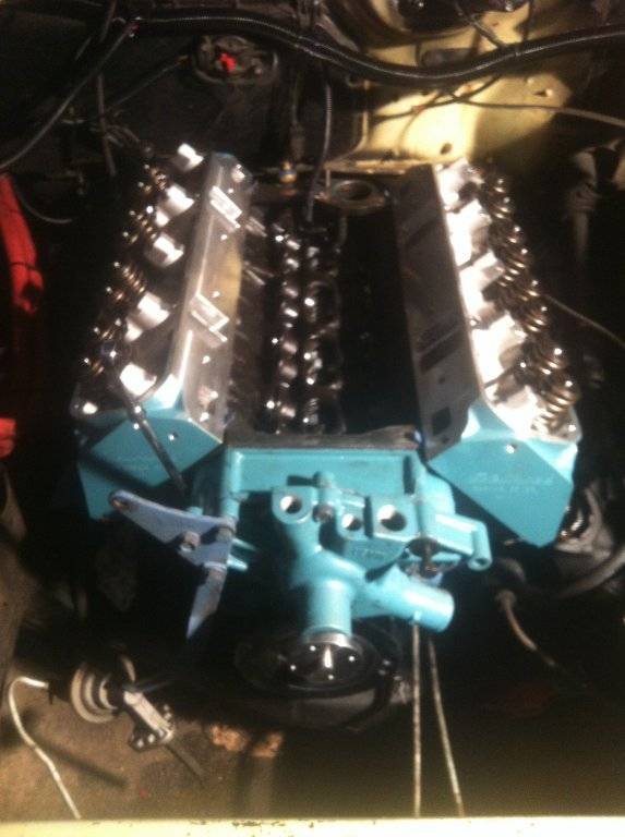

Hi Dear Mopar Friends
I Did a lot of Changes on my 318. Replace the Cylinderheads with Edelbrock 60775 and did several other Changes and replacements (new compcam camshaft, new lifters, new pushrods, new Oilpump …and so on).
After the First start actually the Engine starts great runs and sounds good, but after a few minutes it started to smoke hard and burns allot of Oil. After removing the Intake Manifold i saw a puddle of Oil in all of the Intake Chambers from the Cylinderhead, so my first Idea was to Replace the Intakemanifold Gasket. After doing that twice with different types of Gaskets, the problem was still there. So much Oil running trough the combustion chambers that it starts Dripping out of the Exhaustmanifold’s Gasket!
So my next Idea was that the original Intake Manifold does not match with the Edelbrock Cylinderheads (subsequently it will suck oil and air from under the Intakemanifold). So i ordered the recommended Edelbrock Intakemanifold with all the Edelbrock gaskets and replaced it again.
No Changes still the same Smokemachine.
From now on i stuck completely, i have no more Idea what else to check or to try.
i would be grateful for any idea or input.

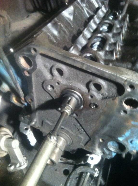

thx for your help guys. sorry for long time no answer. the valve guide seals was an issue (but why should they leaking all the same??). anyway.
i removed the heads, free the valves from the springs just to see that the «hats» was allright.
in that same turn we did a «paper print» between the intake manifold and the cylinderheads just to see that the have the same angle and the channels fit's
well together
there are 2more issues i'am thinking on.
-1 doubt on my self, my work (did a lot of engines (never a 318), commercial and private, they all run well)
-1.1 the manifold torquing issue (details here: http://forums.edelbrock.com/forums/...opar-smallblock-318-7576-intake-how-to-torque )
-2 TOO MUCH OIL PRESSURE. (why?? the pressure balance valve of my new oilpump could be damaged) ---> IMPACT the space under the valve covers is flooded in oil (too much for the valve guide seals)
thx
sascha & d.
