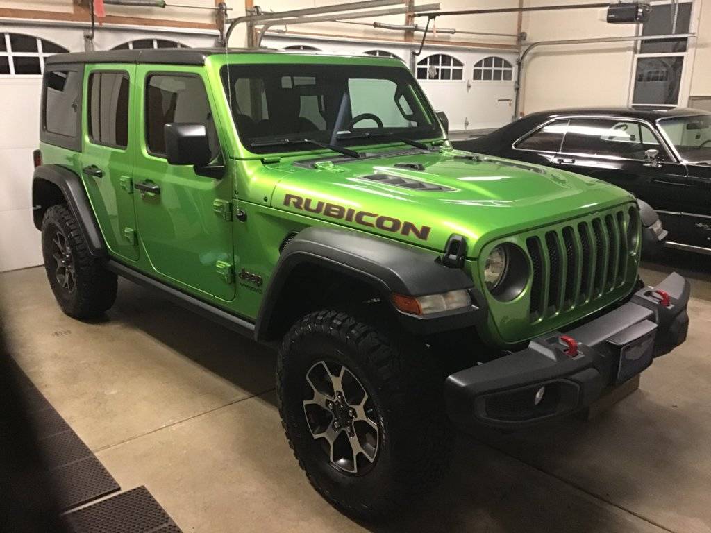

You’re talking about the “stop start” feature. Our new ‘18 Wrangler has it and I can’t stand it either. Fortunately there’s a button on the dash to disengage it.
