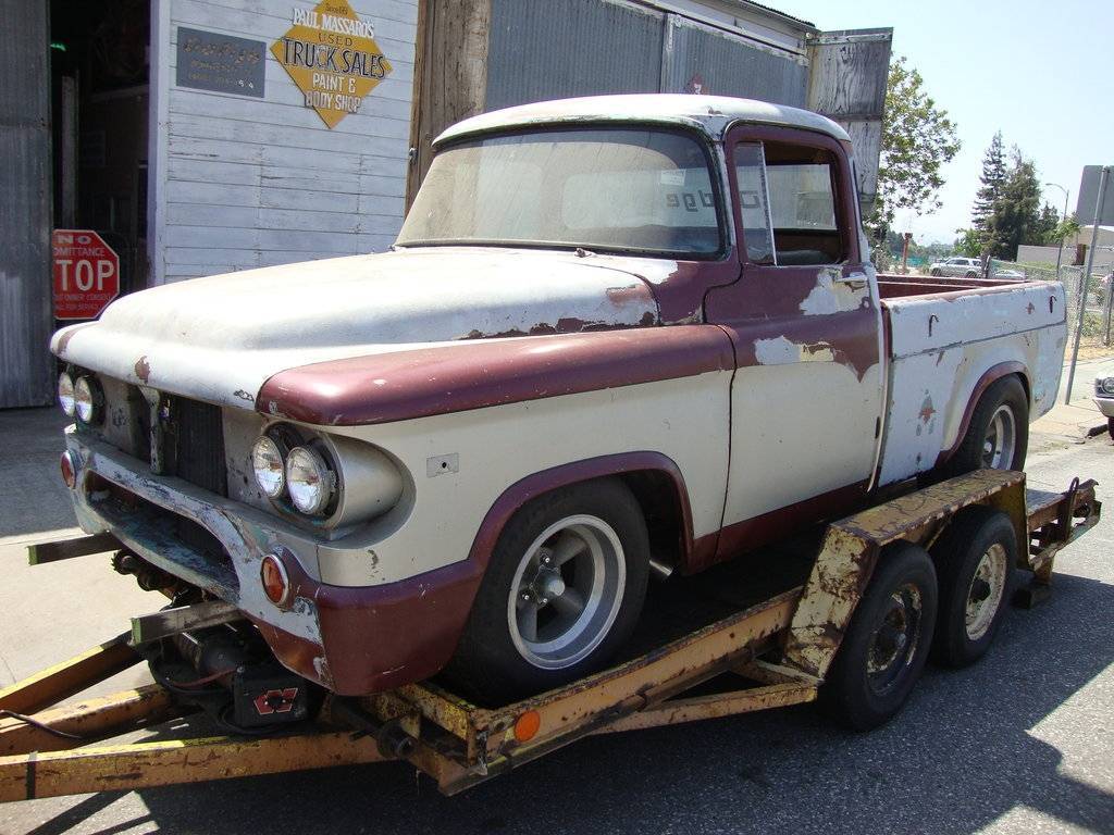

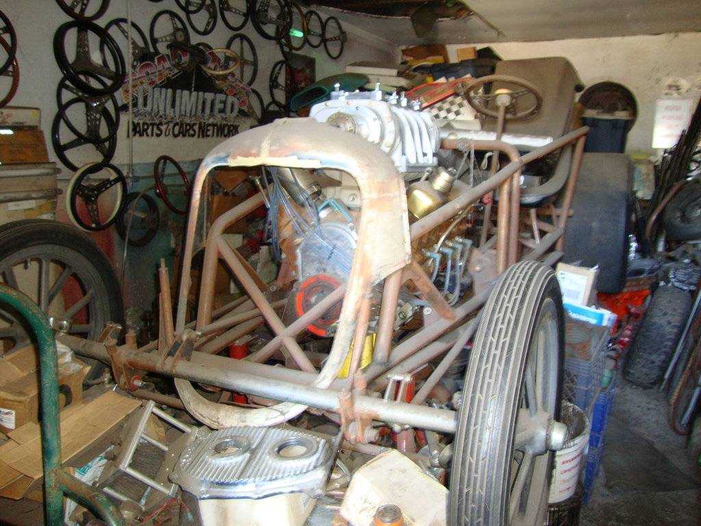

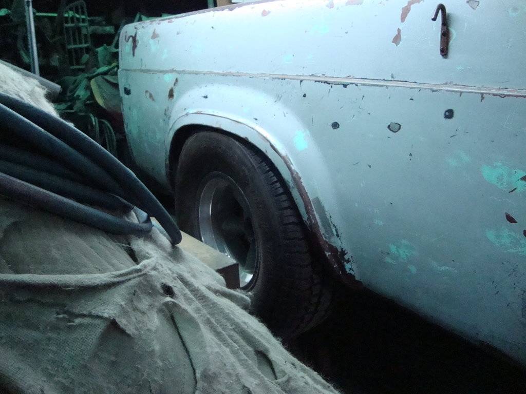

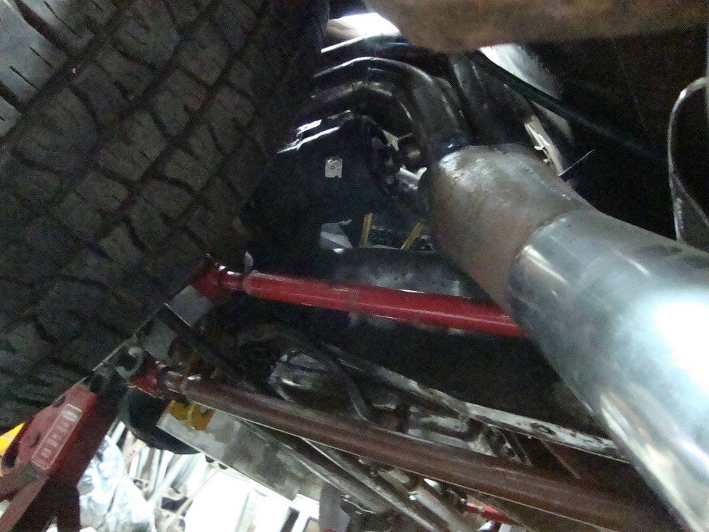

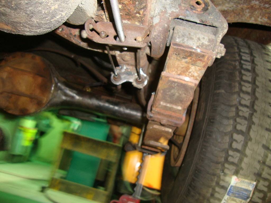

this is my 60 d100 with 68-70 b body r/e and 285/70x15 , swapped to the top of the springs , had to add some springs to the package . i put 315/6ox15 on it .they just fit . there big tires man , lol .

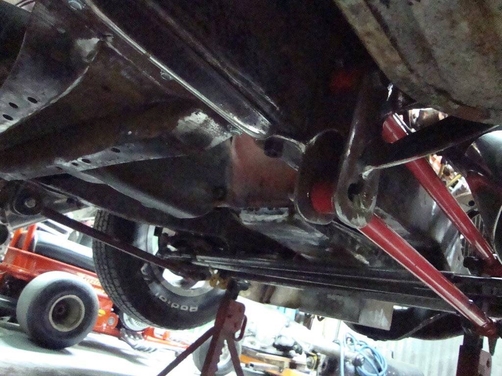

the noise is a four bar and cross steering with a mopar steering box .

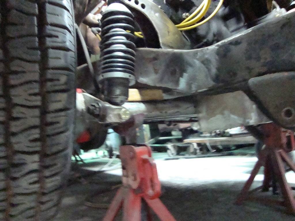

4'' tube dropped axle , and coil overs . its low for a driver . headers are home builds . the 315 are on the rear here .

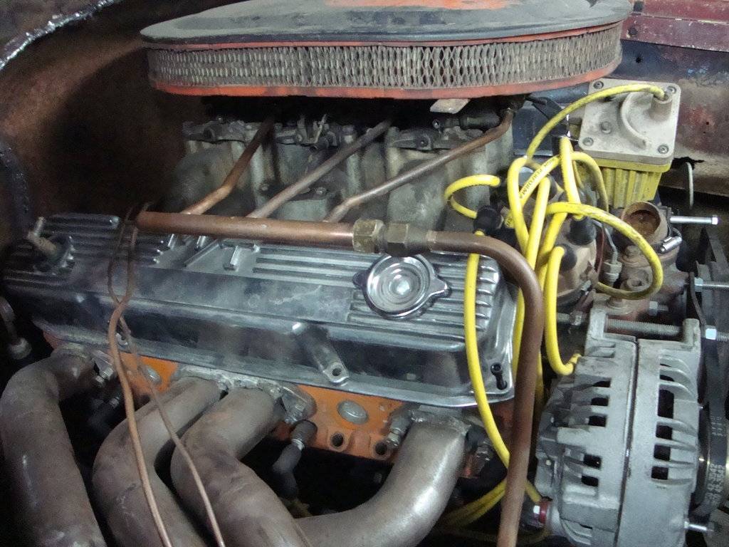

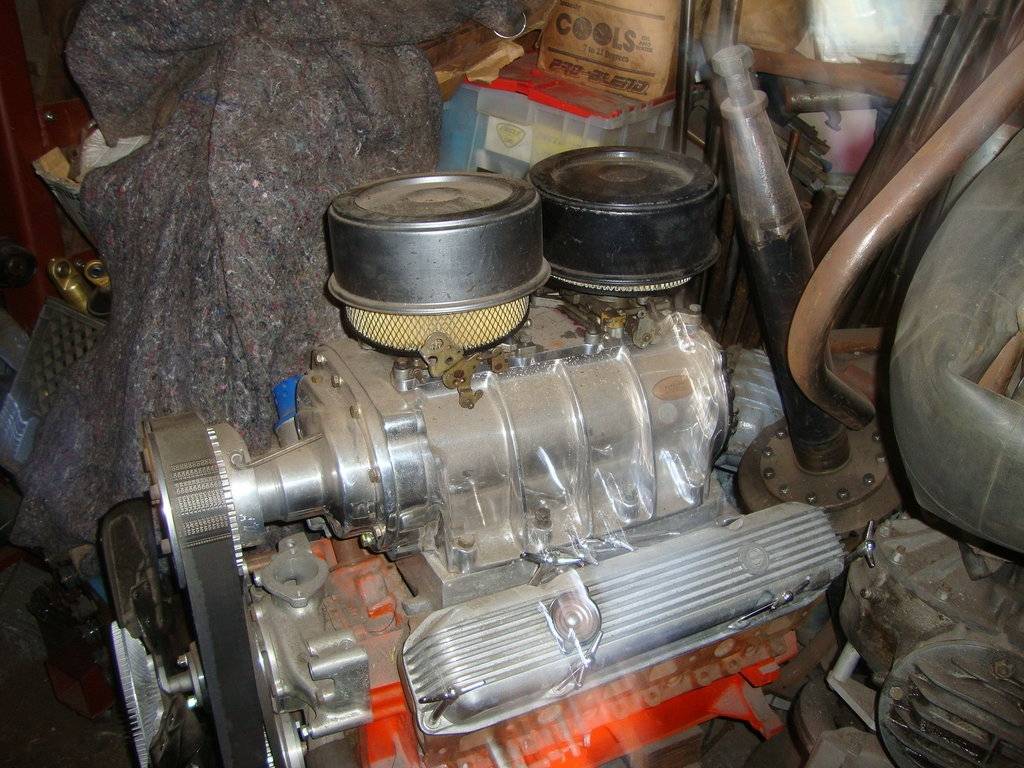

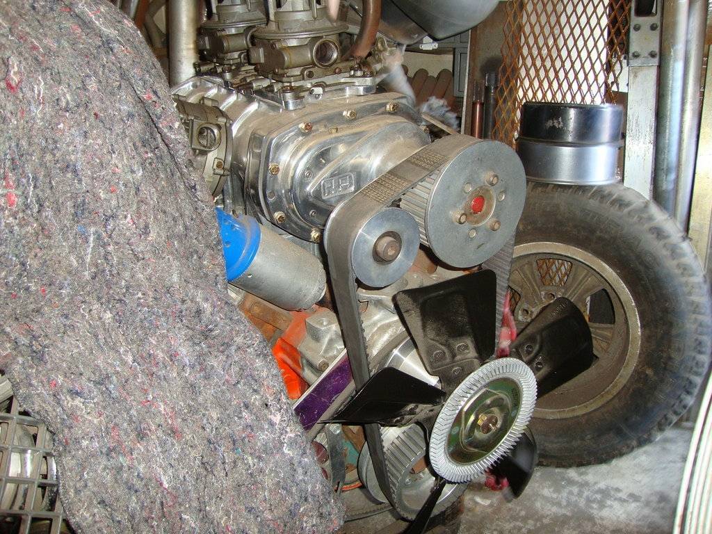

boss , was a term used . and bitchin was used as well . back when a snowflake fell from the sky . lol . bob it should run well once i get the power train assembled , this p/u is just used parts mostly , stuff hanging out here and there , bought a garage of some from a guy moving , couple rb's and a bunch of la and l engine parts . but in this mess of stuff was a burnt down 440mh lower end . hole in a piston and scared cylinders , it got a stroked crank in it , and all arp lower end fasteners , measures to a 468 , got a 3.9 stroke crank in it , block was bored to big , got hot and cooked it , but the block and pistons are replaced with a 71 issue 440 rb , so that my lower end , a 468 rb with a 6pck . but that might change to this other motor i've been playing with , blown 383 on lps . i'm just thinking mind you . but it would be cooler than a 468 n 6pck , lol . what do you guys think ?

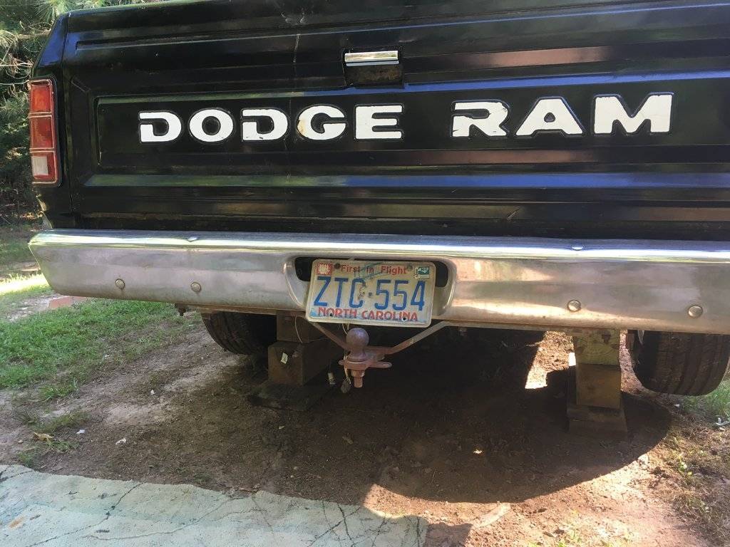

This afternoon I had time to get the bumper hitch installed on the D440. Mainly just to move trailers around & haul my utility trailer with it. Nice little addition to the hot rod truck

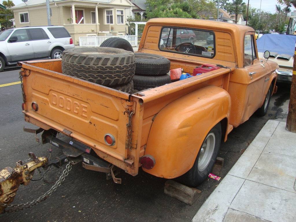

well thats okay , a little little duty , bob . my 64d100 reciever type just under the bumper , but were is the bumper ? its wrecked and i must straighten it out again . and this d200 has a state made one and bumper . it too will get a reciever type cut in .
I took a class V receiver off an 84 Ram to use on my 72. Should have taken more off that truck before I sent it to the scrapper.

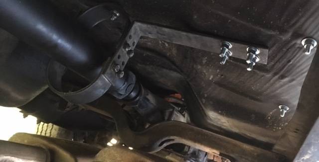

Got the driveshaft safety loop installed today. Now the only thing left is to get a good working carb in it. I have a decent looking Carter AFB (looks like an Edelbrock). I may let my carb guru work his magic on it & try it. Hopefully some test passes are in the near future
