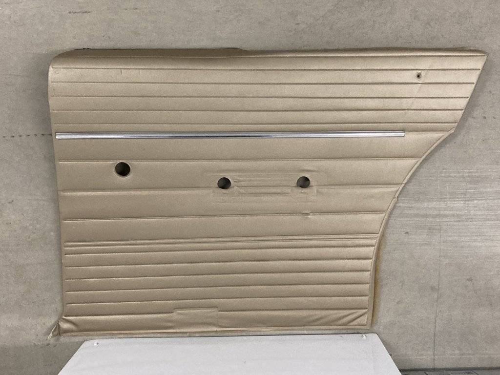

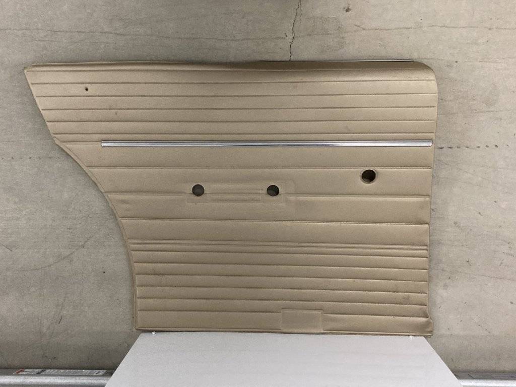

I’ve got some door cards from a 2 door New Yorker that are gold that are in great shape. Not sure if they can fit but they’re yours if you want them. I’ve had them for 20 years and am tired of moving them…
