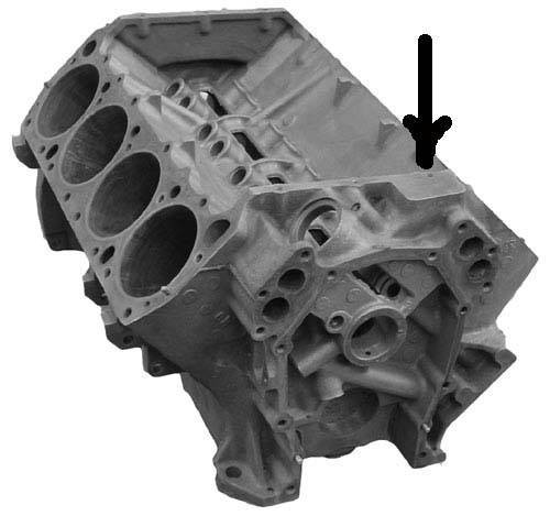

On the 440 as your looking at the front of the engine on the right hand side there's a square pad. It will be just in front of the intake manifold. The 383 doesn't have that, and the 400 doesn't have it ether.

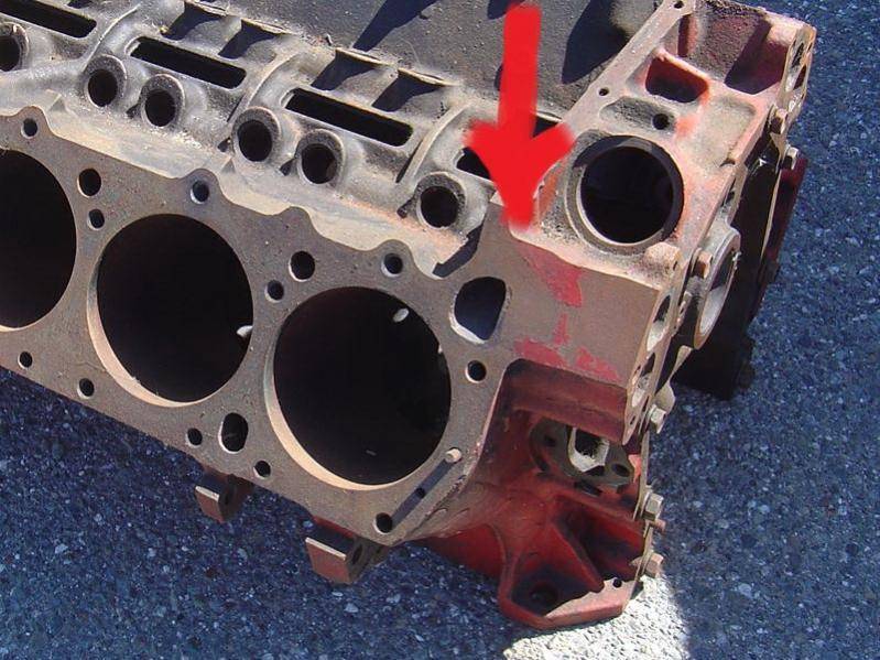

Pad is cleaned off in this pic .. to drivers side of dizzy
440 or RB blocks will have a raised machined pad. Sometimes it's hard to see if it has a a/c compressor mounted
383 or B blocks are easy to spot as the waterpump jackets are flush with the cylinder deck.
The displacement is stamped on the pad .. i.e. 440, 426, 413, 383
