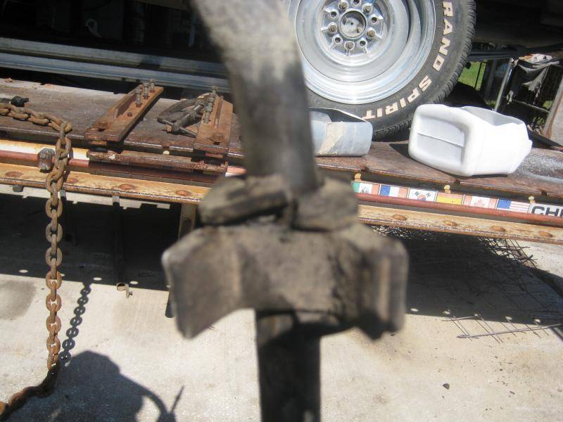

I need to replace the bushings on the sway bar. Does anyone know how to do this? The bracket has no split in it to separate it to pull the bushing out.
My brother did it on his '66 Formula S a couple years ago. He separated the pieces and installed new bushings, then I re-welded the parts along the edges for him (he preferred welding to bolting). He held a wet rag on the bushings during welding to keep things cool.
not too keen on welding it back together. Just ordered the sway bar bushing kit and sway bar to frame bushings.
