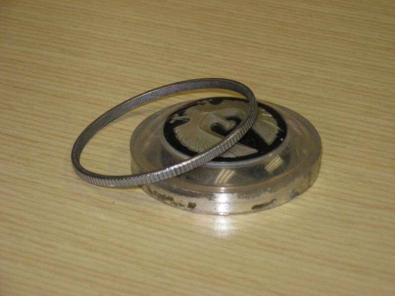

When I was closing the hood after checking the oil, I hear, tink, tink! Crap. The center fell out of the hood ornament!
I'm sure with a little glue, it will be right as rain.

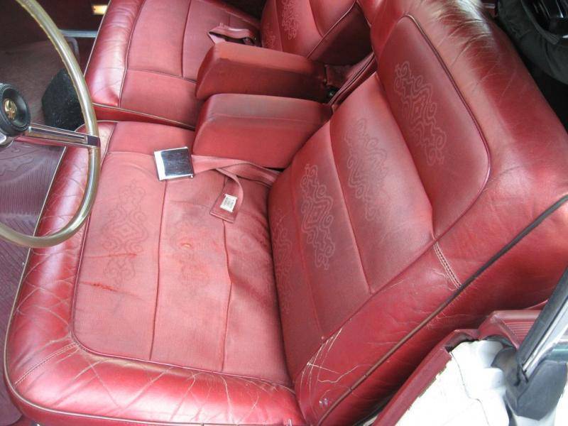

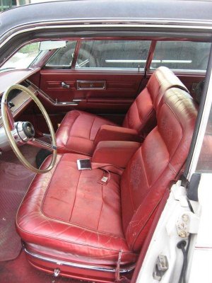

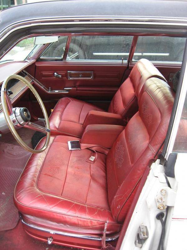

In the mean time, I thought I'd post up some pictures of the interior. It's generally in good shape for an unrestored car.
The driver's seat is saggy, and has a couple rips. I've contacted an upholstery company to see about getting some replacement fabric. If it's in stock, I might get some for future use, but if they are making it, I'll probably wait, since I can just pay later, right?

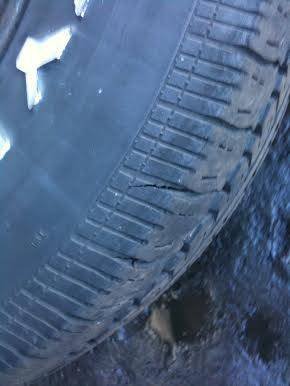

Interestingly, I had never thought to check the size of the tires that were on it previously. Since they were RWL Goodyear STs which were a little old, I had known they were coming off. I didn't care what the size was of the tires I was throwing away. They were 225/70R15. My handy tire size calculator says that was 1.5 inches shorter than the 235s.
They were also weirdly cracked. Never seen the shoulders have cracks before:

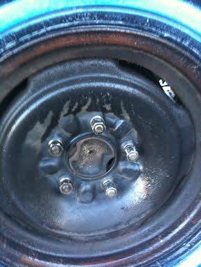

Also interesting that one wheel had mismatched lugs.
The tire guys did a nice job, though. I forgot to remind them about left-hand threads, but there were no stripped or broken lugs. They told me an hour, but I came by at an hour and 45 minutes, and saw the poor guy going at my wheels with a wire wheel to get rid of some rust on the bead (it's a Minnesota car originally). All told, it took them closer to 3 hours to get it done. I think they also gave me long valve stems. The stock covers are pretty bulky, and it makes it hard to check the pressure with them on. Looking forward to having proper pressure easy to accomplish.

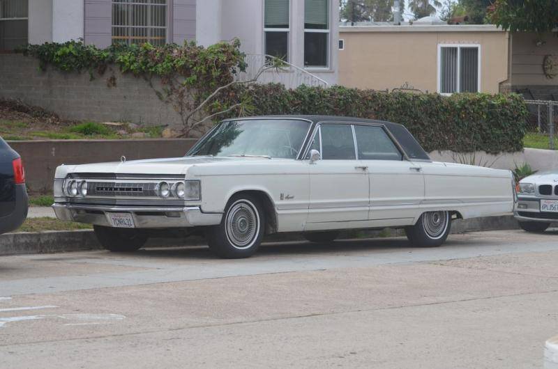

The plan was to wash my car when I went to my mom's house to clean out a garage so that a family friend could park his '57 T-Bird (his parents were the original owners) in there. But we measured, and we would have had to dismantle a set of storage shelves to make it fit. So I washed my mom's car and mine instead. I've got to say, I didn't wax it or polish anything, but it cleaned up nicely. It also made it easy to see all the different colors of paint from body damage over the years, but I didn't get too worked up over it. Lots of time to piss and moan when I get to the bodywork stage of the project.
I would say its worn seems like they all are its inherent of the nylon covered aluminum gear but if its not shot i.e. real bad and compression check results in close, normal numbers I think 14+ on highway is doable.
That Imp looks great, it needed those white walls badly! You can check your chain by turning the engine by hand with a breaker bar and a 1 1/4" socket back and forth slightly with the distributer cap off. See how long it takes for the rotor to move when changing the direction of engine rotation. Mine was not in need of replacement after 136,000 miles btw but probably an exception to the rule though.
Thanks, guys. It definitely looks better from across the street than it does close up. But it's good enough to drive, and for now, that's what counts.
