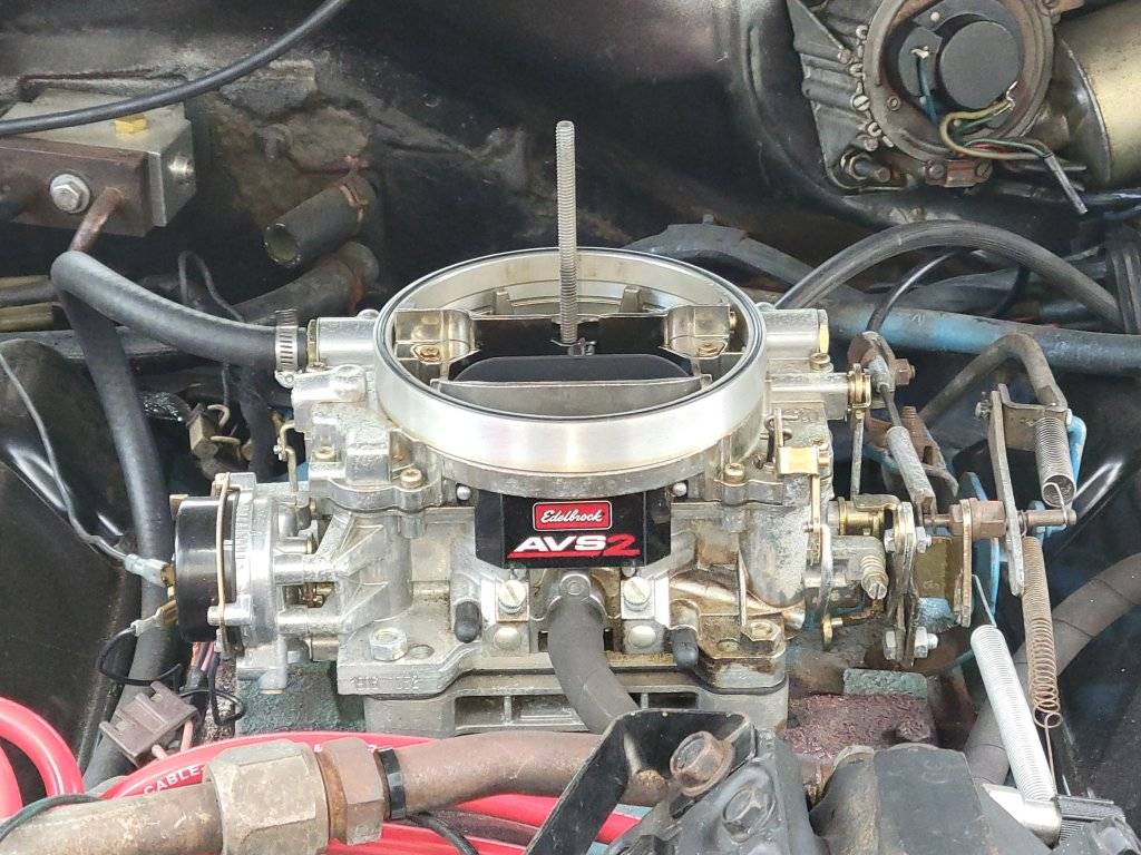

The carb has been replaced, but we think its incorrect, only a 650. Edelbrock. Thinking if looking for an original thermoquad.

should i go back to the factory "lean burn" setup? or what's a better aftermarker carb for this car? i see so many Edelbrocks and even Holleys that i don't know what i'm looking for.....

I would recommend you drive the car with the current carb and determine if you like how it runs over-all. I have a 17K 1978 NY with a 440. The Lean Burn was troublesome after a few years when these cars were new, even worse when they are older. I would guess that 97% of owners who regularly drive have replaced the carb with something similar to what is in your photo, a good old mechanical carb with and electric choke.
The 440 engine throws off a lot of heat, which may results in hard starting - idling issues in extremely hot temperatures [85 F +] with ethanol enhances fuel [corn gas here in the mid-west].
You have a beautiful car, but these will never be the mega-priced Mopar's like the Cuba and Roadrunners. Get the car to run so you can drive it and enjoy it. No one is going to turn their nose up because we had to update a few components to adjust for operation in 2022.

Leave the AVS 2 on it, I love mine. Please do not go back to Lean burn. It worked okay in testing at Chrysler, It worked okay when the car was new, It won't work worth a damn today. Most of the folks in this group are died in the wool Chrysler guys. They wouldn't do it. Just go digging. You'll find the answers. Great looking car by the way!
