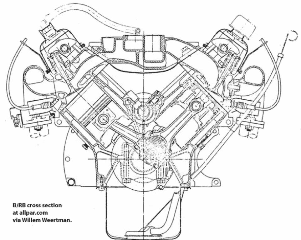

Not to be argumentative.... but rather curious... don’t the 440 blocks have a separate valley cover between heads? Also, if I remember correctly, the intake manifold sits clear and separate from the internal engine air volume. Are you suggesting oil would travel up the bolt and past the gasket to intake runner?

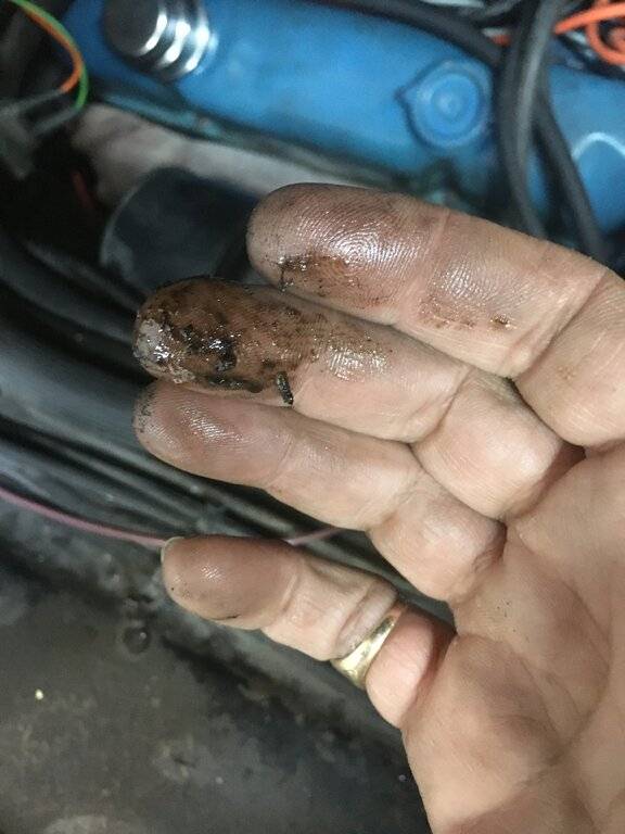

checked a few cylinders (cold) and all let out an equal puff of oil with the plug out on a testcard. We appear to have more soot than oil here....

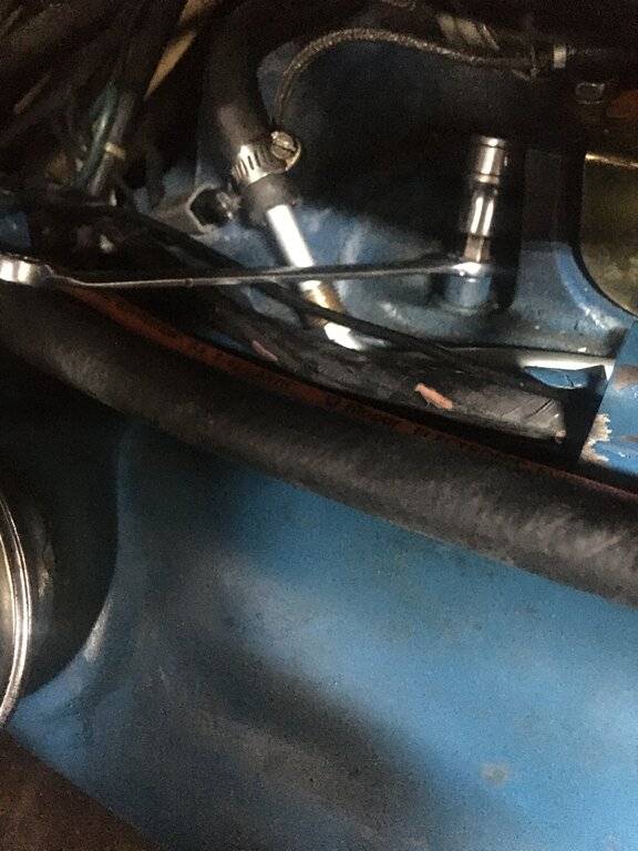

Going back through this thread, block came with intake from builder. Bolt is tight but had what looks like oil around it. Only bolt on intake with oil around it. Good paint under it .... so oil (or whatever it is) must have come after engine was painted, installed and started. Cleaned it out to see if it comes back.
I can see that part of the inner top of the heads is exposed to the internal air volume. So 70bigblockdodge may be on to something.

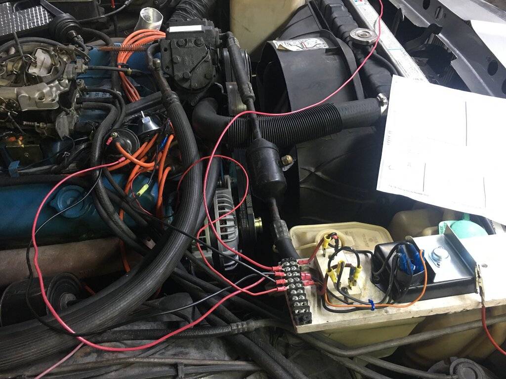

Before I start tearing into the engine and checking **** hot. I started looking at the simple things first. First, checked the vacuum lines for splits or leaks. Then disconnected all vacuum lines and plugged them up... no change. Then went adding them in one by one until I was done... no change.

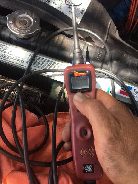

I noticed that the A/C compressor clutch was not engaging when warm. Checking line voltage at the switch and found it was just over 11 volt.... NFG.
Checked the power level at the battery terminals 12.2 volts. Also NFG.
I had swapped out the battery thinking that age and time in the shop had killed it. It was well into its third year after all.
New battery in at 12.6 volts.... battery terminals still feeding 12.2.... NFG. That left alternator or voltage regulator. Checked voltage regulator and it appears to be fine with power to fields steady and topped out and terminals tight.
Alternator then.
Low voltage also plays havoc with the ELB computer..... BTW....as well as give you a crummy spark.

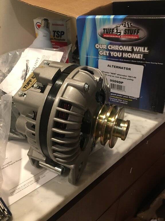

Ordered a new alternator last Saturday and got it on Thursday. Nice one. Real pretty but ,best of all, says it can put out 130 Amps under full load. Hell, I only need half that (though I do have that rear window defogger still left to wire up..)
Put the new alternator in and she runs better but the miss is still there..... just less so. Guess the hotter spark from full voltage helped.

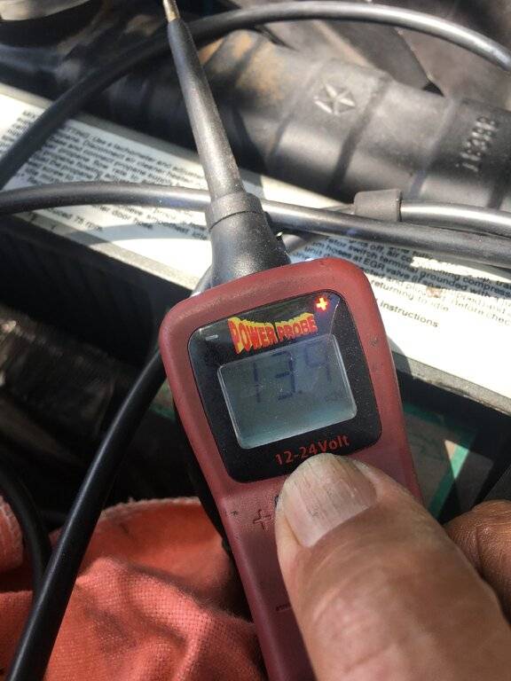

Voltage output after it settled down.
Initial voltage at start up with weakened battery.

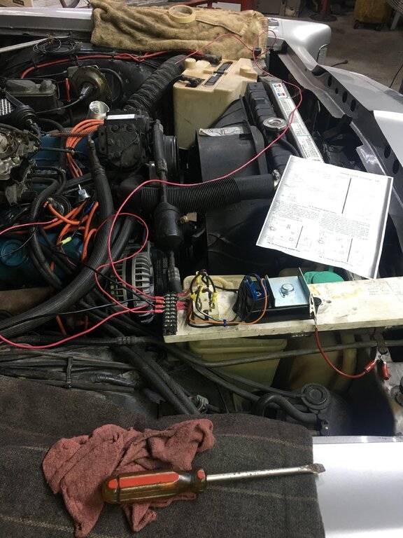

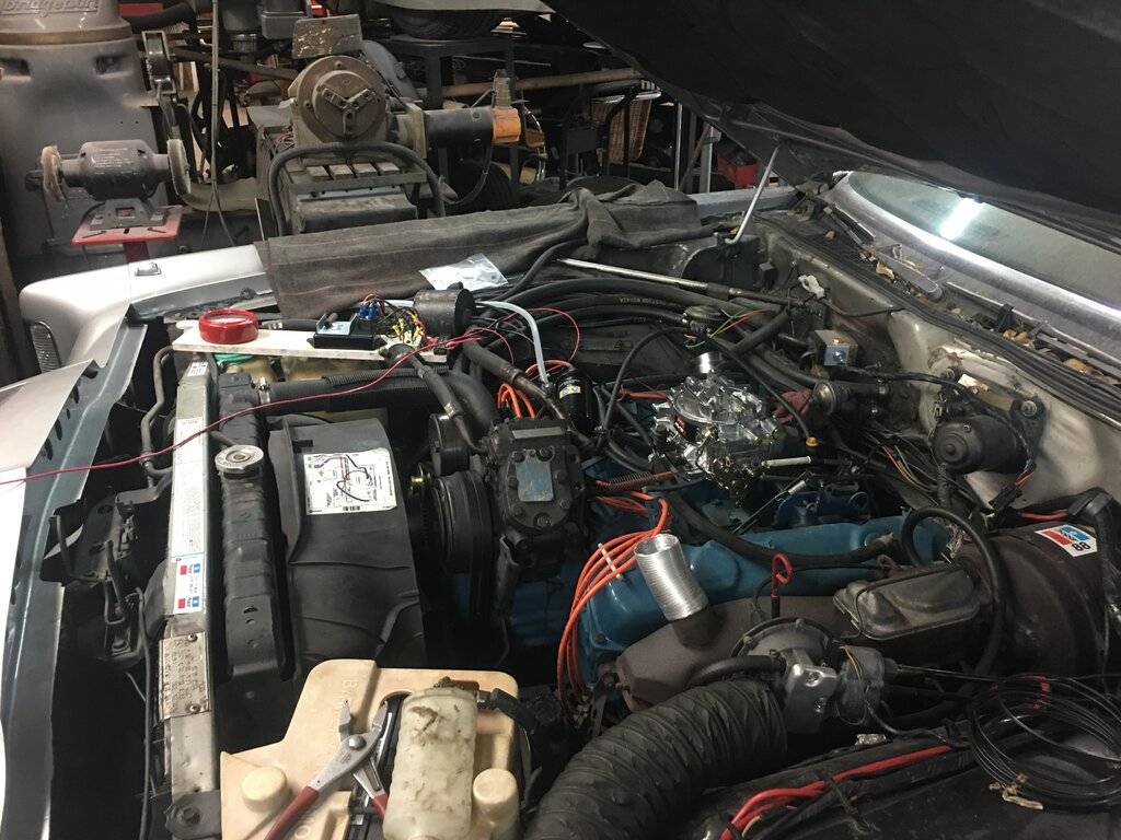

In an effort you can only ever call extreme. All new temporary test ignition….
Ok….. no laughing. It worked great but miss was still there….

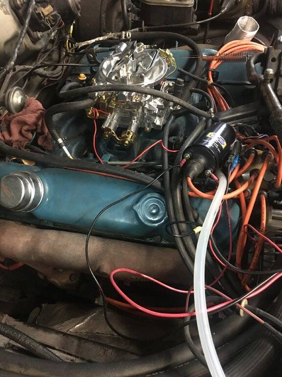

So yesterday….. unbeknownst to me, he took off the exquisitely running and tuned Thermoquad to put on a plate and run the smoke machine through the intake …. No leaks from the intake he could find at all. But if it’s leaking through the engine side or very narrow, the smoke may be “filtered” clean.
so the next rediculous test was… run something other than the Thermoquad…….
Stan’s gonna love this….
note to Stan….. it was exactly the same. Easy start, smooth acceleration, if a little leaner requiring more throttle to hold idle right out of the box…. but miss and rough idle still exactly the same.

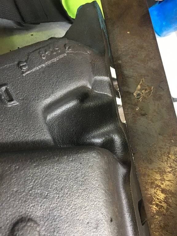

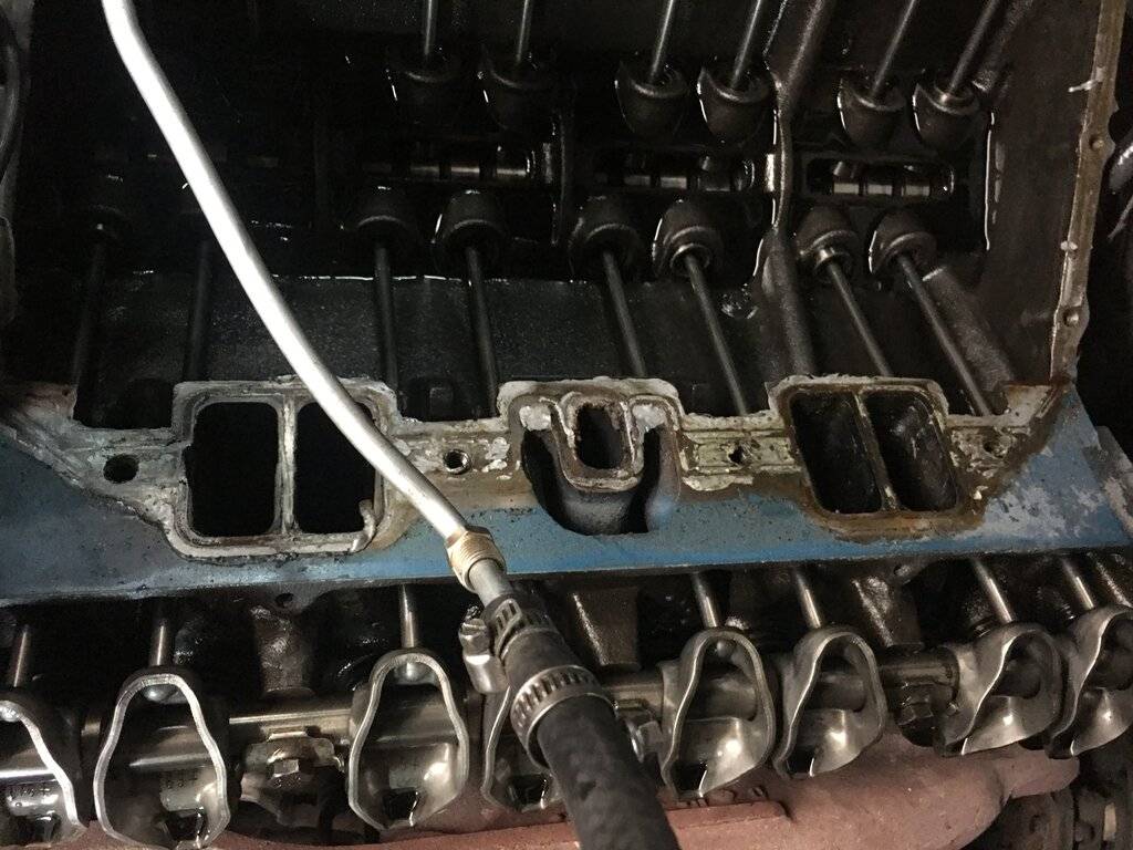

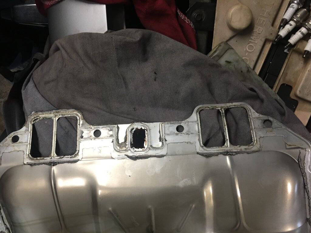

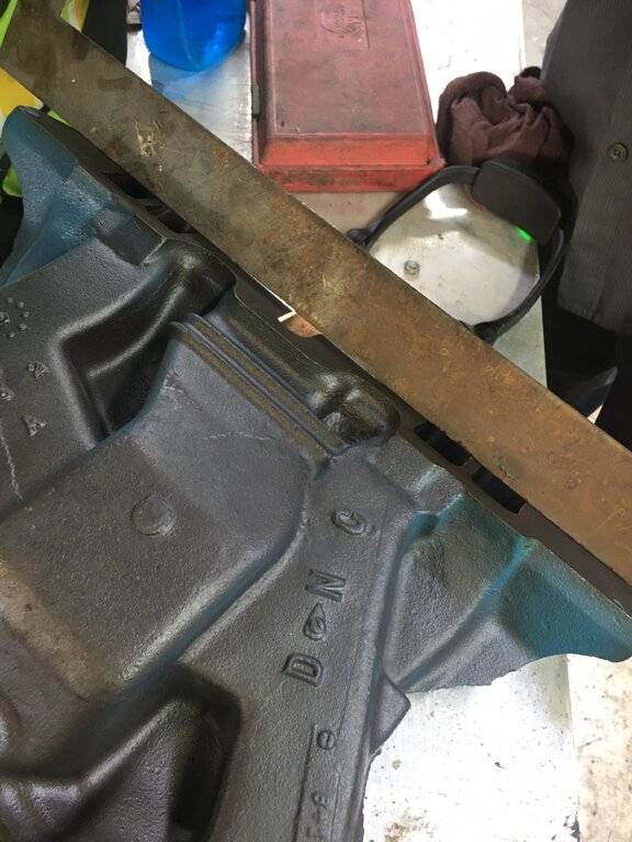

I pulled the intake and it looked to be fine.
No cracks and gasket was fully seated and tight.
the only thing “off” was that the mating surface of the intake was a bit proud on the ends by about 2 mil.
Not enough to make a difference, but it’s now flat.
result: same ****.
