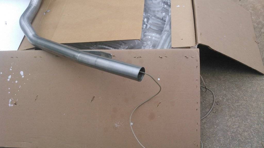

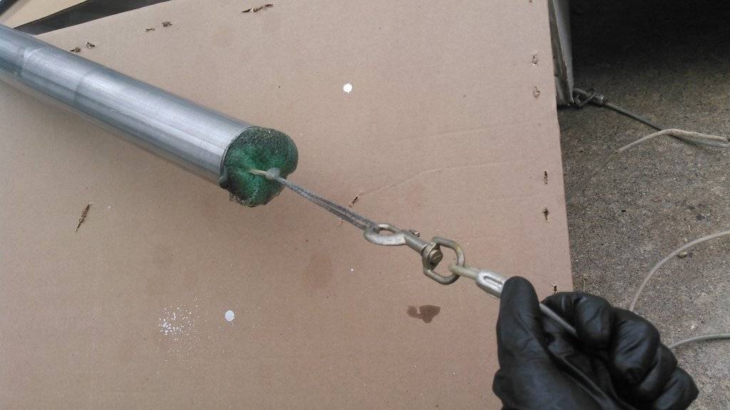

To clean: In case any wants to do this, you have to clean the inside of the pipes. I found the easiest way (after a few attempts) was to take a plastic bath sponge, fish a dog leash/cable through the pipe, attach it to the sponge cord, soak the sponge in acetone and pull it through two times.

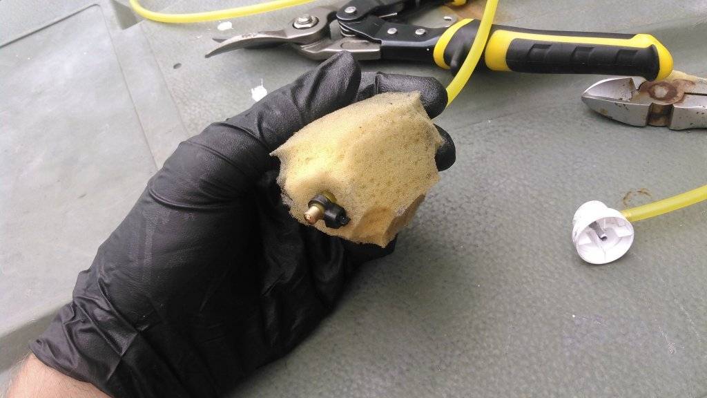

To spray: I made a spacer out of a sponge in order to keep the spray nozzle near the center of the pipe as I sprayed the coating. To get in the longer tube sections I used small engine fuel line with the supplied nozzle in the end. I used 2 cans and had enough to spray all of the external welds just FYI.
