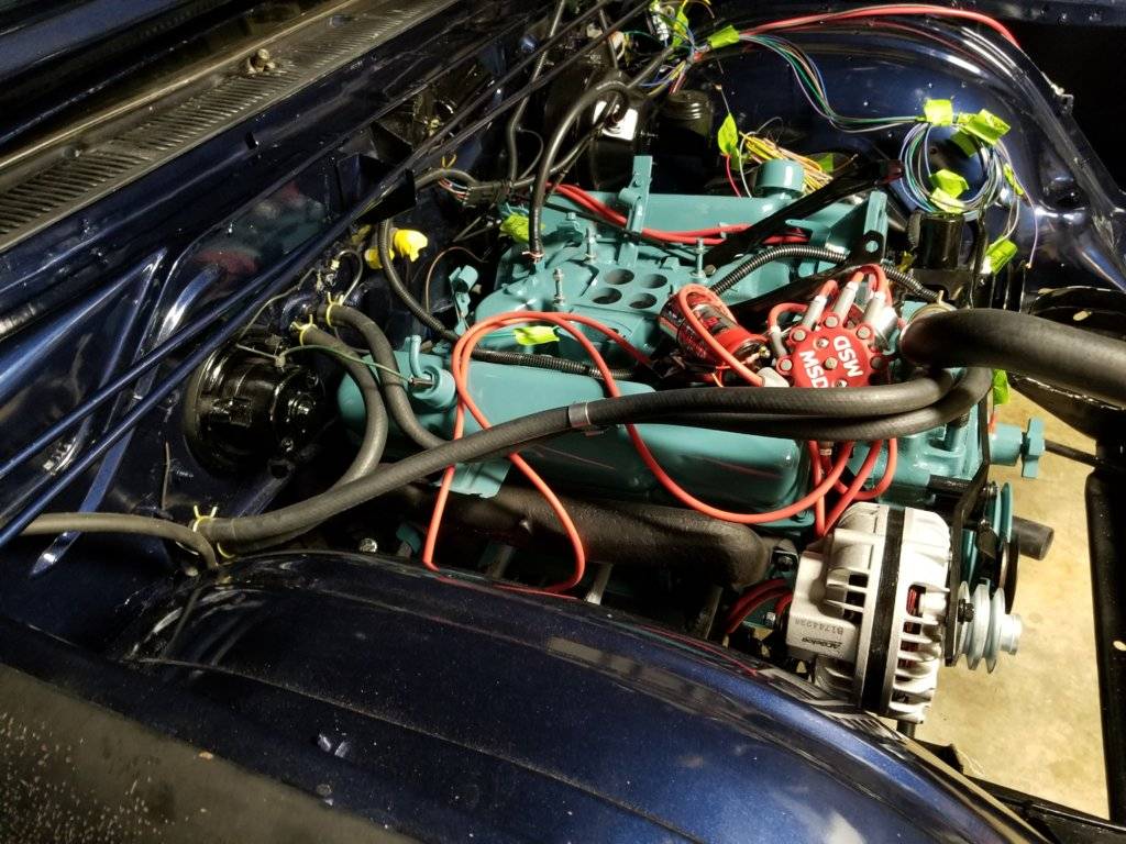

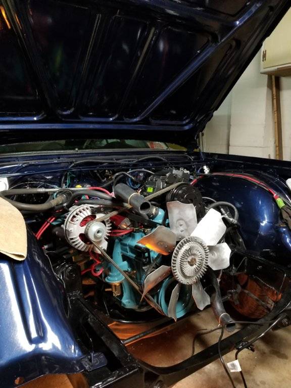

Hello All,
Just thought I'd post some pictures of my current project. My grandfather bought this '66 300 brand new in '66 for my grandmother and it has been in the family ever since. My dad and I are currently restoring the engine bay at this time. Please see the attached pics of our progress thus far.

Looking good, a lot of work to get it looking that clean! A suggestion, cover the open carb mounting plate holes, its too easy to drop stuff in there and it will go down to jam an intake valve or make it all the way to the piston and ruin your whole day. :eek:
Also, critters have been known to build nests inside of open intakes. Car is a beautiful color. Good luck on the restoration.

Actually have a clear piece of tape over the holes. Thank you though.

I notice your master cylinder is not the correct single reservoir single circuit disc brake master. They had an reservoir extension below the lid for greater fluid capacity, which you need.
However, a much safer, more easily serviced and less leak prone alternative is updrading to a later year 68 and up dual res - dual circuit disc master. Bolts right up. A minor plumbing change and a proper two in two out metering block and you have modern brakes. Just from the safety aspect this is highly recommended. Blow a brake line with a single circuit system = no brakes. Blow a line with a dual circuit system and you have the other circuit to stop you.
You've made an obvious improvement to your ignition system - make a safety improvement on your brakes. Brakes only seem to let you down at the worst possible time - when you really need them.
