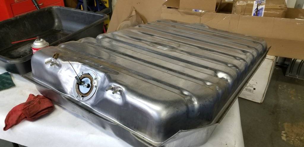

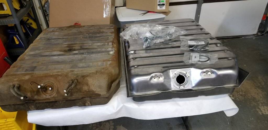

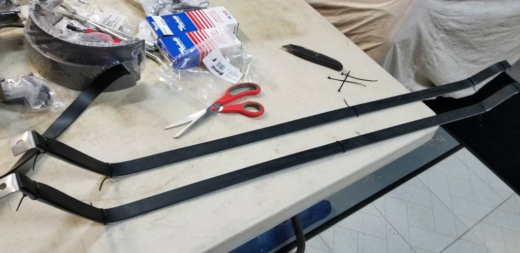

BTW , I reused the filler neck, and also the hold down ring for the sending unit. The new rings are not as thick, and I have heard they are prone to leaking because they can't be sealed as tight. FYI
