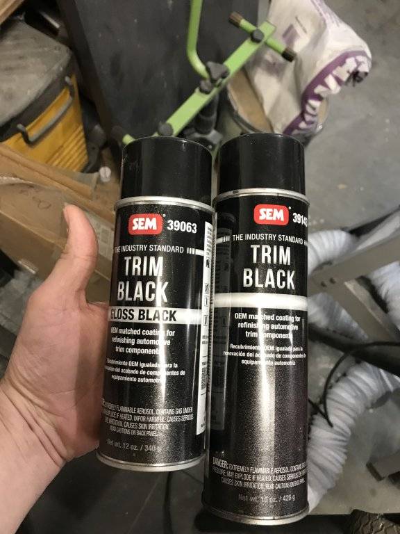

I had the same on my '68 Polara. I found that the SEM trim black paint worked the best. I used it on my chrome hood mounted turn indicators which were the most difficult. And I used it in the top of my re-chromed tail light bezels. You have to make sure it is cleaned really good with painting prep to make sure there is no wax or residue. You have to hit it a number of times with light coats. The first very light.

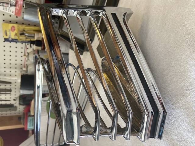

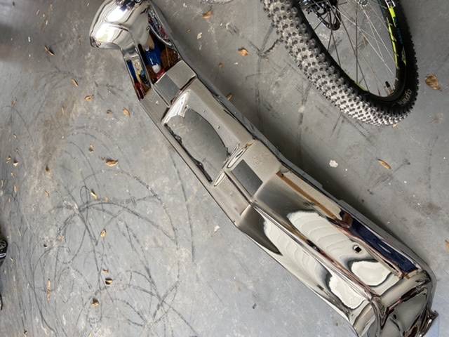

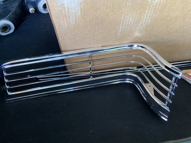

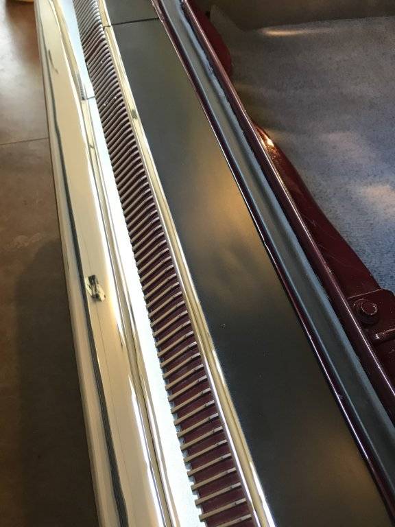

Sorry to have not broken that price down. It was $1020 for the bezels (they needed a good amount of work due to heavy pitting) and about $900 for the bumper. Also had very rough back-up light bezels and trunk lid trim in there.

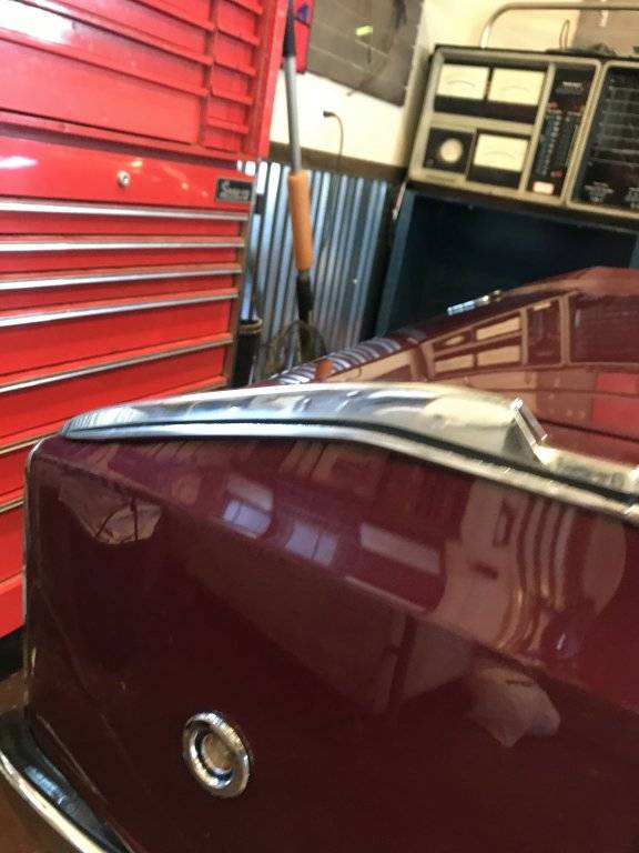

These will give you a general idea of their workmanship. Sorry about the double photo.
