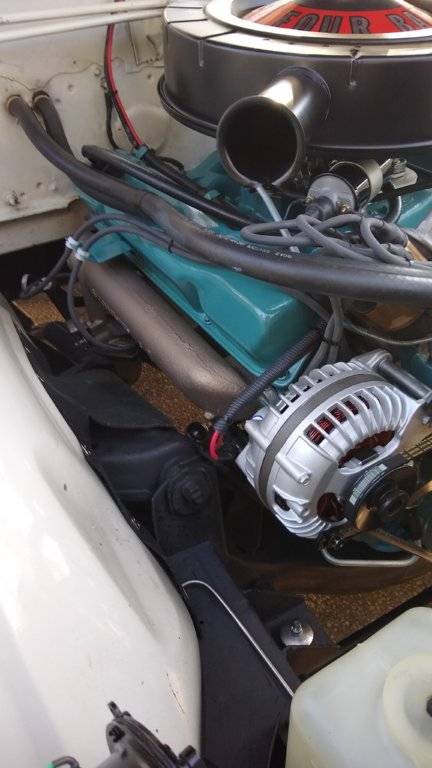

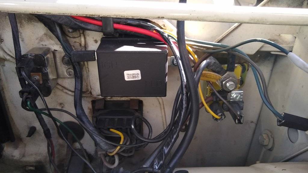

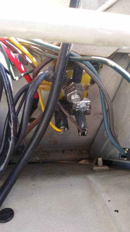

OK, in prep for the new ignition, I replaced the starter relay and cleaned all the wiring up. Took out the Horn relay, wired it out and polished it out. Looks new. Put in the 14 gauge fusible link and ran 10 gauge to the alternator for the by-pass charging circuit. What a must have that is. I can tell right away it was working as I got a solid 13.8 at the battery during normal idle. Before, I was in the mid 12's and needed to bump the throttle to get the charge circuit up and running.
No brainer mod that should be done to any car, regardless of keeping it OEM, just like the dual master cylinder upgrade. If you have any intention of driving your car around. I'm much happier knowing all the current is flowing through a solid line, rather than a 50+ year old firewall connector with unknown integrity.

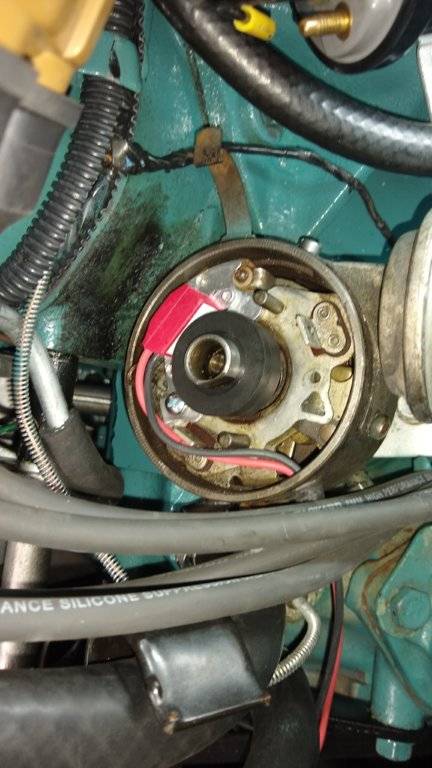

Ordered the Pertronix Ignitor II and the Firestorm II coil to match it up. Went with the epoxy unit. Seemed like the better choice.

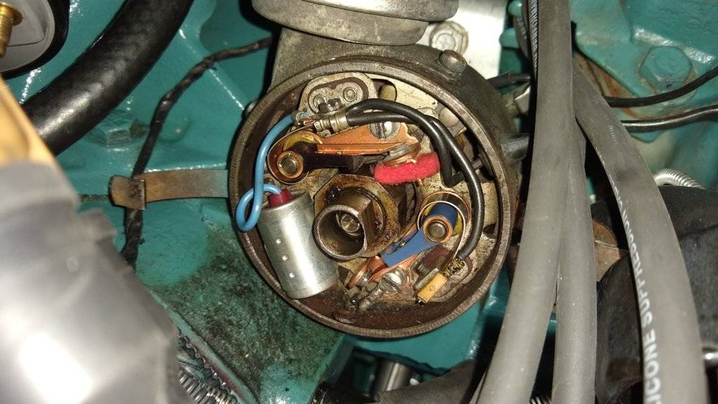

Had a Chrysler with a Pertronix that a previous owner installed. Car ran good but idled a bit rough. I found a bunch of play in the distributor because of worn shaft bushings. Changed the distributor housing from spare parts I had and the issue was fixed.

Ignitor II is in... And holy ****... She really came alive!! Lots of power out of her now. I'm satisfied so far. Added an NOS electric voltage regulator I found on eBay. Looks like OEM stock. Very happy with the change over. Was piss easy and made a huge difference in the power of the motor. Found my old points were worn out as well.
All I had to do was re-time the engine.
