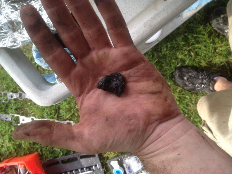

Oh it DEFINITELY is/was highly carbonized! Replacing the intake manifold gasket I found both center passages completely blocked with carbon the size of rocks on the intake and the block, I think they are called flow through passages or something like that. Picture of one of the chunks I got out of the intake manifold:

And do a good set of STEAL timing gearz an chain. Those plasiic gearz were only ment to last 'tween 80K 'n 100K from the factory on the 318s. With 143K I'm surprised you're not jumpin' teeth on that plastic gear set. AND CALK THE CORNERS WHERE THE PAN AND TIMING COVER GASKETZ MEET OR YOU NEVER WILL STOP THE LEAK, Jer
Thanks for the tip on the valve job! Until then I adjusted timing to 6 BTDC and it stopped the pinging under heavy load. Ideally it will make it through the summer without needing a timing chain. I will need to research what this entails before I dive in either way. I'd rather wait to do much more to the 318 until I get to swap it out with the 340 next year.
