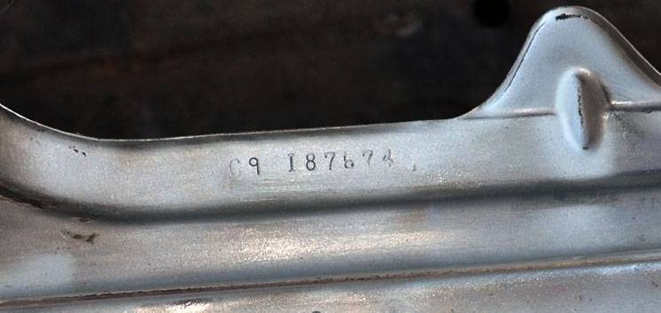

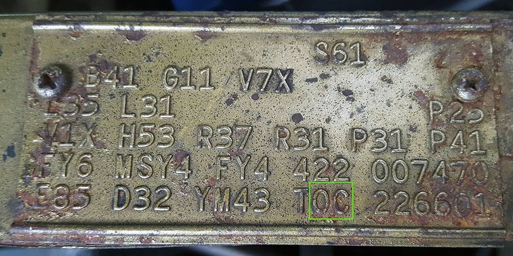

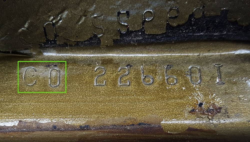

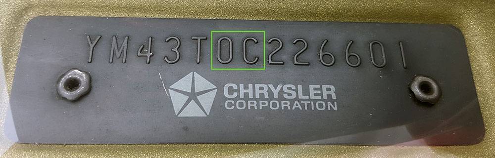

Have you ever heard of a mixed up VIN from the Factory?
I was pulled over by the Police yesterday for a "General traffic control".....
They checked the VIN on the dash and fendertag but told me they need to see a not "replaceable" stamped number on the chassis. After a lot of discussion, I ripped of a part of the trunk seal to unvail the stamped number and voila they found something to hold me for almost an hour... Two digits of the stamped VIN are mixed up. "CO" instead of "OC" on the tags.
Finally they let me go, but we had an hour of discussions and them back checking with the system.
How can this be?
The model year and plant order are interchanged on the body stampings compared to the fender tag and VIN plate. That is the way Ma did it for some reason............................
