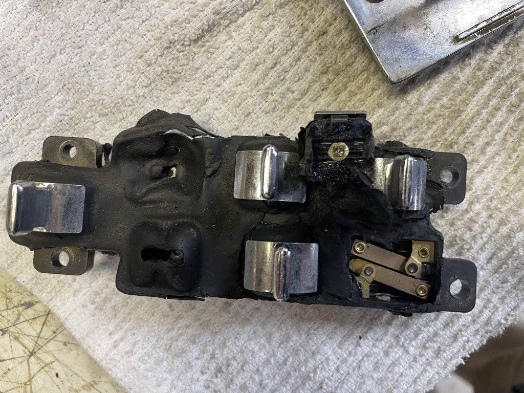

All was well with TB73 after the windshield install, went for some photos at the local park. When I returned to garage I noticed the left rear window switch was loose in it's mount. A reminder that it never ends.
This is the front drivers door 5 gang switch module.
Any input on a repair, parts or a replacement 5 gang switch module would be very helpful.
part #2926312
Thanks.
It looks to me that the loose switch has some prongs broken off it. Had that happen to mine as well so I'll call it a common problem. Unfortunately those are two small to properly fix so you'll have to get another switch handle. Also, there is a good chance that you lost the "springs" of that switch if you've held the switch body upside down several times.
The internals do look good as well as the backside so I'm betting all you need is a handle.

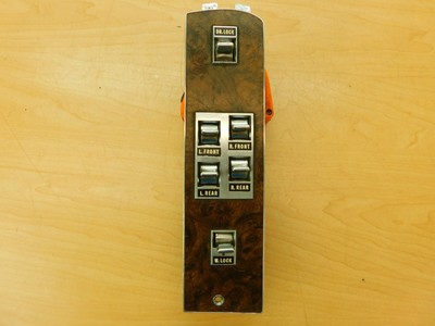

Those switch panels look great, but I have a 5 gang. 4 doors and door lock.

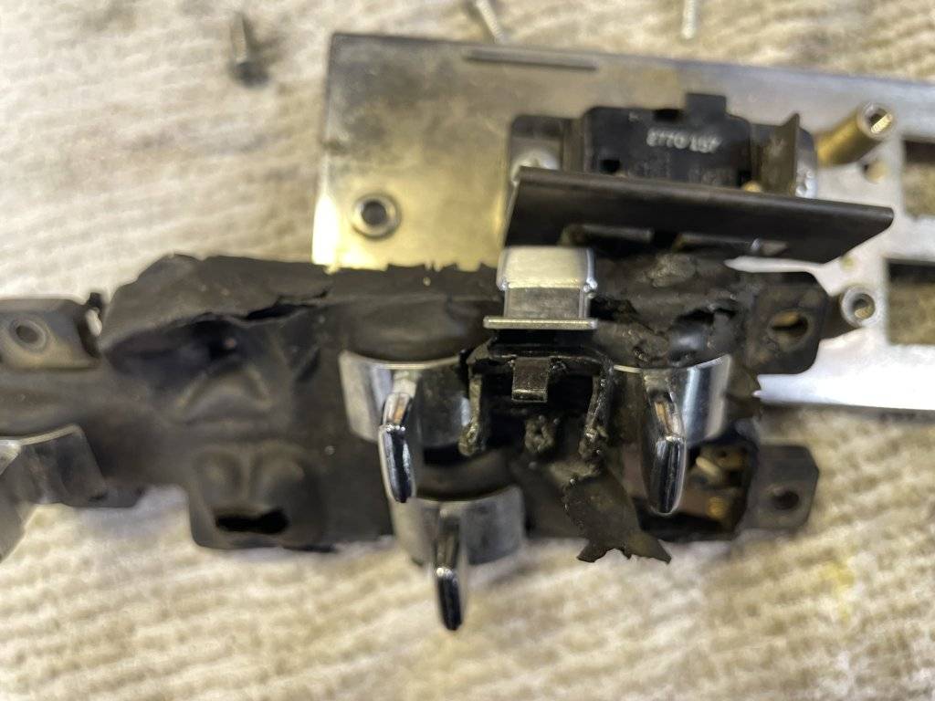

I will have a look at my broken switch. I might have one for you. Can the chrome be separated from the black plastic?
If you really don't mind to spare one, I'd be more than pleased :D. Have not yet startet to disassemble, so IDK.

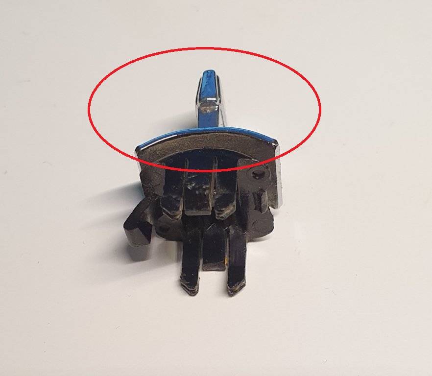

If your chrome 'toggle' is missing then chances are it is because the lower part (pictured) has cracked open. Almost any used one will do the same thing while trying to remove it from the switch body. Tight fit and very brittle plastic.
In my case just the upper portion broke off. I am just wondering that nobody seems to make them, guessing that these were used on lots of other Mopars as well. Mhh, maybe not
