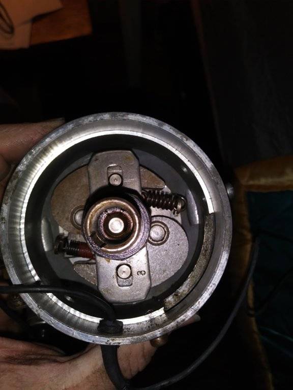

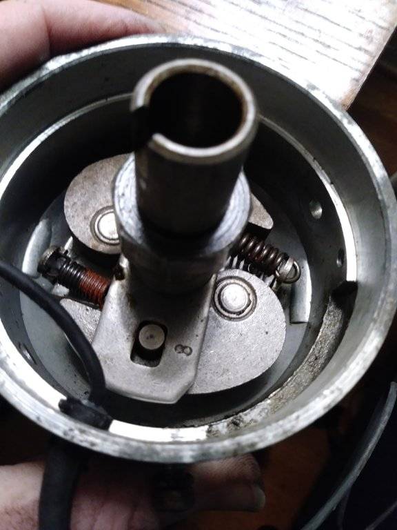

Ok. Took it apart...the play actually seems good. It was the rotor up and down play that worried me but it seems to work that way. It looks like new points will make a big difference. I'm concerned about the springs though. I have one small and one large on the mechanical advance..which moves freely. The large spring sits loose on the pins. Lie its just sitting there with zero tension until the weights are 1/2 way out...then it makes contact on the perches. Is that normal? Should it be replaced?
Ok...so obviously I know nothing about distributors and curves and springs but I found a few very good articles that explained it and even about the lash in my heavier spring being normal. I think I'm just going to replace the points and see what it does with proper timings now that it is all cleaned and spinning freely.
Try it just make sure you use a fan head on the points to hold it down or the arm will hit the screw. Just went through this with a guy that could not figure his out. Looked up the number it is a 66/67 440 4bbl non CAP distributor should be fine for a stock 4bbl motor.
I went ahead and replaced the points with blue streaks and condenser and cap and rotor. Set the timing by vacuum and it runs much better. I can barely get a signal from my timing light so I'm thinking weak coil. It seems to like about 15deg btc at idle and it took a long time to get it to idle decently at 700rpm. I think the carb needs some tweaking but it no longer dives when giving it gas and seems to run ok for 50 yrs old and 100k. I also put in fresh 93 octane non ethanol gas.
