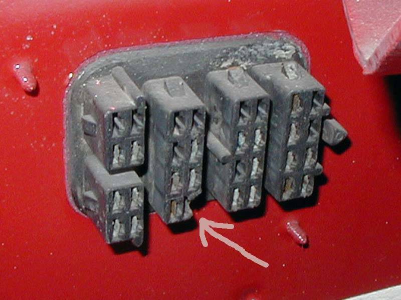

Mine did the same kind of thing, I replaced the alternator twice, the regulator without success. Turned out the battery feed thru the bulkhead connector was corroded and overheating.
Loose wire cause fires and melting of old connections.Just be mindful of the age of these components. Simple designs and age can be hard to troubleshoot. Hang in there.
All right, the problem continued so I checked the block as was suggested. I pulled all 5 of the connectors.
I saw one little bit of corrosion on the number 8 location. (It's on the bottom right of the second plug on the left in Fury440's picture above.) I cleaned the male and female connections and plugged all back together. Started the car and the problem was gone! Drove it yesterday around town to several different locations and all worked well, the power never stopped. I am sure hoping this is not temporary.

By the way, you have a lot more room around yours than I do on mine!!
I took that picture before the engine was installed, lots of space, now not so much!

All right, the problem continued so I checked the block as was suggested. I pulled all 5 of the connectors....
A question, though. According to the FSM, that #8 position is for the windshield wiper switch. How would a small amount of corrosion on that particular connection have caused the alternator to stop charging, or preventing it from doing so?
I hope all is well and the issue is gone for good this time. I personally think it wasn't cleaning the #8 connect that had any effect on your charging. For all intensive purposes you should be able to completely have that connector unplugged and the car would still run - as it doesn't complete any kind of circuit or mix in with the charging system. I do think when you unplugged all 5 of the connectors you might have loosened some trapped dirt, dust or debris. Or maybe the connector wasn't fully seated and wasn't completing the circuit. Which could explain why during turns or random days it decides to run fine. Physics doing its work.
