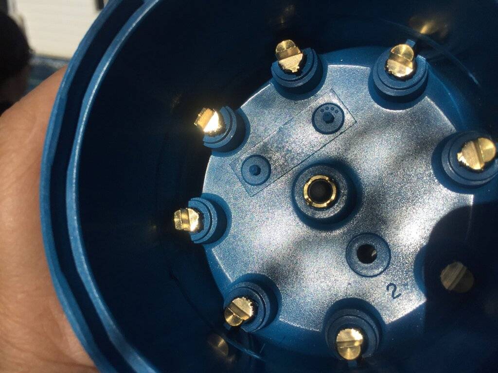

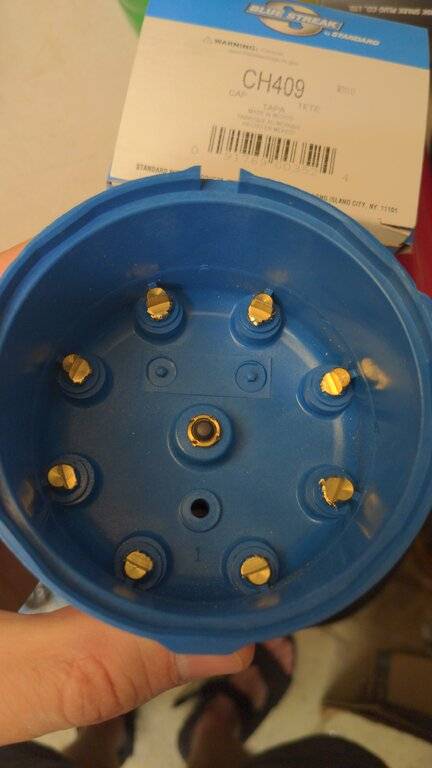

I picked up a distributor cap by Blue Streak today. It’s supposed to be the “premium” model CH409 but looking at the metal inside it looks very roughly made.
Not sure if the picture shows it but there is a lot of fine metal left that’s very thin and will undoubtedly break off; probably not a good thing.
Made in Mexico should not mean I have to rework it to make it useable.
The images online at OReillys show the same workmanship ...

The "BEST" ones have brass contacts, just like the points (if you have them). The cap shown looks fine. If the blue color bothers you then paint it on the outside.
That's not questionable, its a POS. Those burros on each terminal are begging to arc to the cap itself and cause carbon tracks. And the center terminal-a piece of tubing?
Return it.
If what you got bothers you, then return it. Otherwise, get a small screwdriver and knock off the bits of cuttings and plastic casting flash you don't like. Then blow things off with a strong "whoosh" or an air hose. Nothing there that should cause carbon tracks or similar, that I can see. I've cleaned-up new distributor caps before using them, even from Chrysler, back then.

I tried a Blue Streak Ch409, identical in appearance to what you showed us, and it DESTROYED 3 ROTORS in short order before I threw it away. NEVER AGAIN WILL I TRUST MODERN STANDARD PRODUCTS!!! They've abandoned the workforce which gave them a trustworthy brand i pursuit of short term profits, and now make a worthless product. Again, DON'T BUY THE STANDARD BLUE STREAK CH409!!!
I found some good NOS Made in U.S.A. distributor caps, and bought enough for a decade or so of use.

I just bought one too assuming it'd be a good and nostalgic choice. Mine is ugly too, would at least want to dress those down so it doesn't beat up the rotor.
But it's dangerous to say on a forum here to not trust anything made after 1980. For the sake of people young in the hobby reading this, I've built plenty of reliability and performance into my cars with modern parts and recently manufactured replacement parts. There were plenty of bad parts in the old days too.
