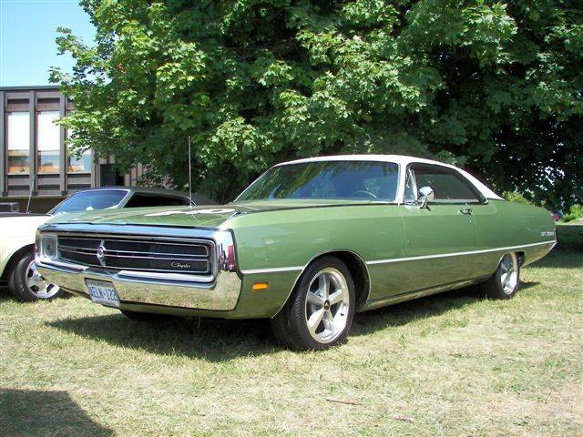

here is my car-I was a member before I moved out east. I had to leave this car stored at my fathers place (only had room for two Mopars in my new garage). Anyhow the rad is toast. I have the guys at National Moparts looking for one but I wanted to see if anyone here knew of a place
Is yours beyond putting a new core between the tanks? The car looks so clean I'd have a hard time believing that the rad was in too bad of shape to recore.
Very nice 300 you ave there!
Are you wanting to stay OEM/original? I not then you could always order up an all aluminum unit from Champion radiators out of California.
My vote to Champion's as well, I have one in my 300 also. No heat problems any more. :eek:ccasion14:
I'd have to have oem, I just can't get over how out of place an aluminum unit looks under the hood. What size and part number? I know a guy that that has a '69 C body unit available.
Very attractive 300 you have there. I hate most green colors, but I hafta say that green is beautiful. What color is the interior ?
