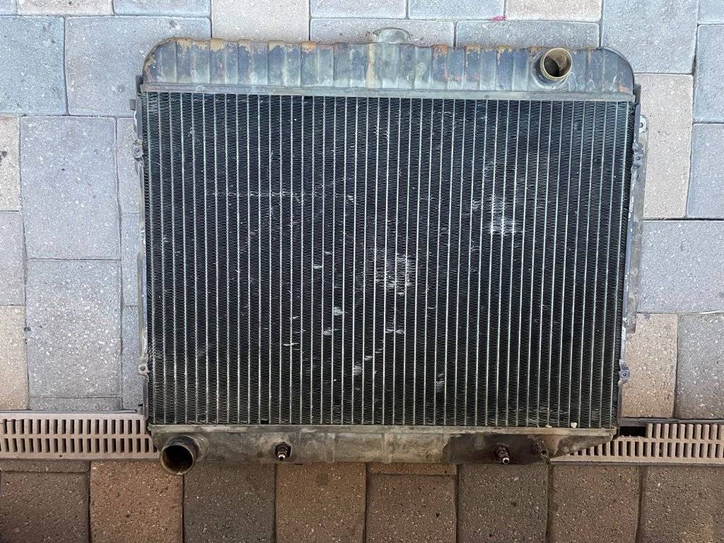

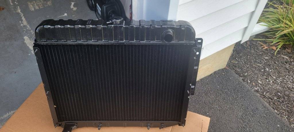

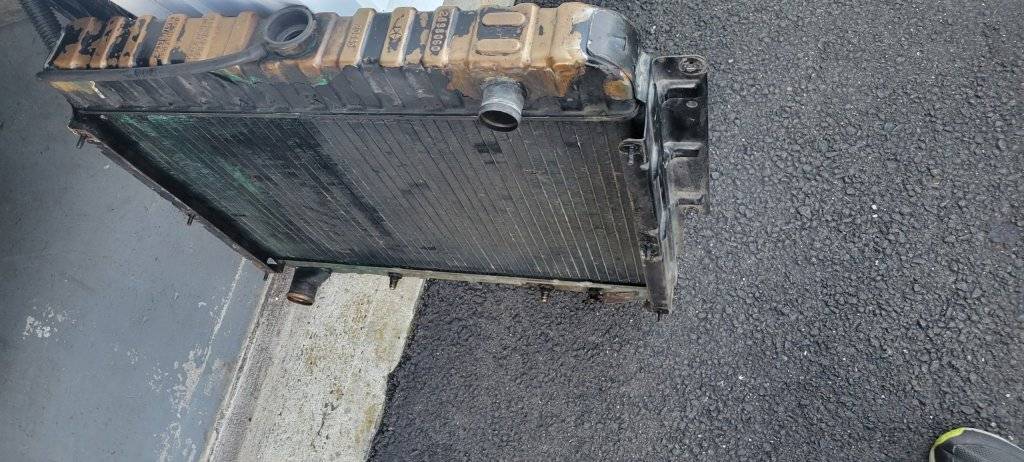

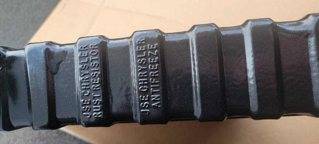

Well, the radiator was in worse shape once we got it out of the car. I hadn’t really paid much attention to it since it hadn’t been losing antifreeze. The car also never ran hot. $625. Plus tax and 10 days at the radiator shop and it is ready to go back in. Here are before and after.
