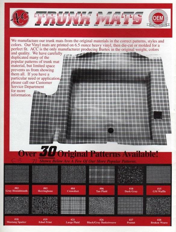

This is one of my biggest pet peeves. Vendors selling incorrect items as being correct for our beloved C Body cars. ACC is not the only vendor but I happened to have an old catalog page showing the different patters available for all cars, not just MOPARS and thought that posting it would be helpful.

I know from being a stocking vendor for both ACC and REM, if the customer wants his trunk mat made in tan plaid and the general opinion is that they were gray plaid, it is no problem to have one made up in the requested color. It may take a couple of days to get it cut, but that availability it out there. The problem is that some of these vendors are basically just drop shipping product from some other vendor and have no knowledge of the product or they made a bulk purchase of a certain style and that is what they are trying to move.

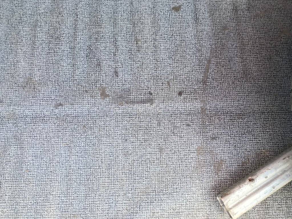

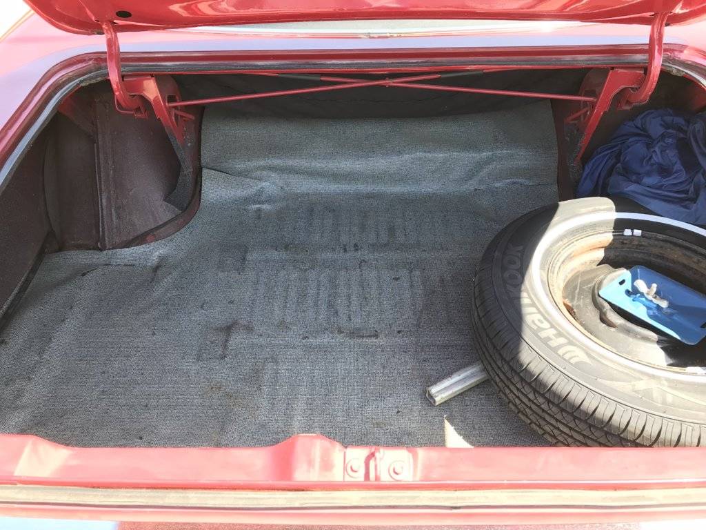

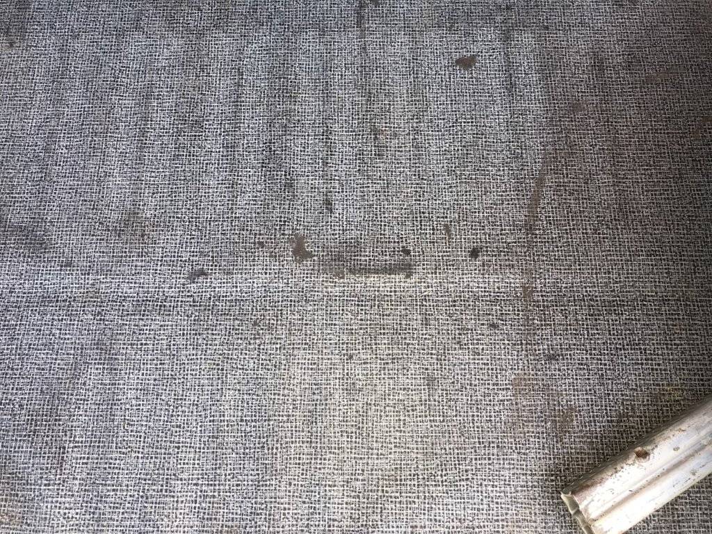

Here are pictures I took this morning of the original mat in my own all-original 1970 Polara 'vert. The first two pics are in natural light, the last pic is with my iPhone flash on (to show the pattern better).
I'll let you know if the mat that I've ordered matches -- doubt it, and I have only myself to blame.

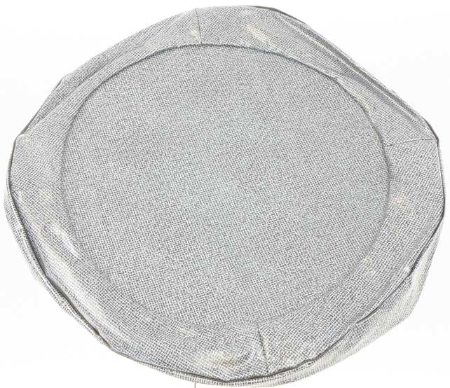

If anyone knows a firm that makes a spare tire cover with the same material, or if anyone can comment on / share experience with the ClassicIndustries items I'd listed above (likely non-original, but helpful to keep things clean), then I am all ears:
1960-1976 Dodge Charger Parts | MD4049 | Mopar 15 Herringbone print Spare Tire Cover | Classic Industries
As an aside, the first photo in my latest post above (#18) shows that I have replaced the original double-stripe spare (which was in perfect shape and very clean even though it seems to have been used once in its life, given the 4 small stones embedded in its grooves) with a new spare matching my other 4 new tires (Hankook Optimo H724 | P225/75R15 whitewalls). I'll keep the original carefully at home, and in case I have a flat, will be able to continue with a safe-to-drive spare.
