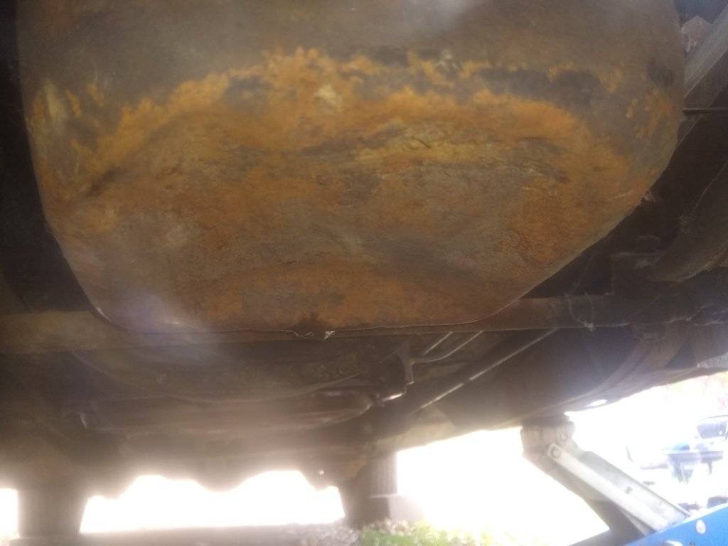

    1965 413, any old school ways to remove this dent it's pretty big. doesn't need to be perfect just needs to get the motor some oil.
    no real access inside through the drain plug, I was thinking maybe welding some bolts on the pan and pulling on those? I've never tried it tho.

    Does it not get the motor some oil as is? If it does I'd leave it be. I've seen much worse dents in sumps that performed just fine.
    And that pan's steel is damn robust, so bending it to shape without removing is impossible, IMO. And do you really want to weld bolts/nuts to that pan, what with oil inside (even if you drain if for days, oil will linger in the pan, especially a dented one like that.
    Leave it be.

    I would take the pan off and pound it back out from the inside.

    The oil light flickers, no noises. The picture doesn't really show how bad it is
    This is my winter project, so I'm almost ready to start test driving, but I'm worried about the dent. I really don't want to remove if it, if I don't have to
    Maybe some type of industrial epoxy for the pulling bolts?

    Given that oil light is flickering, that has nothing to do with the dent, the pickup sits near the bottom of the pan as it is, even with a big dent the pickup is still able to take up oil. I'm thinking the pickup may be blocked or your oil pump may be worn. The pickups do fill up with gunk.
    Taking the pan off will take a couple of hours but doesn't require any special tools or skills. Firstly disconnect the draglink under the pan to give you some clearance, then undo the two bolts that hold the engine mount rubbers in place. The drivers side bolt is accessed from behind the mount in front of the starter motor. The passenger bolt from the front side of the mount under the alternator. Then place a block of wood under the harmonic balance and jack up the engine slowly a few inches, then getting the pan out is relatively easy.
    Thus you can check the pickup at the same time as seeing what crud you may have in the pan. Also look for chunks of little yellowed plastic, if you have that, then you will need a new timing gear and chain.

    1. Oil light flickering probably has nothing to do with this dent. Is enough oil in the pan to submerge the pump pickup? You should consider installing an inexpensive OP gage, either for temporary diagnosis or permanently under your dash like many of us do--Volts/Water Temp/OP. Screw a 1/4" NPT Tee into the block and you can have your light and your new gage.
    2. There isn't an industrial epoxy in the known universe that will stick to that pan and allow you to pull that robust steel pan back to shape. IT'S THICK STEEL!
