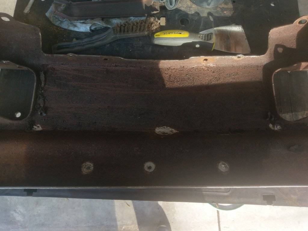

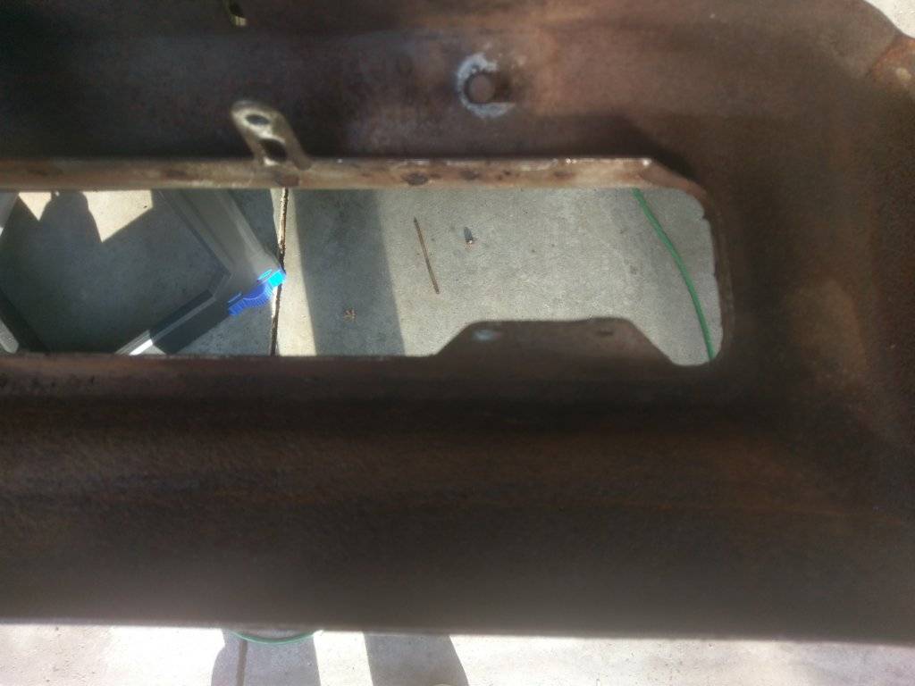

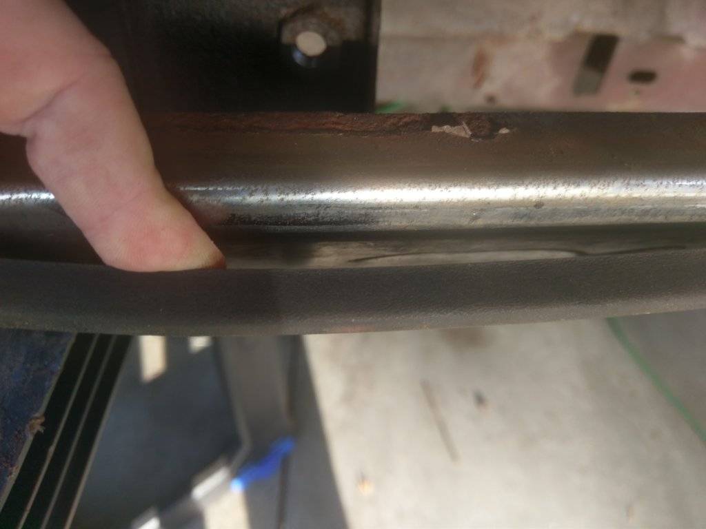

    here are pictures from back of bumper, cannot see any type of fastener. only section I have been able to losen is shown. I think this may have been due to heat needed to remove one of the carriage bolts

    Well I don't see a bolt, that's true... All I could say is try to get that putty knife behind it. You'll either slice through adhesive or find a fastener. If someone has an exploded view from a parts catalog, that would help I guess?

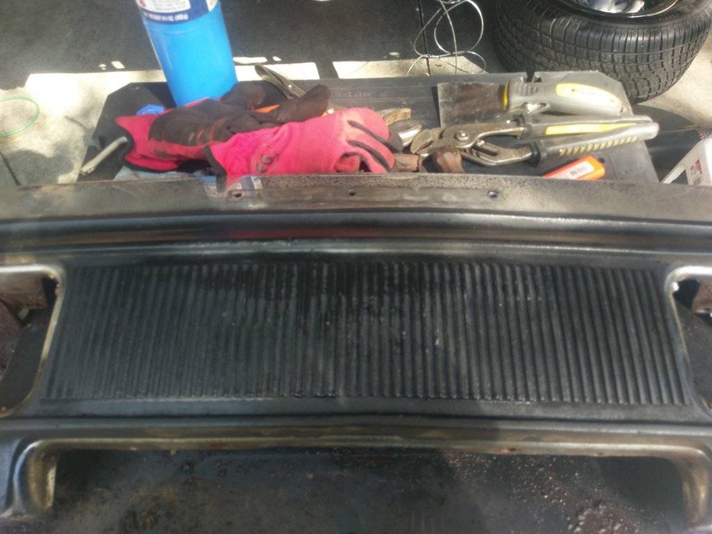

    Please post a picture of the bumper showing the strip.

    While I don't know for sure, the common sense person in me says there's NO WAY that isn't held on without integral studs that are cast into the applique, and that those studs poke through to the back side of the bumper and are held there with nuts. However, I could be completely off on this one.

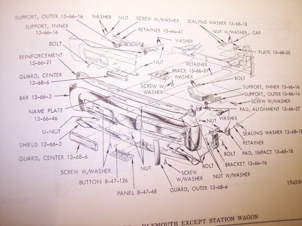

    Here is a photo of the applique from the 1972 Parts Manual. The photo I took is pretty clear and from what I am seeing, it is hard to conclude that there are studs on the back of the applique that are used to mount it that I too was suspecting -
    Also, in the part number pages following the parts drawings, each bumper (bar - 13-66-3) with a different color applique mounted on it had its own different/unique part number, so I conclude that appliques were indeed glued on the face of the bumper (i.e. if the appliques of different colors were mounted to each bumper with nuts, the bumper (bar) itself would have had only one part number and each applique of a different color its own number separately). Also, just in case you were wondering, the vertical guards (13-68-6) in the photo were used only on the non-PP models without the applique.
