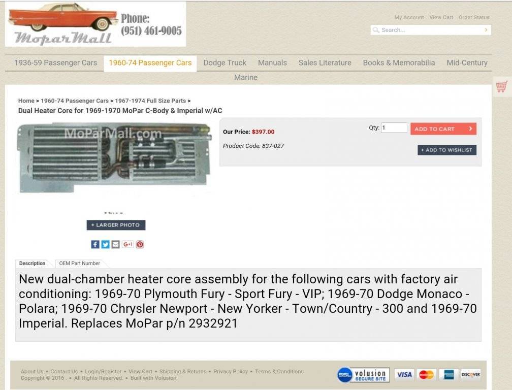

yup, not RockAuto and I'm not sure what the picture is as it doesn't look like the one in my 69 with AC, and I doubt I could fit the one pictured.
As far as I know the 70 uses the same core as the 69.
Alan
Many times we have seen stock photos used in the item's description.
Only a phone call can confirm.
Rockauto does not sell them, I just looked. I was curious as I had not seen them there before. I juts looked at that Mopar Mall site and saw the same one as posted above. $397.00 - yikes!

Rockauto does not sell them, I just looked. I was curious as I had not seen them there before. I juts looked at that Mopar Mall site and saw the same one as posted above. $397.00 - yikes![/QUOTE
CHRYSLER1966NEWPORT6.3L 383cid V8Heat & Air ConditioningHeater Core
Price
SPECTRA PREMIUM / COOLING DEPOT 94500 {Click Info Button for Alternate/OEM Part Numbers} Info
w/o Air Conditioning
$39.79
APDI/PRO 9010338 {#2521117, 2521268, 3579171} Info
without Air Conditioning
$50.79 Looks like they boosted the price a dollar since my purchase. If it's smaller than the 69/70 core, maybe it could work. Put the heater core in the housing. see what it would take to seal it. Figure out what material to use. 50.00 investment + 30 day return policy.
