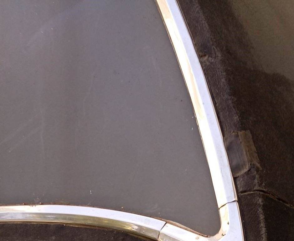

Replacement Roof panel information for a 1970 Plymouth Fury III 4 door hardtop C Body

Also would be best to peel your VT and get the glass out, to determine how much you need from the donor car.
