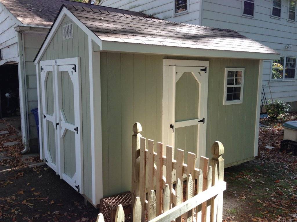

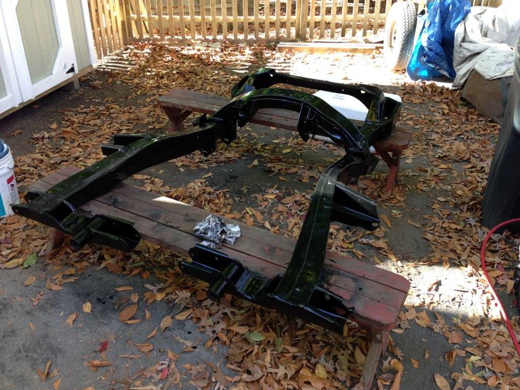

I thought I was done for the season, but this stretch of nice weather here in the northeast had me out in the yard again. First, I had to put the finishing touches on my new parts shed (ok, garden shed to my wife...). It was a lot cheaper than a garage extension or renting a storage unit.

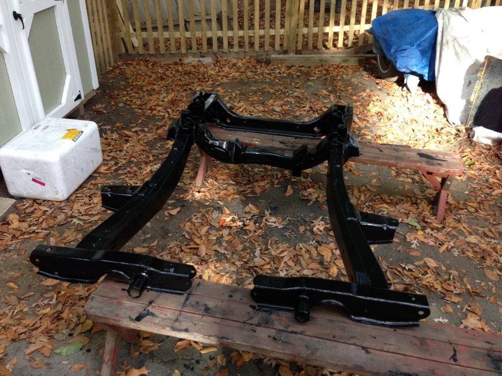

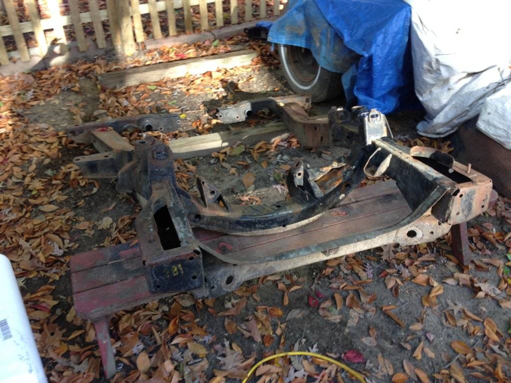

Originally I was going to refinish the firewall, but the instead I opted to prepare the new frame for the winter.

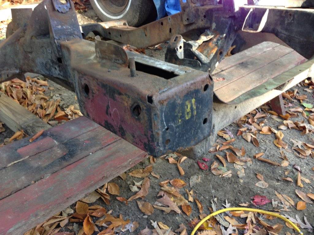

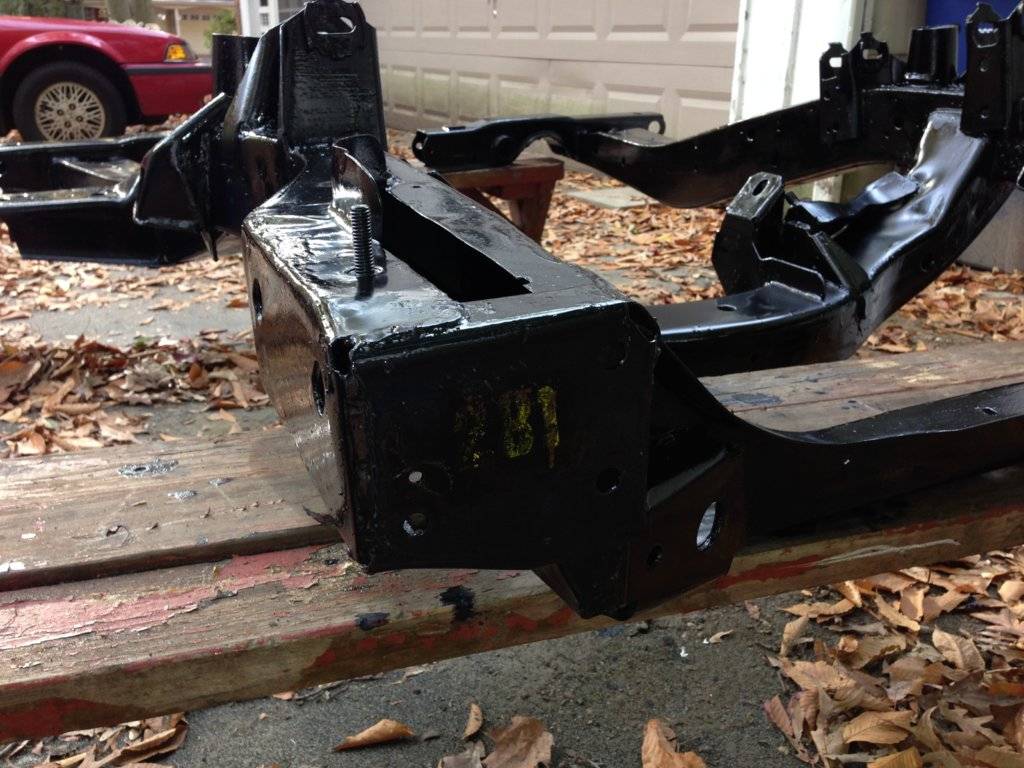

In cleaning I uncovered these inspection marks, I though it would be cool to try and preserve some of them.

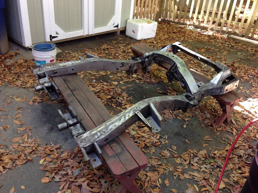

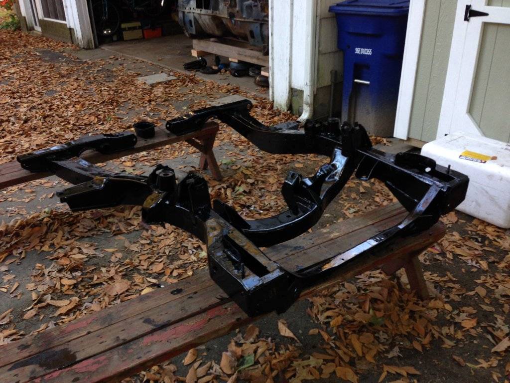

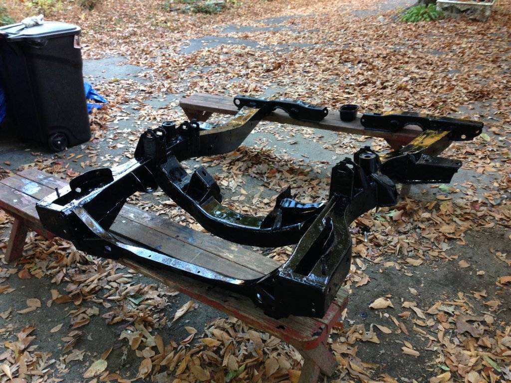

Four hours of grinding and sanding revealed a very solid unit.
Then a top coat of POR 15 will keep this thing fresh looking for the rest of my lifetime.
I was able to preserve some of the inspection marks:
I will be removing all of the suspension parts from the old frame over the next few weeks provided the weather continues to hold out. If anyone has a need or an interest in the bent frame, let me know. It is rust free and very solid, I'm sure someone could straighten it with the right tools and dedication. This project is entering it's 6th year and I just didn't want to bother. Oh, and of course the frame would be free to a good home.

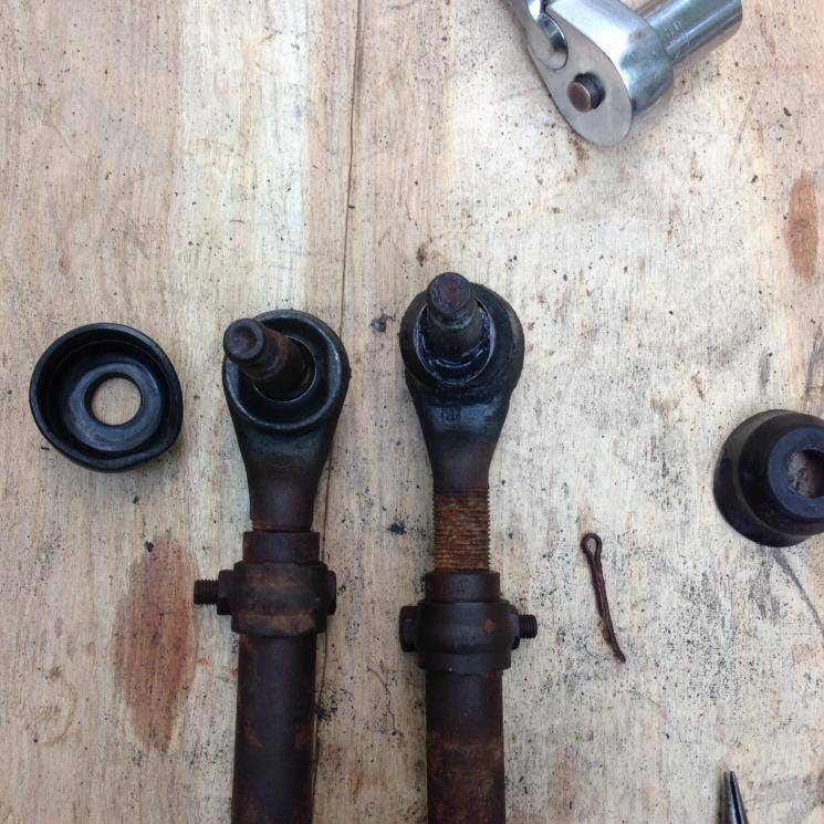

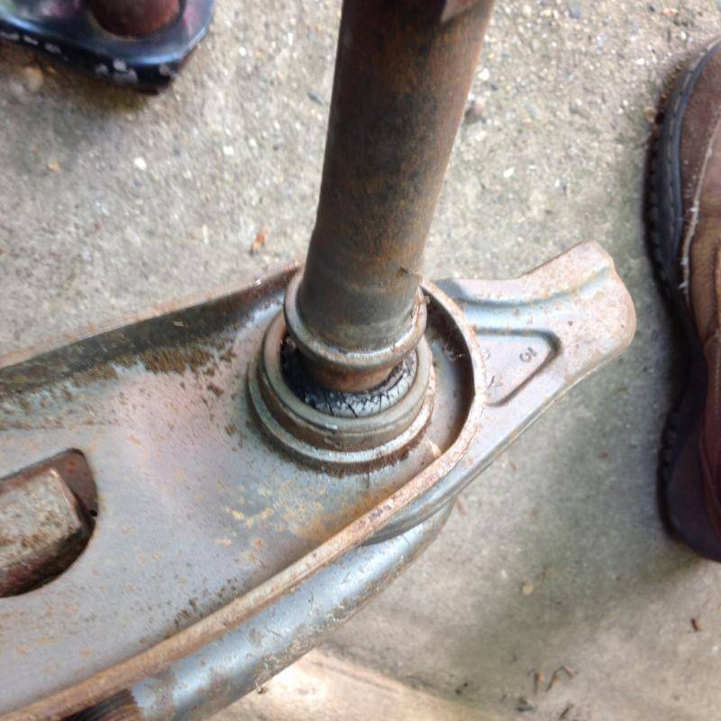

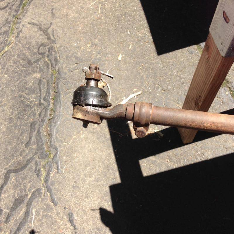

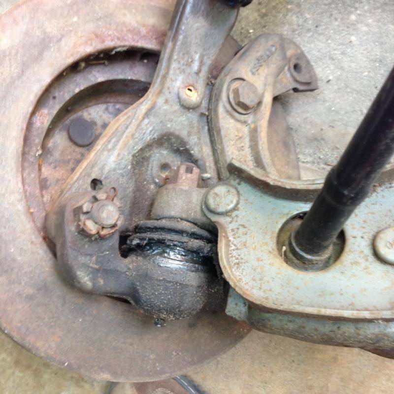

Finally getting some time to get back to work on the vert. Last year I had stripped the suspension components from the old frame. I believe the suspension had been refreshed with some new parts before the project was scrapped by the original owner back in 2006. It has new rotors, wheel bearings, control arms, A arms and bushings. The plan is to transfer the parts as is, but I'm not to sure about the lower ball joints or tie rod ends. The tie rods are tight, but the rubber boots are decaying. The lower ball joints just look flat and move easily.
