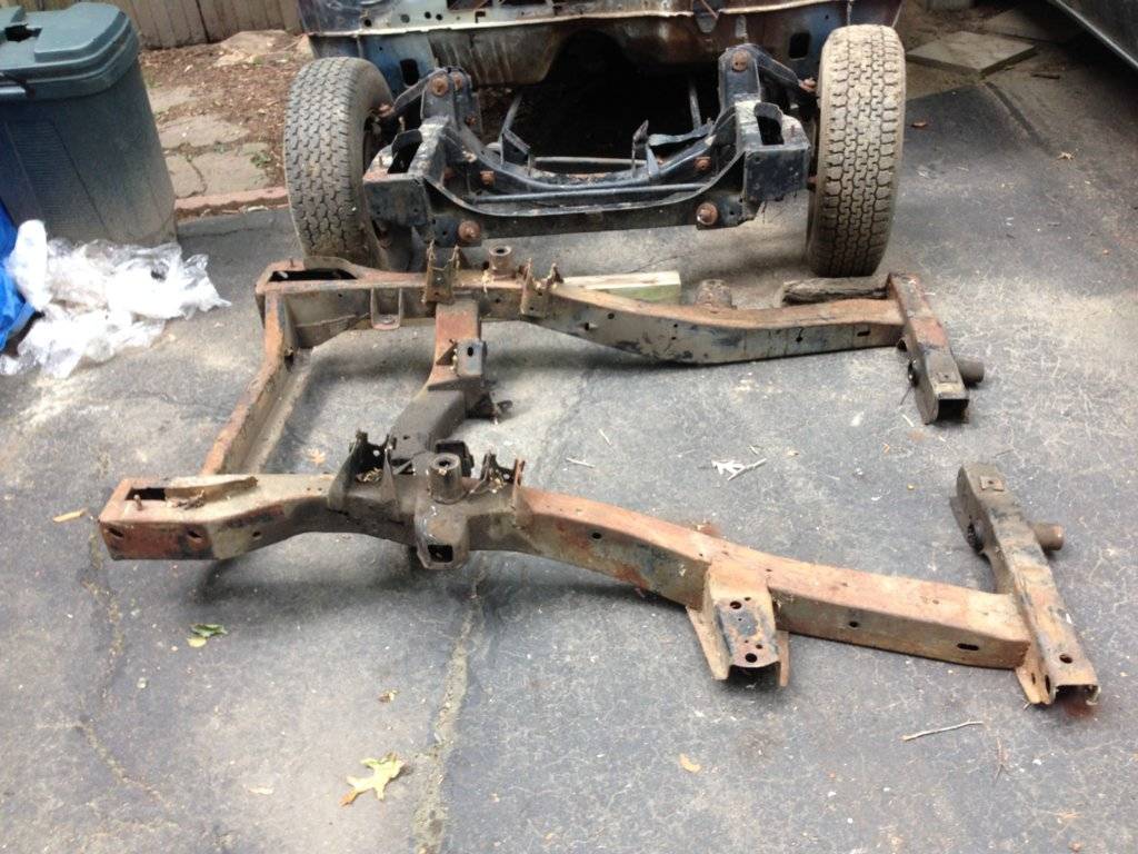

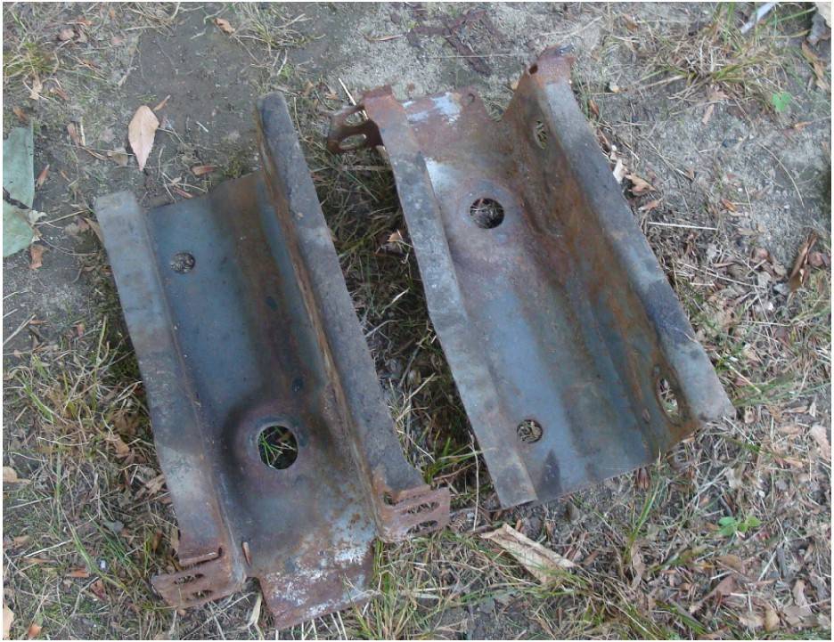

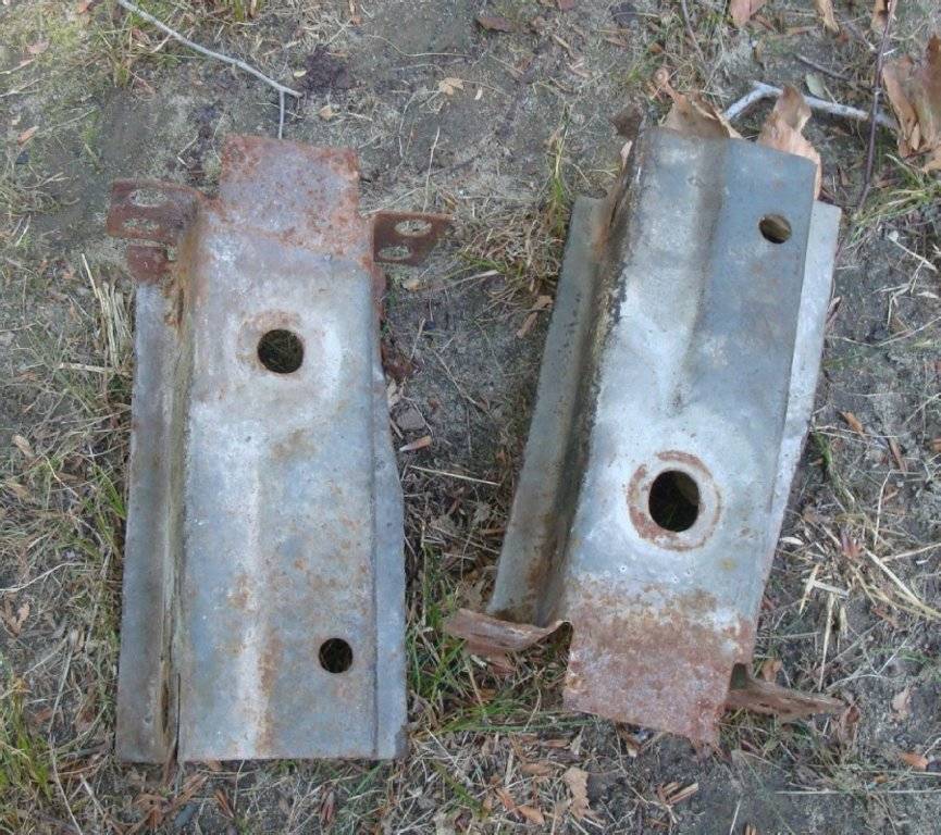

I'll have to crawl under there and get a picture, but it is also outlined in the FSM. It appears that the on the hardtop the mountings extend past where the "outriggers" are on the convertible and mount into the floor with isolators. The convertible does not appear to have any such isolators, but mount to rockers via the "outriggers". Here is a photo of two outriggers that I had in my parts box:
I think further investigation is needed regardless, but it does look like they are different.
Jim is correct about the subframe being different between hardtop and a convertible, they are different! The part number for the frame of a 1970 hardtop is 3417 199. The convertibles and station wagons do use the same subframe, the part number for that is 3417 198, they do not bolt up the same as the HT. If you truly need a frame you can get one from a donor Fury, Polara or Chrysler station wagon so you're not limited to just a convertible donor. The inner fender wheel houses are also different between the hardtop and the station wagon/ convertible. It is possible that your friend used a subframe from a station wagon in his convertible but definitly not from a HT.

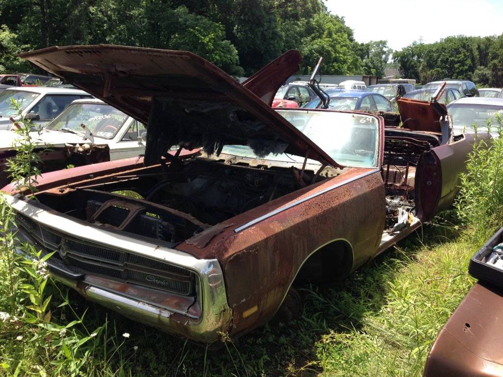

In my search for a serviceable stub frame I discovered a salvage yard in Newtown, PA that has a 1969 300 vert.

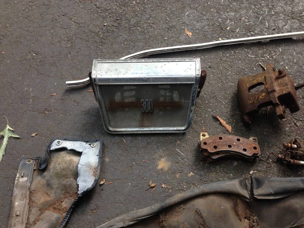

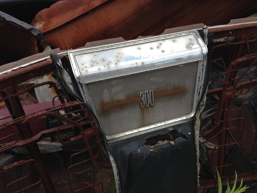

Of course, the stub crumbled in my fingers as I reached underneath to check it's integrity. However, I did spot some parts including this rear-seat speaker grille in better shape than the one I have.

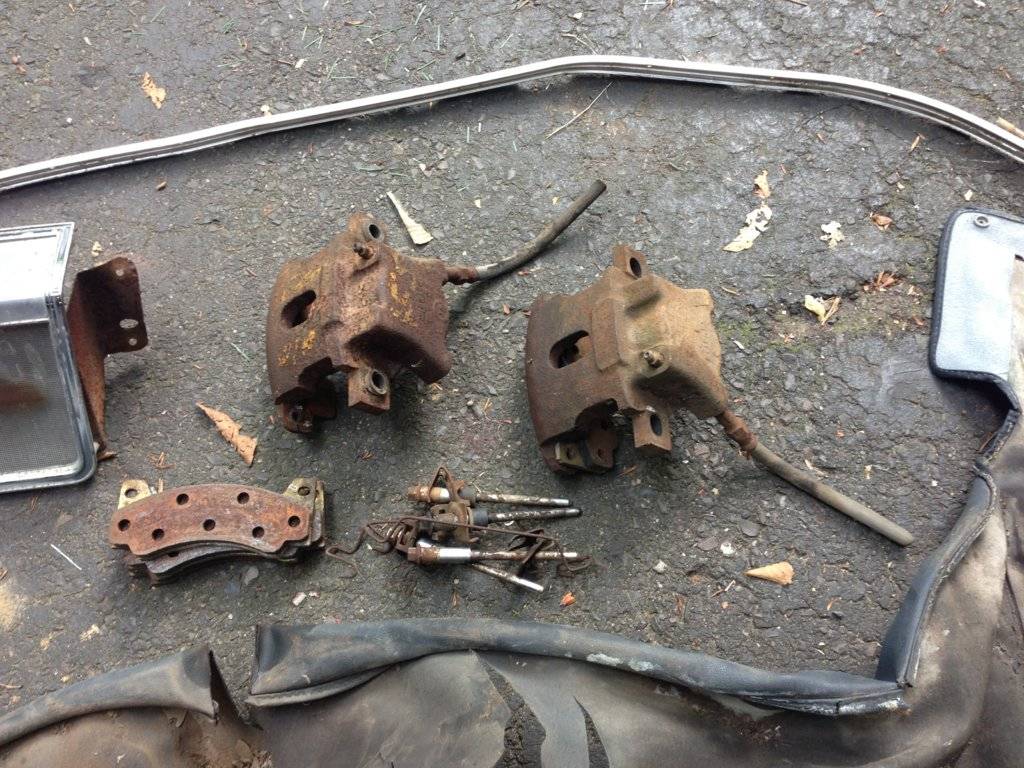

Next to the 300 is a 71 Polara 4 door. I didn't get a pic of that (sorry Dave, the bees were crazy that day), but I did manage to pull a couple of calipers. Also picked up a parade boot from the 300, and although it was in tatters I pulled all of the little clips out that are always broken.

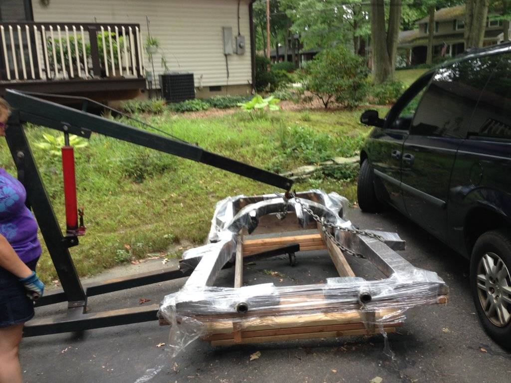

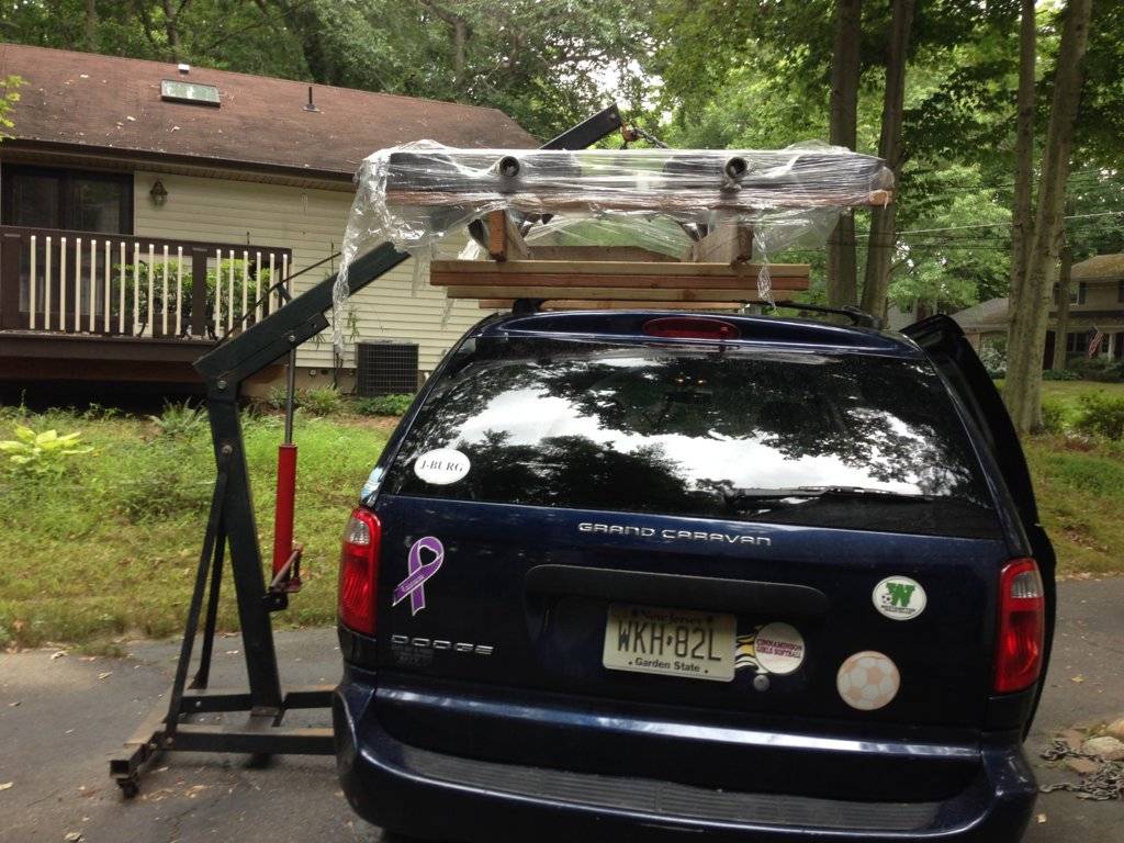

Still in need of a stub, I began my search once again right here on FCBO. As luck would have it, Alan (MrMoparCHP) listed a stub frame FREE! Only problem of course, it had to be shipped from California to New Jersey. Alan went above and beyond in my effort to get it shipped including delivering it to Fastenal! Thanks Alan! Also a big shout out to 3rd Party Logistics who handled the transaction. It was by far the least expensive transport for less-then-full truck load freight.

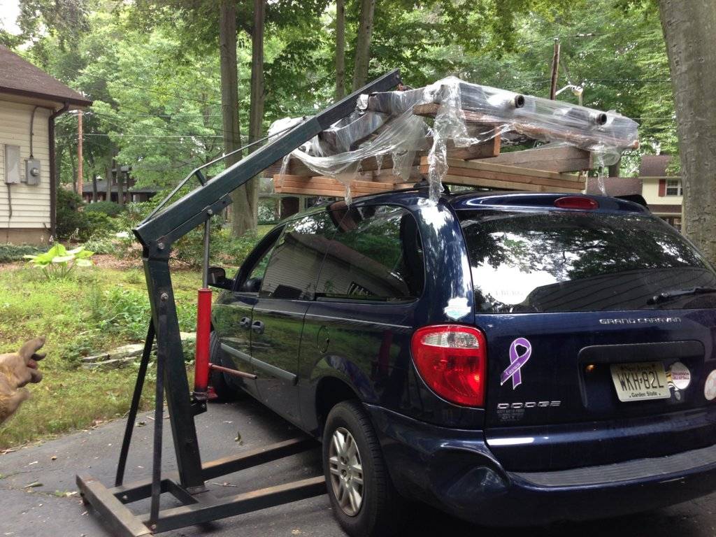

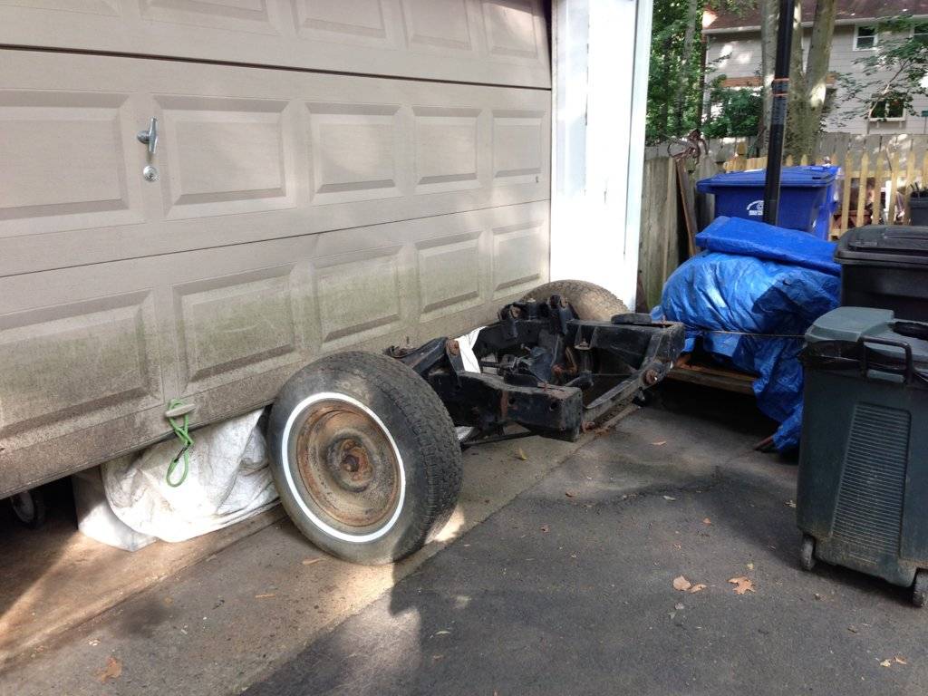

It took a few weeks, but I finally got the call while I was on vacation that the frame was ready to be picked up. I don't own a truck, but with a little creative driving the mini-van managed the task.
Ok, now it's here, how do I get it down off the roof?? The crane! The crane!

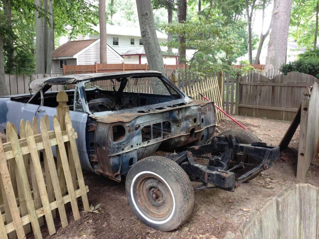

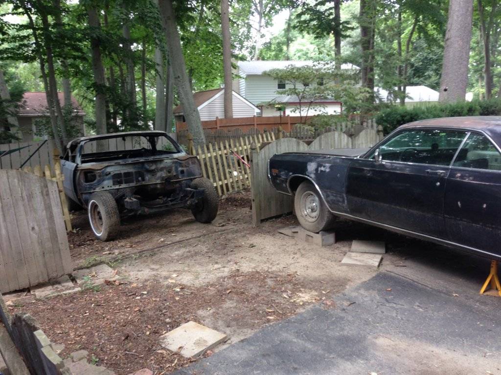

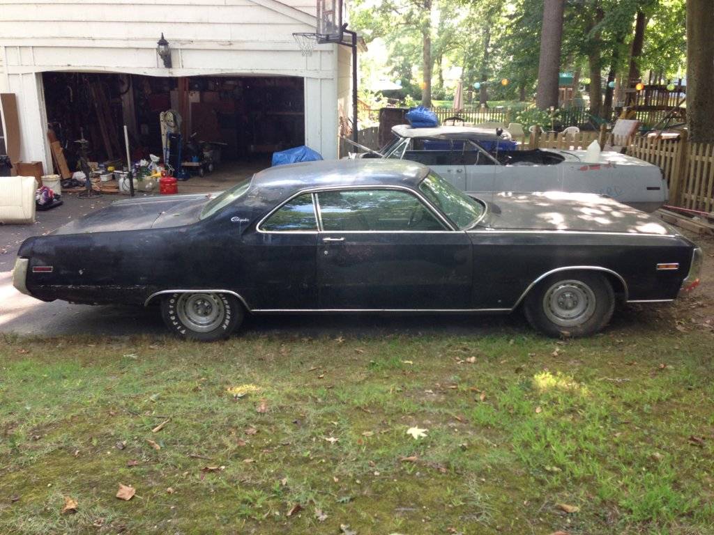

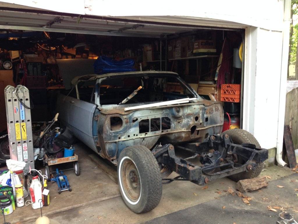

Finally, after 5 years it was time to move the vert out of the back yard and into the garage. We needed a new fence anyway, so no better time than the present. I also got the chance to expand the driveway back another 8 feet. Never know when another C-Body will appear.
Steady as she goes....
I probably should have moved the car before installing the posts for the new fence. Between the uprights...it's good!

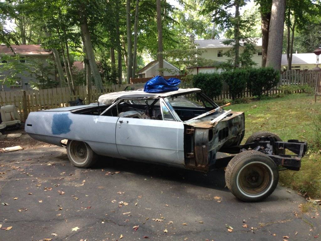

Two peas in a pod, with the new stubby.
