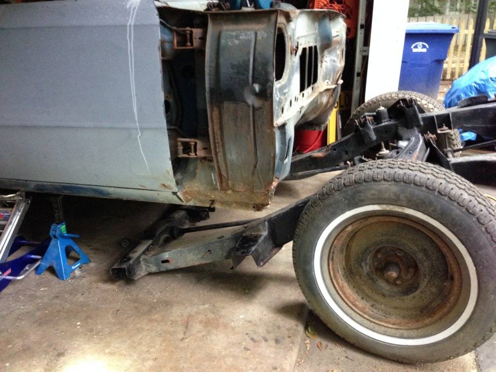

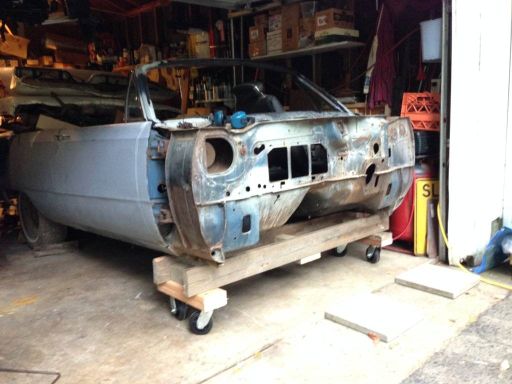

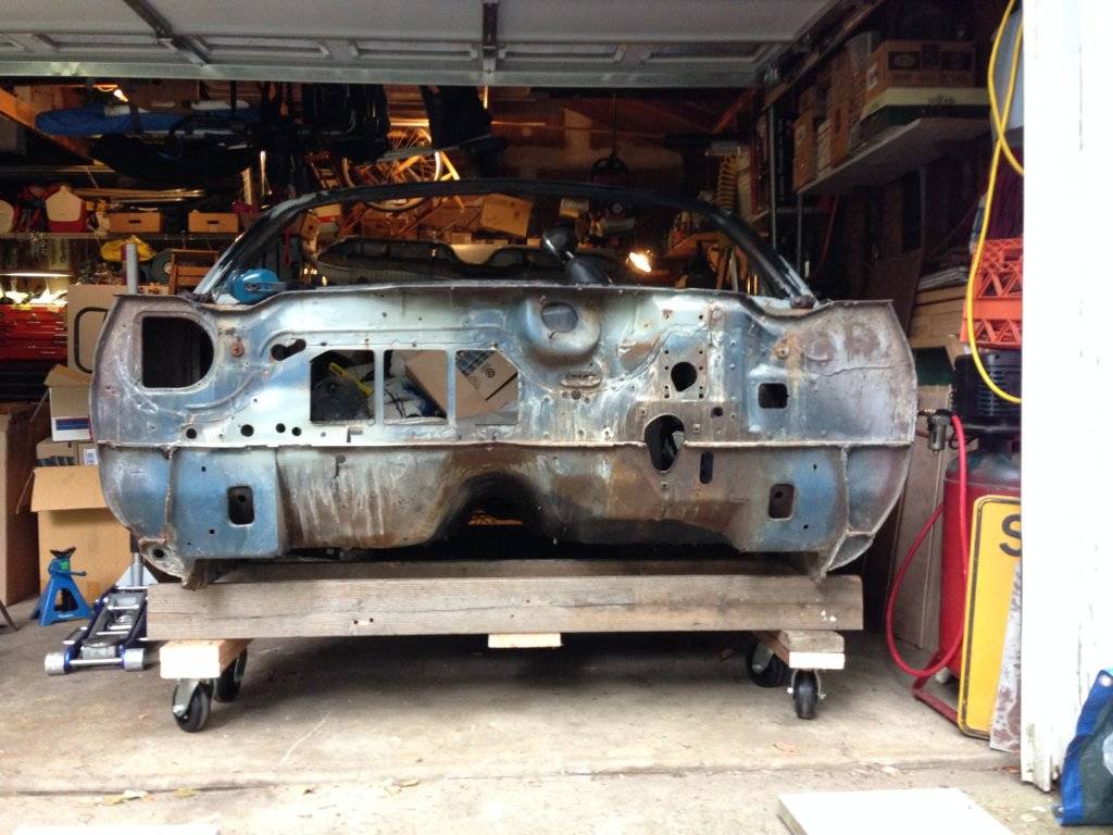

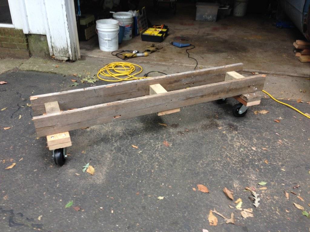

Next step for my "winterization" was to be able to close the garage door, so I needed to remove the stub frame. First, I created a dolly that will support the front and give me the ability to roll the carcass freely:

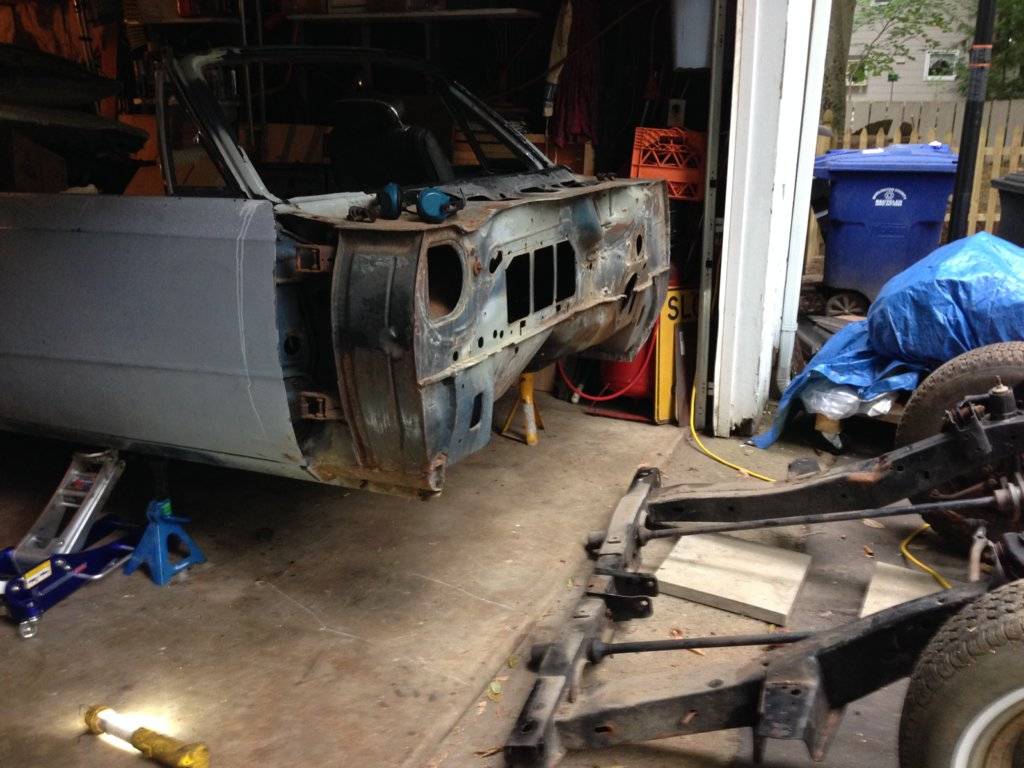

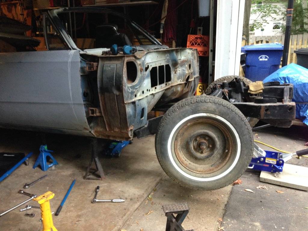

Next, I suported the frame and the body in order to loosen the stub frame bolts. No matter how many jack stands and jacks I have holding up a car, I always say a prayer before crawling under, especially while working alone:
Free at last!
There is also a small crack along one of the bends in the damaged part of the frame. I will make an attempt to straighten it just for fun, but I think this one is going to scrap:
Hello dolly!
Like a baby in its cradle:

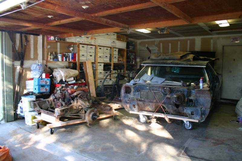

I just bolted a board with casters to the body and made a simple cart for the stub frame.
Amen to that. I always use THREE jacks at a time even though I may just have to lift only the front end. Sometimes while I'm under there (more than half way!) I think about how utterly crushed I would be if this car fell......I have to try really hard to force myself to focus back on the job at hand,lol.

Hello dolly!
What I did was jack the car up with the frame attached then pushed my stub frame cart in and lowered the car back down.
The frame was then unbolted from the body. Now free the body was jacked up and jack stands put under.
The stub frame could now be rolled out, the body was then transfered to the board with casters on it.
Alan
Yes, I did over-engineer it a bit with all of the wood and four casters rated at 350 lbs each, but I wanted the car to rest 18 inches so I could roll under as it sits and to be able to lift it up at the center of the dolly with the jack if I wanted.
