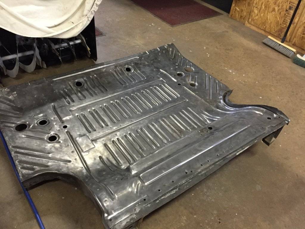

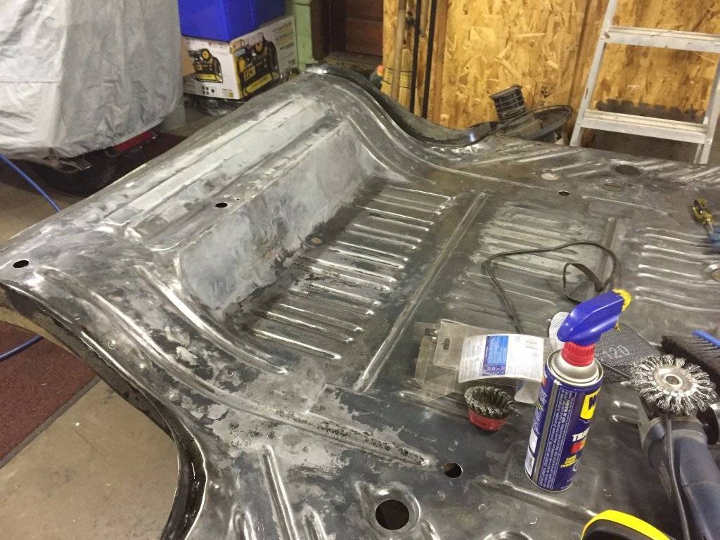

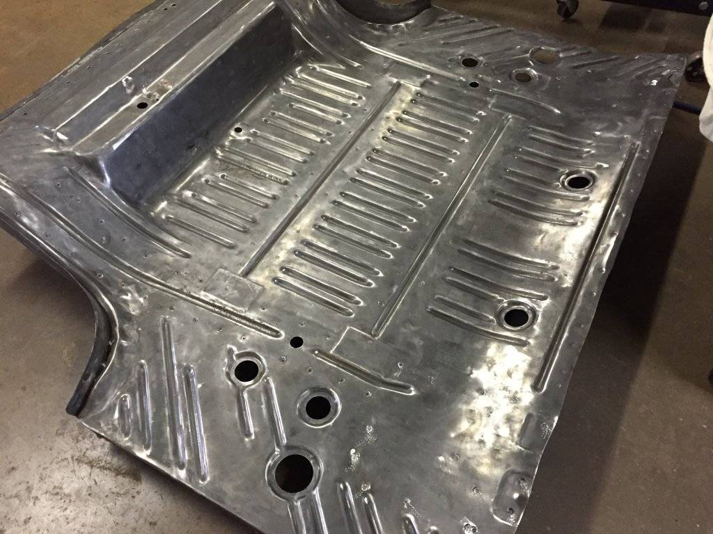

I gave up on trying to save the rear hump of the trunk floor coming over the rear axle and took a road trip to get the new to me trunk floor which I have been busy this past weekend cleaning up.

ok here's some pictures!

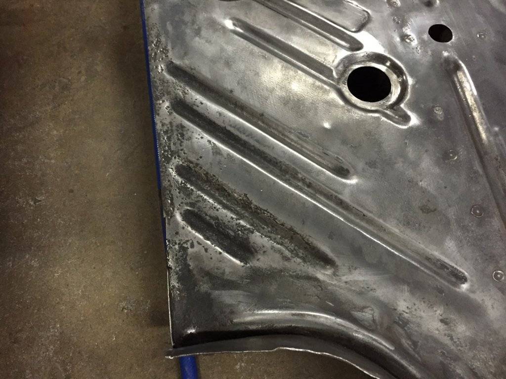

The one shows the worst pitting but no rust through..

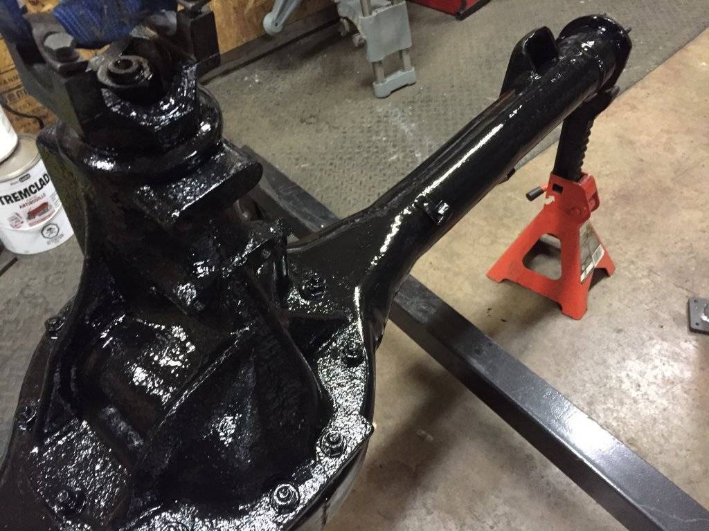

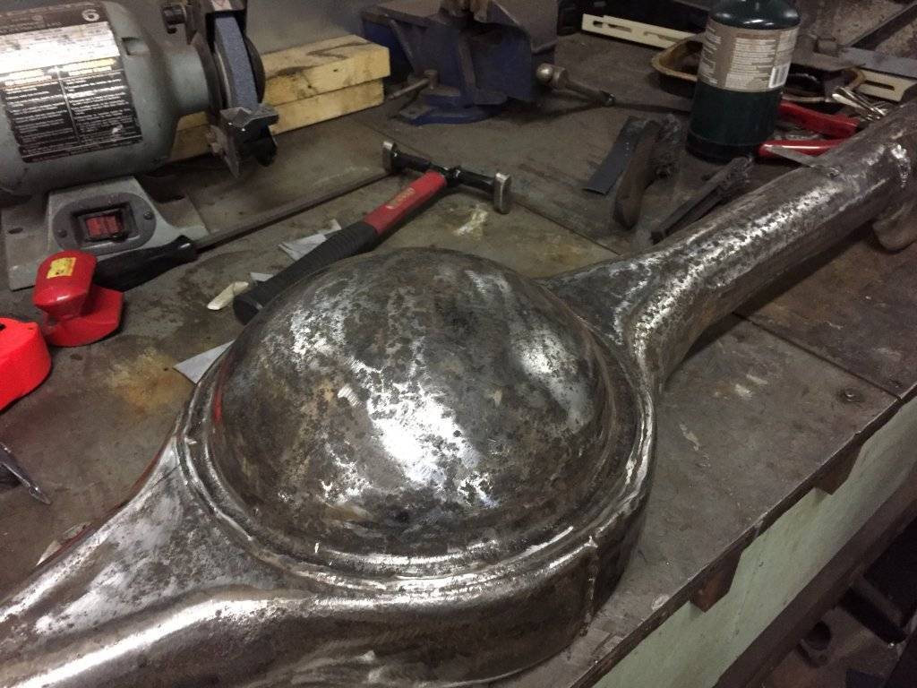

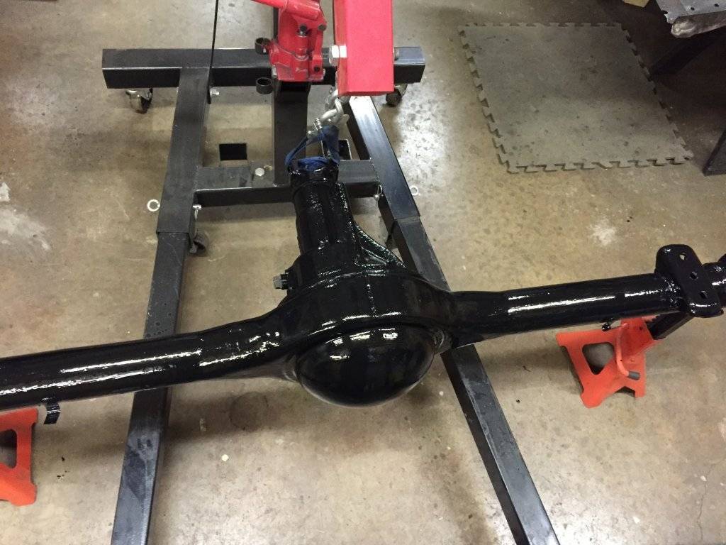

I decided to take a bit of a break from the body work and started in on the cleaning up and resealing of the differential the past few days

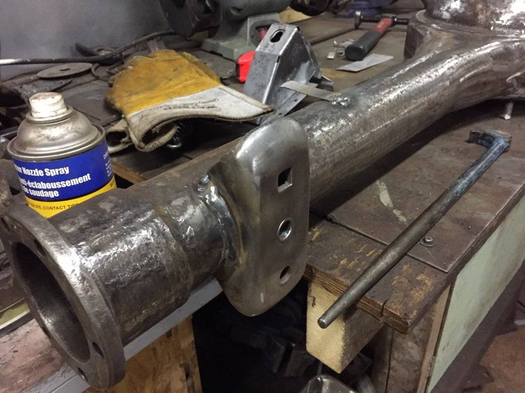

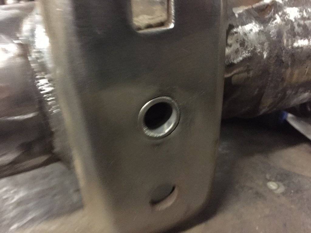

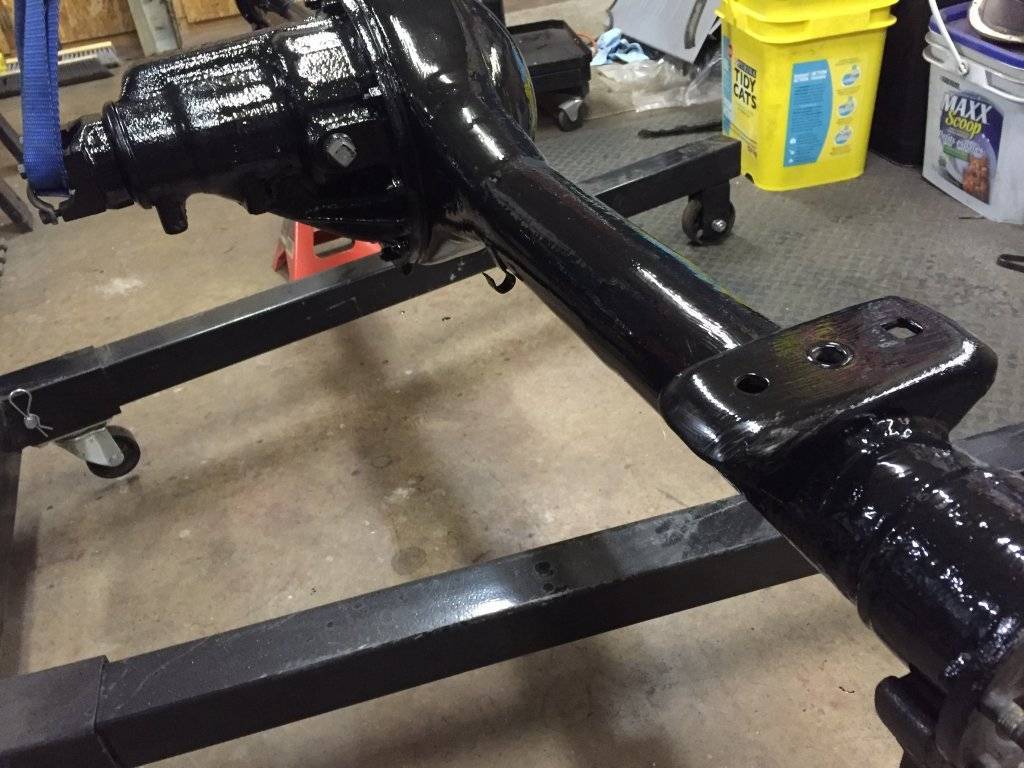

I also had the new spring perches welded up at work.
The main concern I had was that the center spring bolt holes were larger than the factory size and fortunately we have a great machine shop that made a pair of sleeves to tighten the hole up
Overall considering I used a wire wheel and some good ole' elbow grease this is turned out rather nicely..

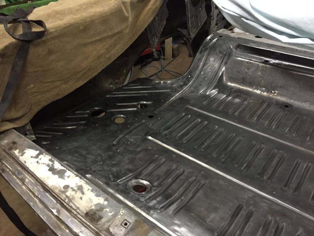

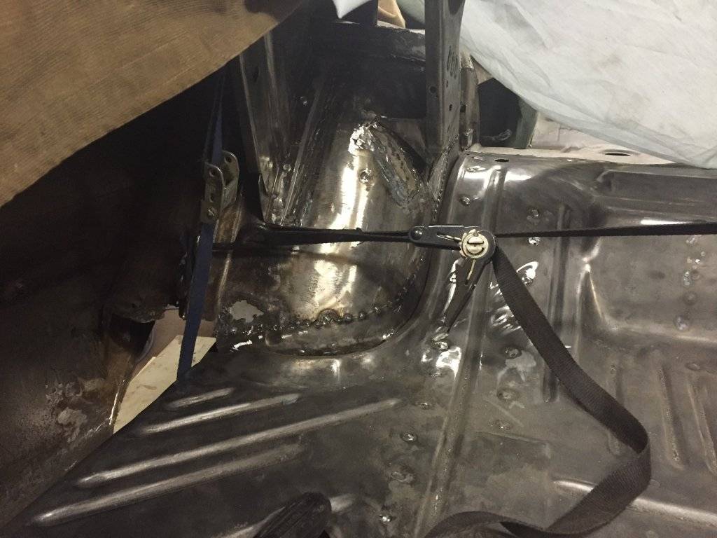

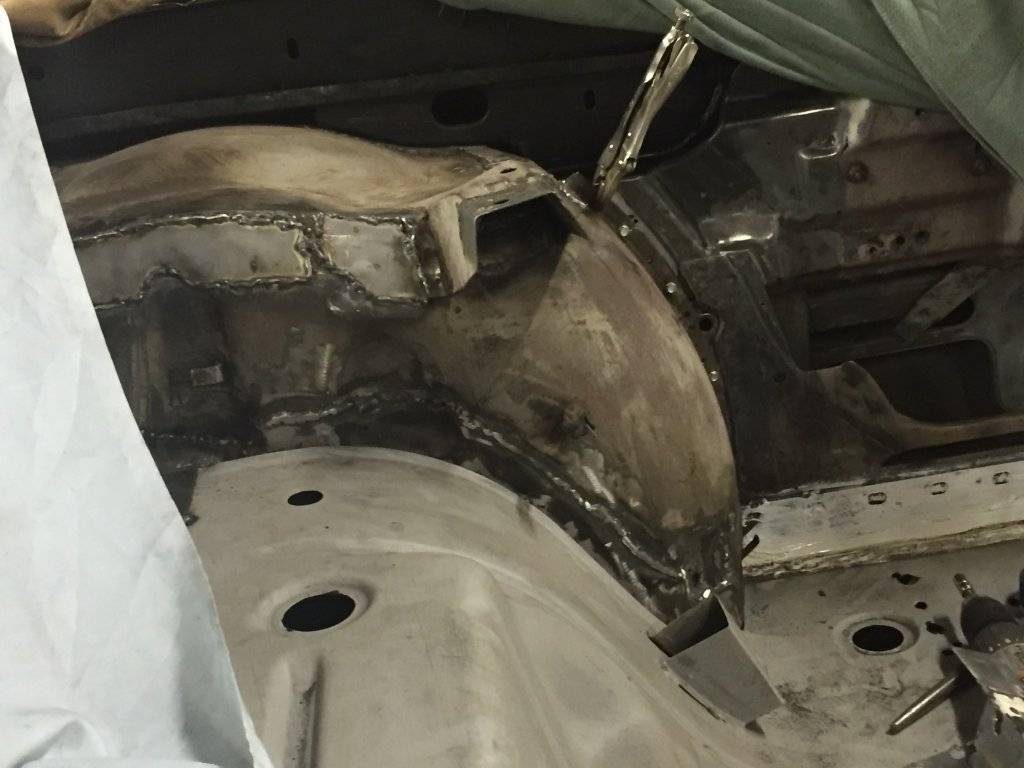

I shoe horned the trunk pan into place tonight. I had to drop the wheel wells out in order to do that.
I am totally blown away how the spot welds line up for most of the frame work.
This pan came from a 66 Polara 4dr in NC and the rear frame rail out of a 65 FURY 2dr in Arizona!

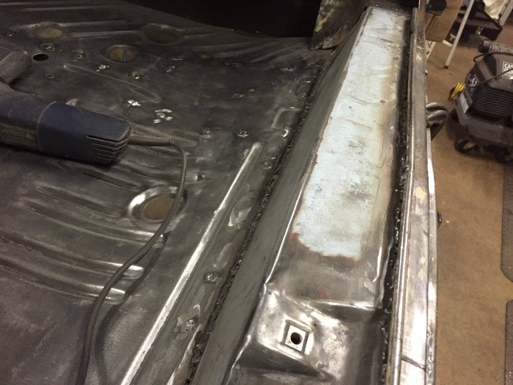

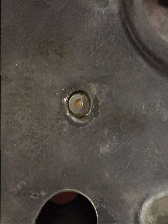

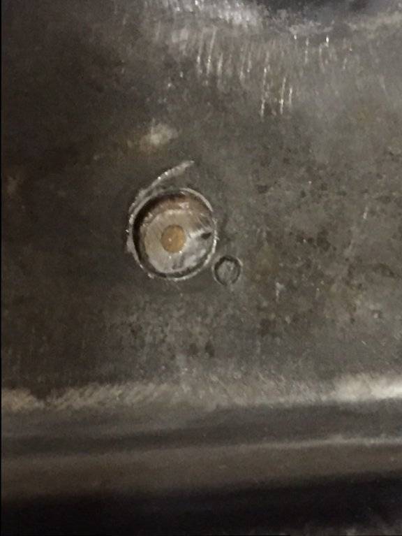

looks great. curious if you are spot welding the perimeter and across the braces or if it is all bonded?
I ended up spot welding this into place since I had to pull the frame into alignment with the body 1/2".
I didn't want to take any chances on the glue coming loose even with 3M claiming it never will
I have a bunch of other pieces to glue in though

I started in on reinstalling the wheel wells this morning
They are still a bit Frankenstienish looking but functional
