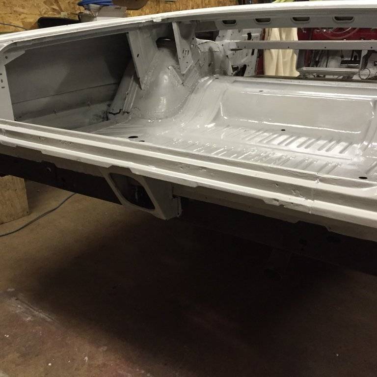

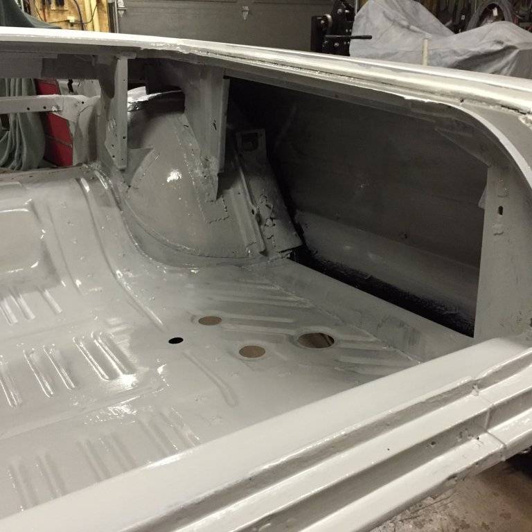

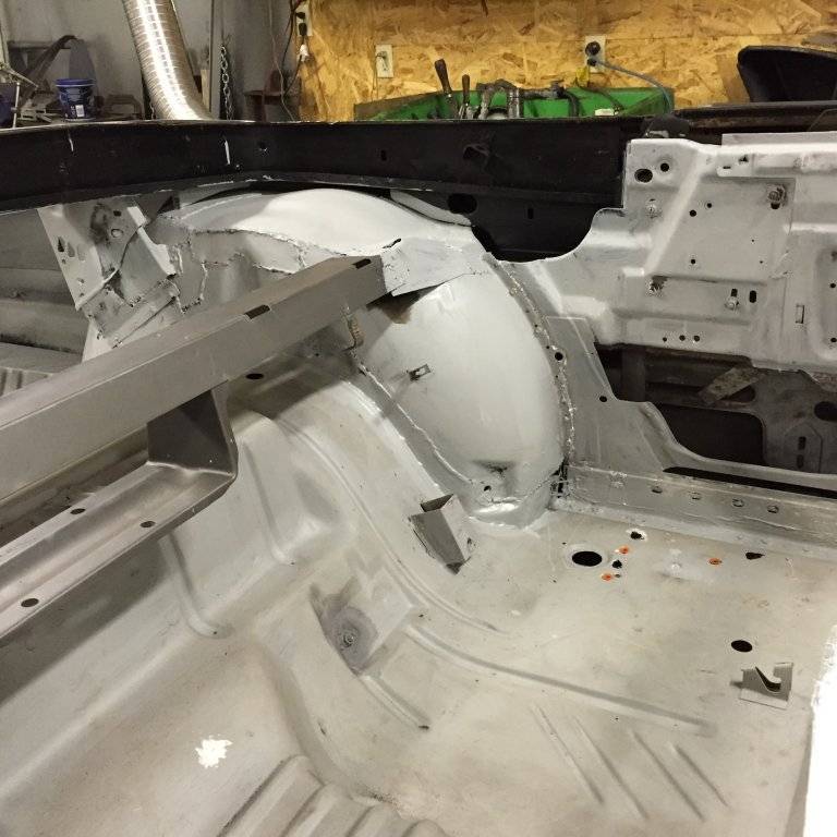

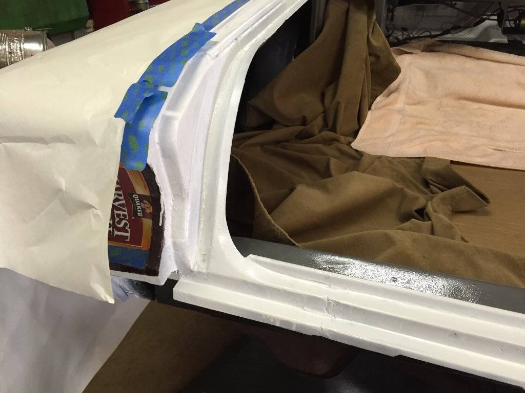

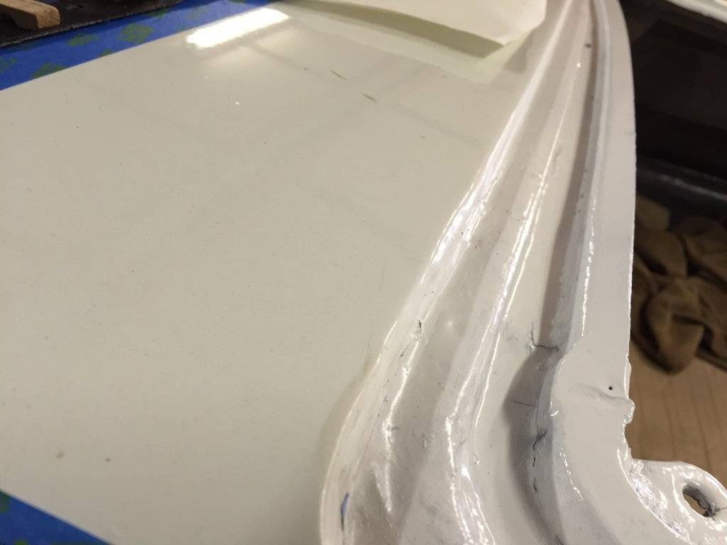

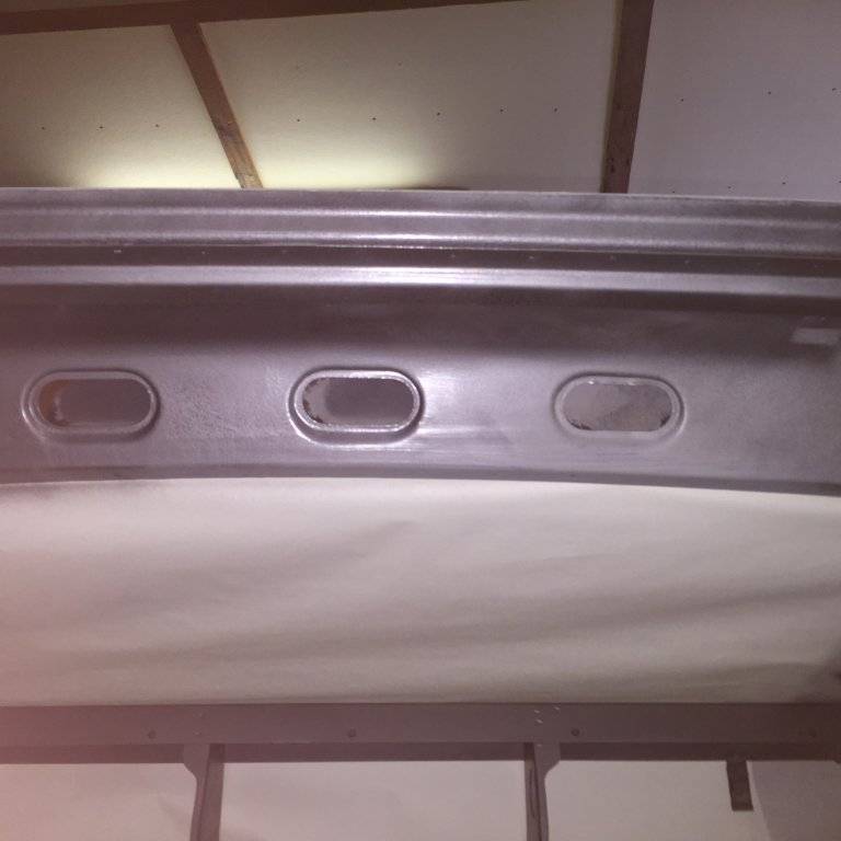

it was paint the trunk and rear panel time tonight!
I hit it with some high build primer and once it dries apply some body filler to pretty it up.
Apply some sound deadener then spatter paint.

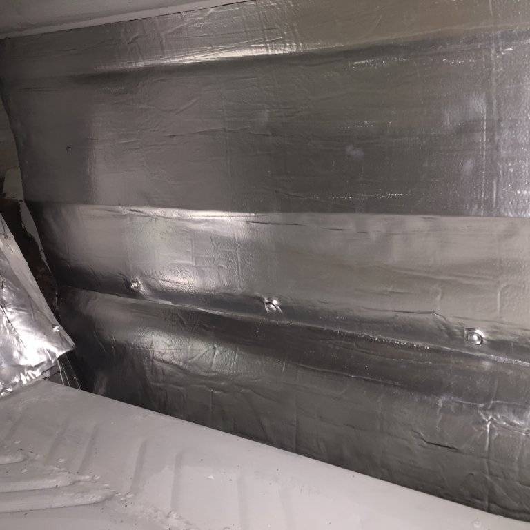

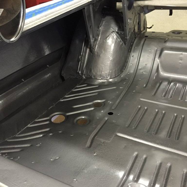

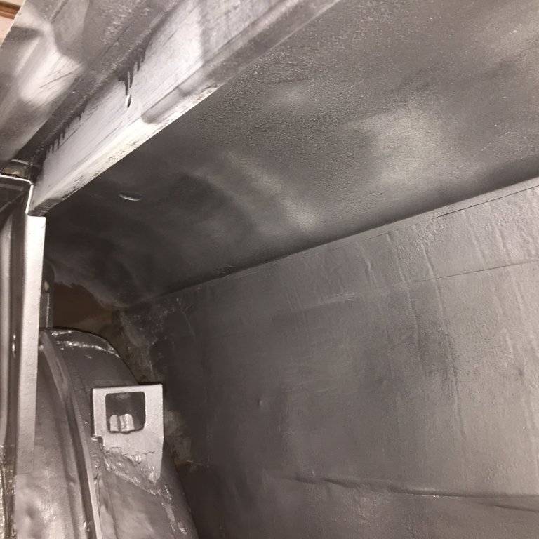

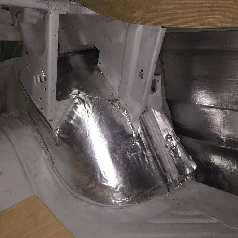

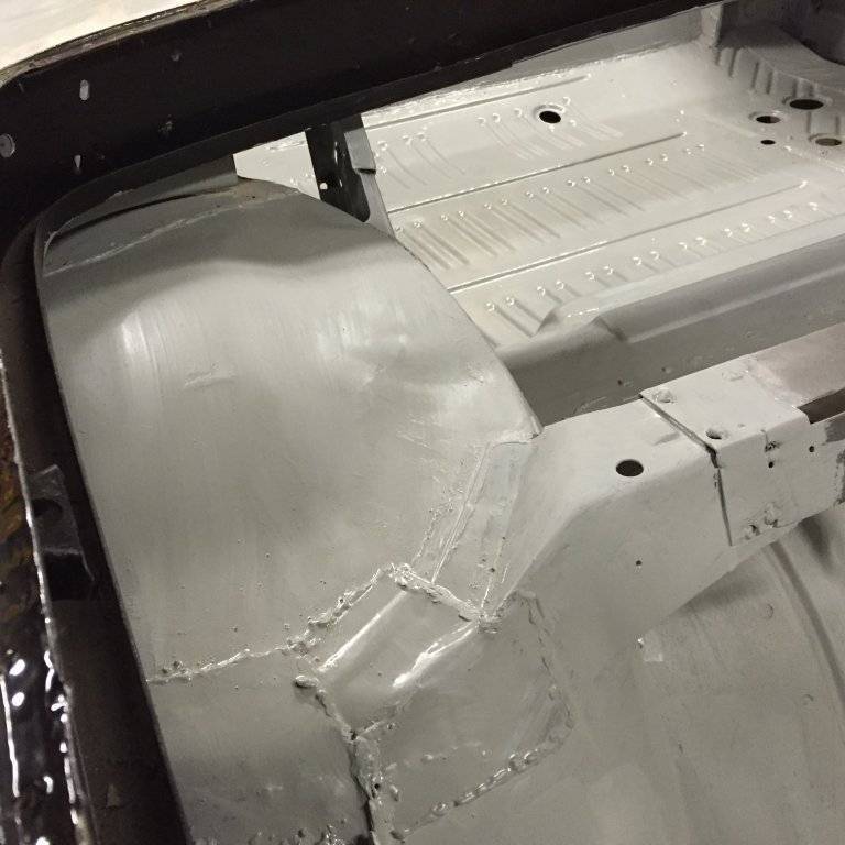

I got a chance to cover the right wheel well & Q panel with the GT Mat sound deadener this afternoon.

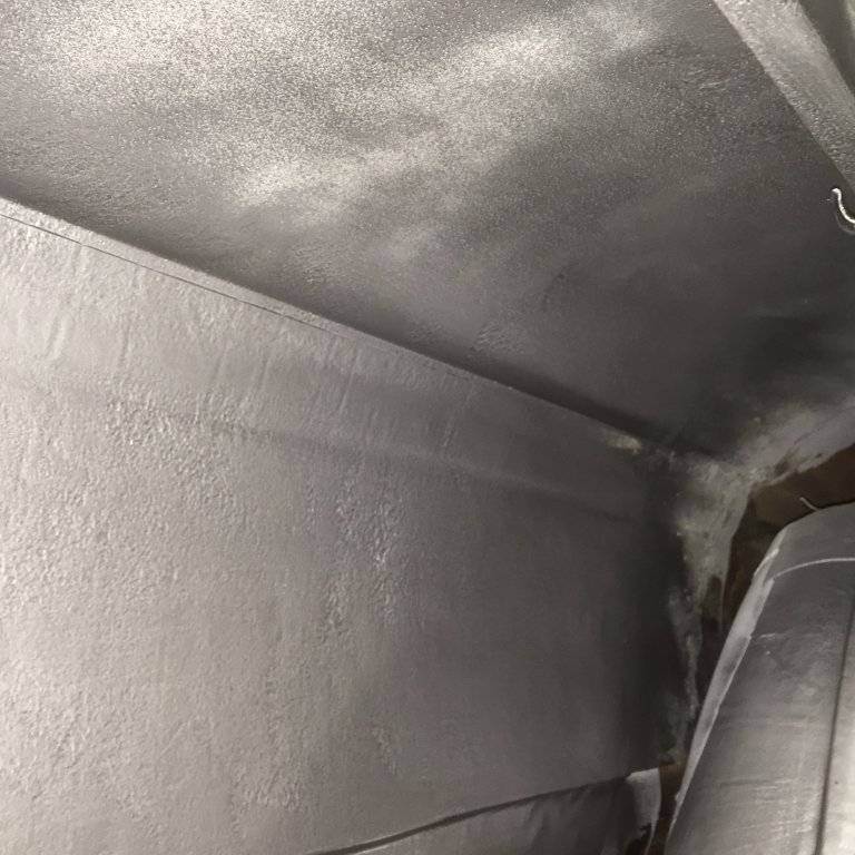

Once I'm done applying the deadener I will hit the seams & trunk floor with the truck bed liner spray then give it a colour shot to finish the trunk area off

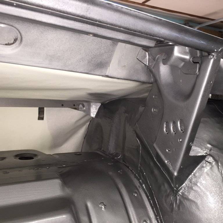

I applied the final colour coat in the trunk this morning
I decided to apply the Rust-o-leum Hammered Gray which turned out real nice and applied nicely overthe GT Mat sound deadener well too.

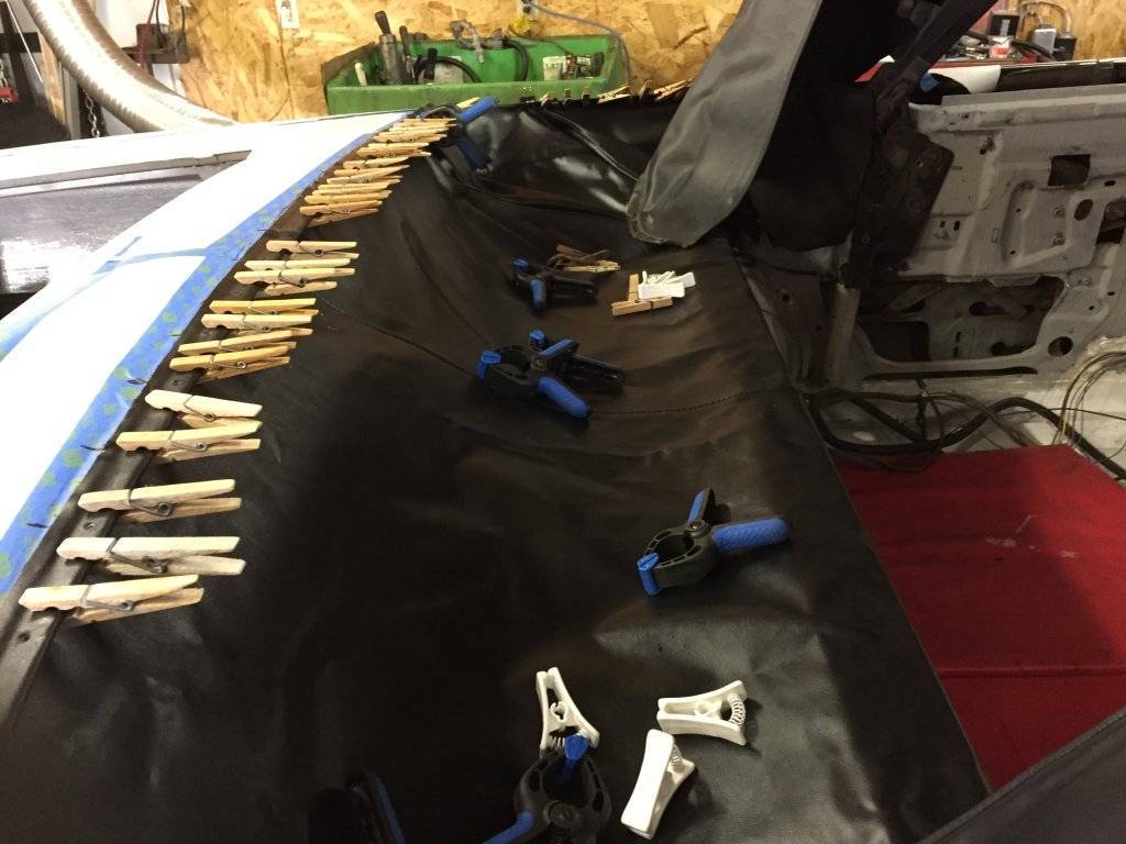

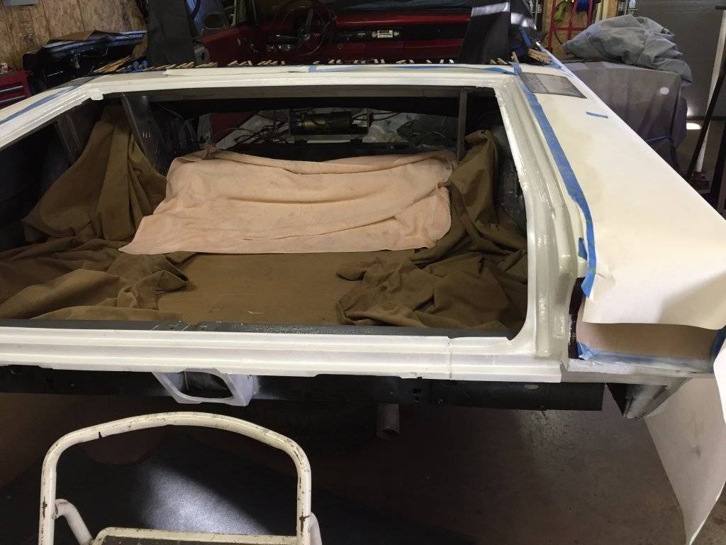

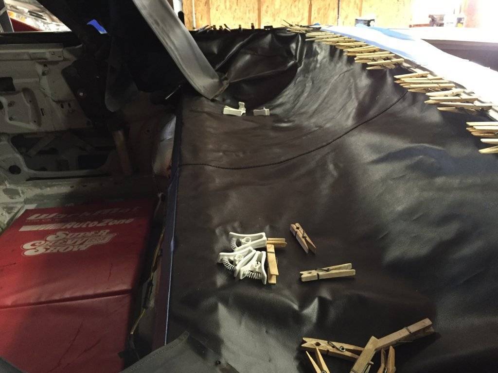

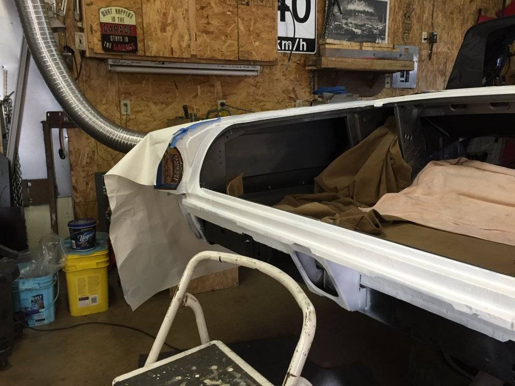

I got the well liner installed today and installed the soft top and did some painting on the back of the car.
I think the paint matched up pretty good considering it came out of a rattle can...
The areas I painted will not show with the trunk lid closed and the bumper will hide the rear of the painted area too. :)

Finally... a good use for those old clothes pins...
