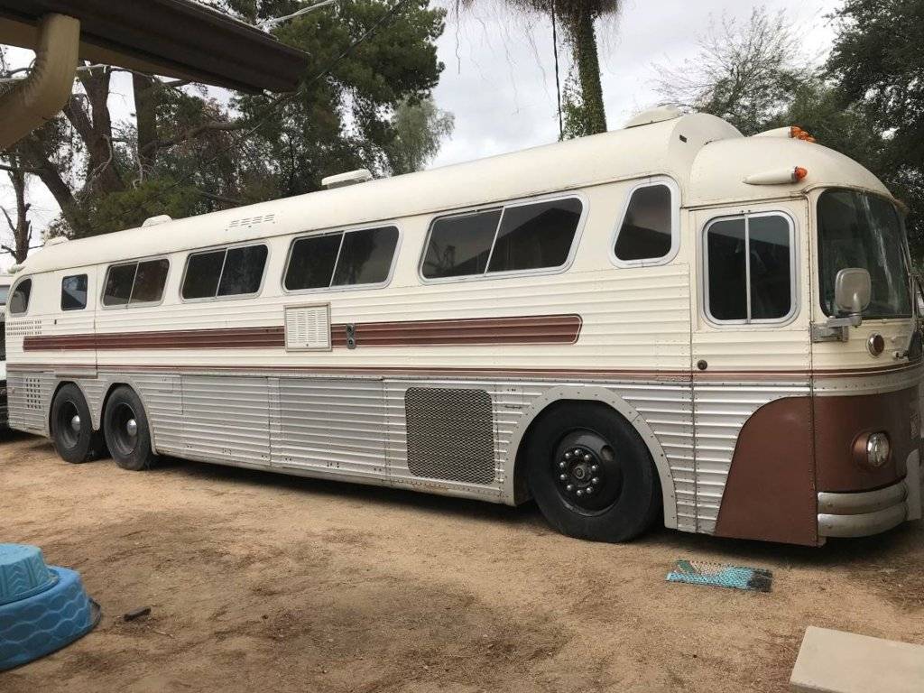

A bit of help: Goal to get this B.O.B (Big Ole Boy)off his airbags and on the road (not to Michigan but to get around locally in AZ).

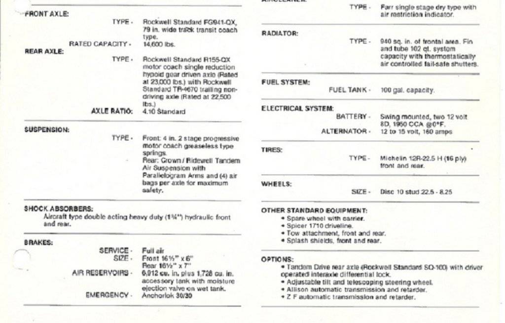

Need 10 tires, 12R 22.5 H or the equivalent. Can i get them good and used? If so, or if not, how mucn per tire is reasonable?
Need two "8D" 1950 CCA Batteries. Again, used options? If so, or not, how much per battery is reasonable?

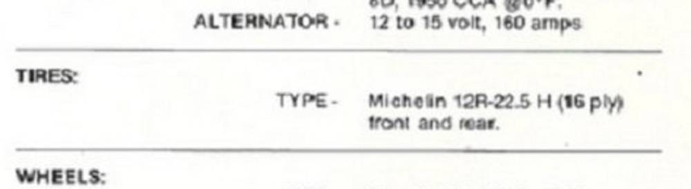

i got the all-position idea from the spec in post #902. doesnt mention steer vs drive, OR its assumed operator would know the difference?

Do you have to run 12R 22.5
11R 22.5 is much more common and most likely cheaper. Can also come in a 16 play rating.
