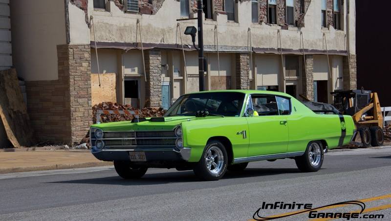

OP you might want to check your hood seals etc. It won't help anything at a dead stop but once you start moving it will.
Some cars don't cool well, some do. My Fury has zero hood seals, no shroud, and a little 4 blade fan. I drive the piss out of it, never goes over 190, even in the floriduh heat.

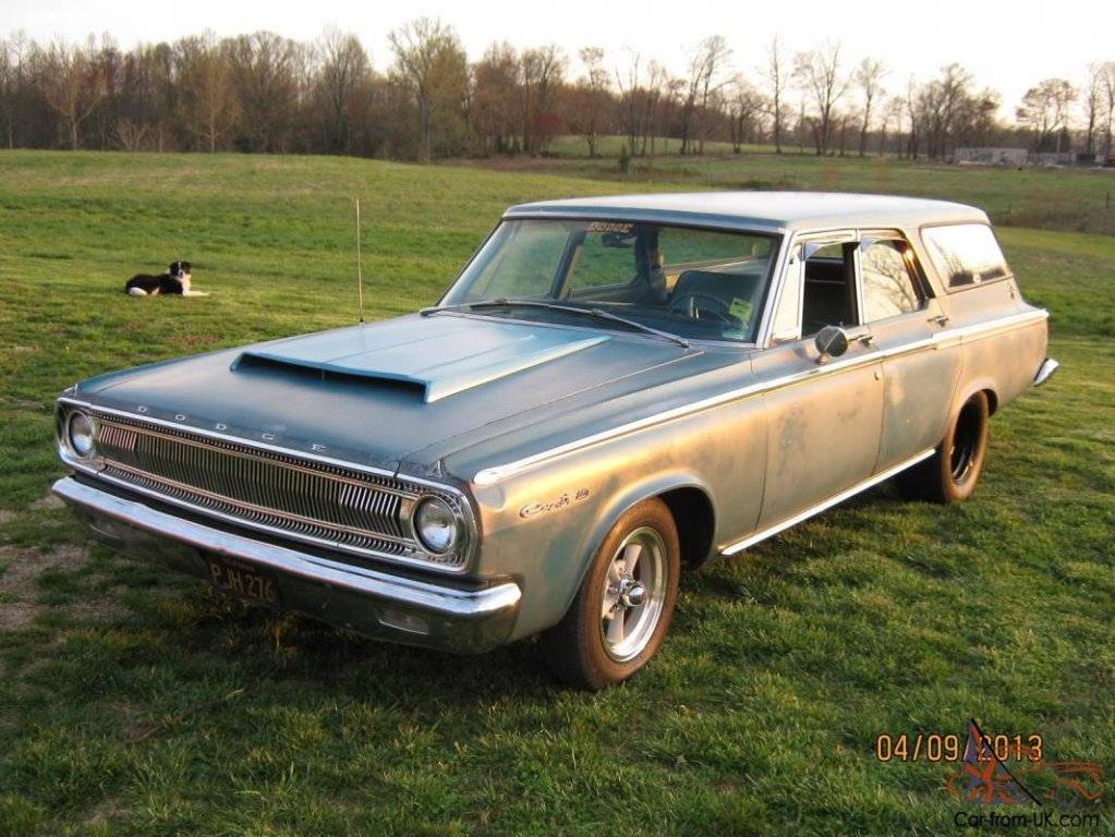

On the topic of hood scoops, I seriously considered putting a hemi scoop on mine for clearance. The effort of putting a fiberglass scoop on a metal hood and have a nice sealing line must be hard, there seems to be a lot of botched jobs.
I am looking to get some more air into the Engine compartment and to vent some hot air out when idling. I am not too thrilled with a scoop but what other way would there be? Anything more subtl?
Take the hood off.
I put a 68 Hemi super stock scoop on my Barracuda. The car is not painted yet and it is never going to be "molded or glassed in" I think the 65 & 67 scoops look good because not as look at me and they are not originally molded to the hood like a 6 pack scoop was and when the 6pack one is bolted on it doesn't quite look right.
Also on scoops you can't buy those super cheap plastic ones off eBay, just go to Home Depot and buy a plastic mortor mixing tub and cut it in half at least you won't spend as much. You have to buy one in fiberglass and from a good dealer$$$
The problem is you have two different materials that grow and shrink with heat and cold at vastly different rates. The hood gets hot from the engine and the sun, the steel grows faster than the fiberglass and it cracks.
