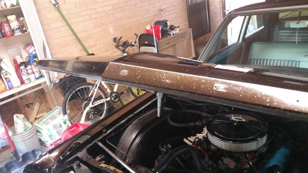

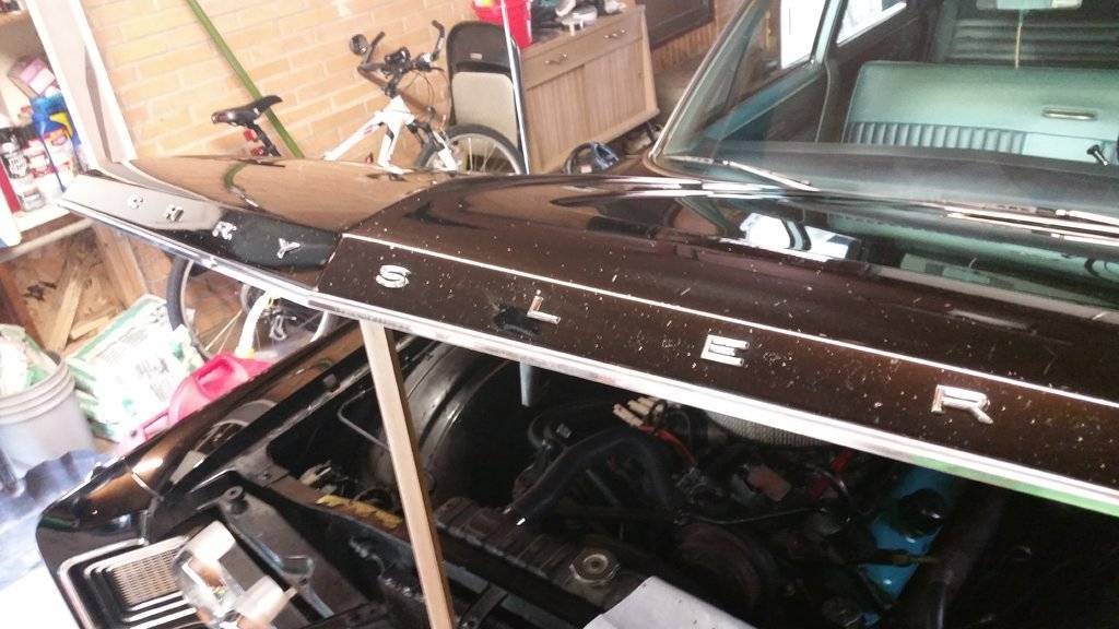

Scuff the chrome & use etching primer. Then any paint should work.Got all the emblems and trim pulled off the hood lip. Gonna fill it in with bondo and paint it. Gonna go for the shaved look. Might black out the whole thing eventually...what's good to paint over chrome? View attachment 133285
